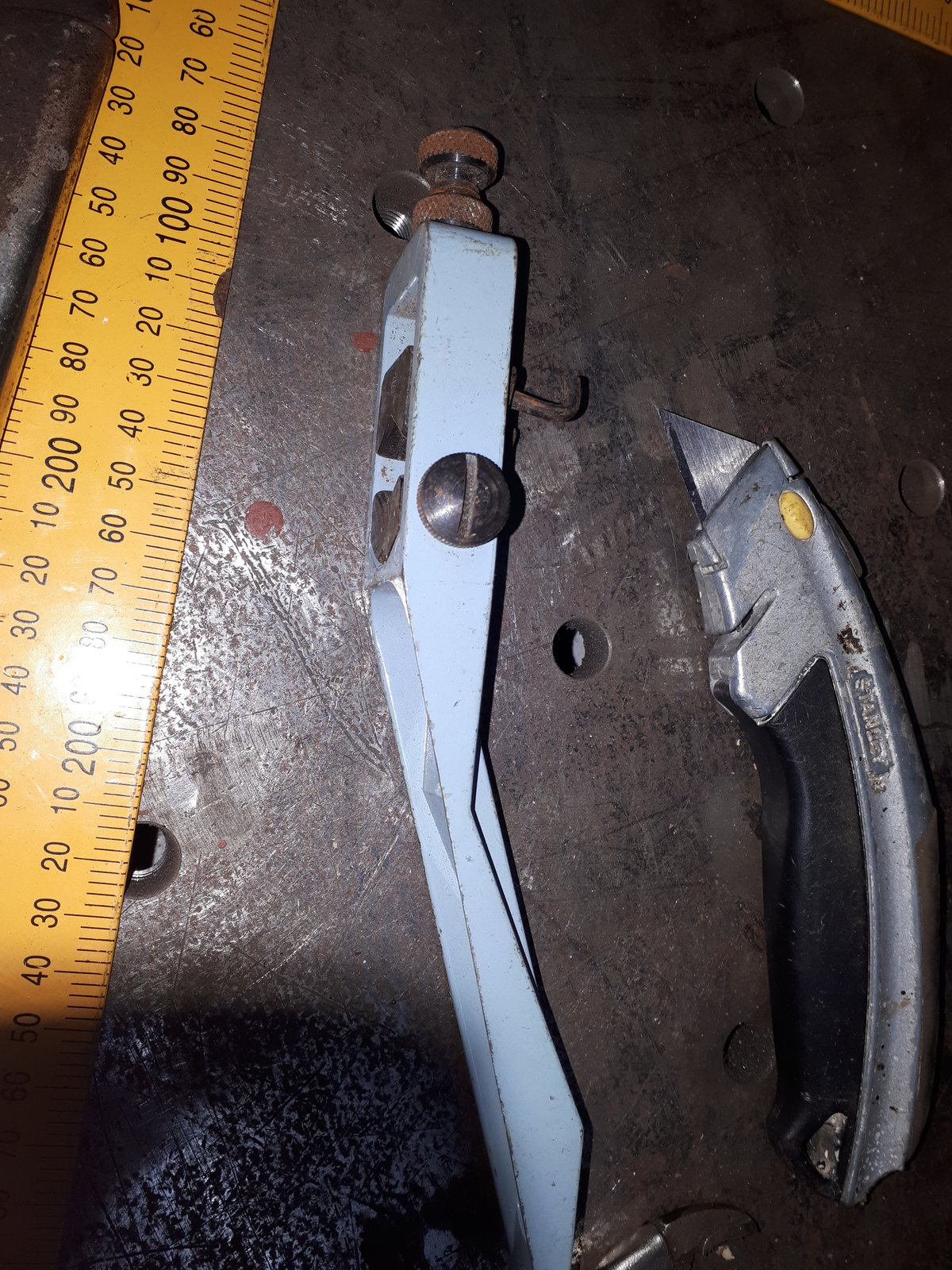

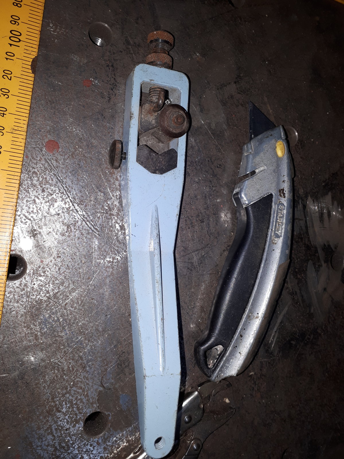

i have one somewhere . it strips the copper coating of the cores that are insulated with magnesiumGo on, give us a clue?as windy miller its a pyro cable stripping tooli have one somewhere
mineral insulated cable . it has hard drawn copper conductors magnesium insulation and a copper sheath generaly coated with orange pvc insulation used on fire alarms and in an explosive environment and is fireproof https://en.wikipedia.org/wiki/Mineral-insulated_copper-clad_cableGo on, give us a clue?
Ahhh, that clears that up, no wonder I've never heard of one.mineral insulated cable . it has hard drawn copper conductors magnesium insulation and a copper sheath generaly coated with orange pvc insulation used on fire alarms and in an explosive environment and is fireproof
That is what the wiring in my house is, PITA especially as it is imperial.mineral insulated cable . it has hard drawn copper conductors magnesium insulation and a copper sheath generaly coated with orange pvc insulation used on fire alarms and in an explosive environment and is fireproof https://en.wikipedia.org/wiki/Mineral-insulated_copper-clad_cable

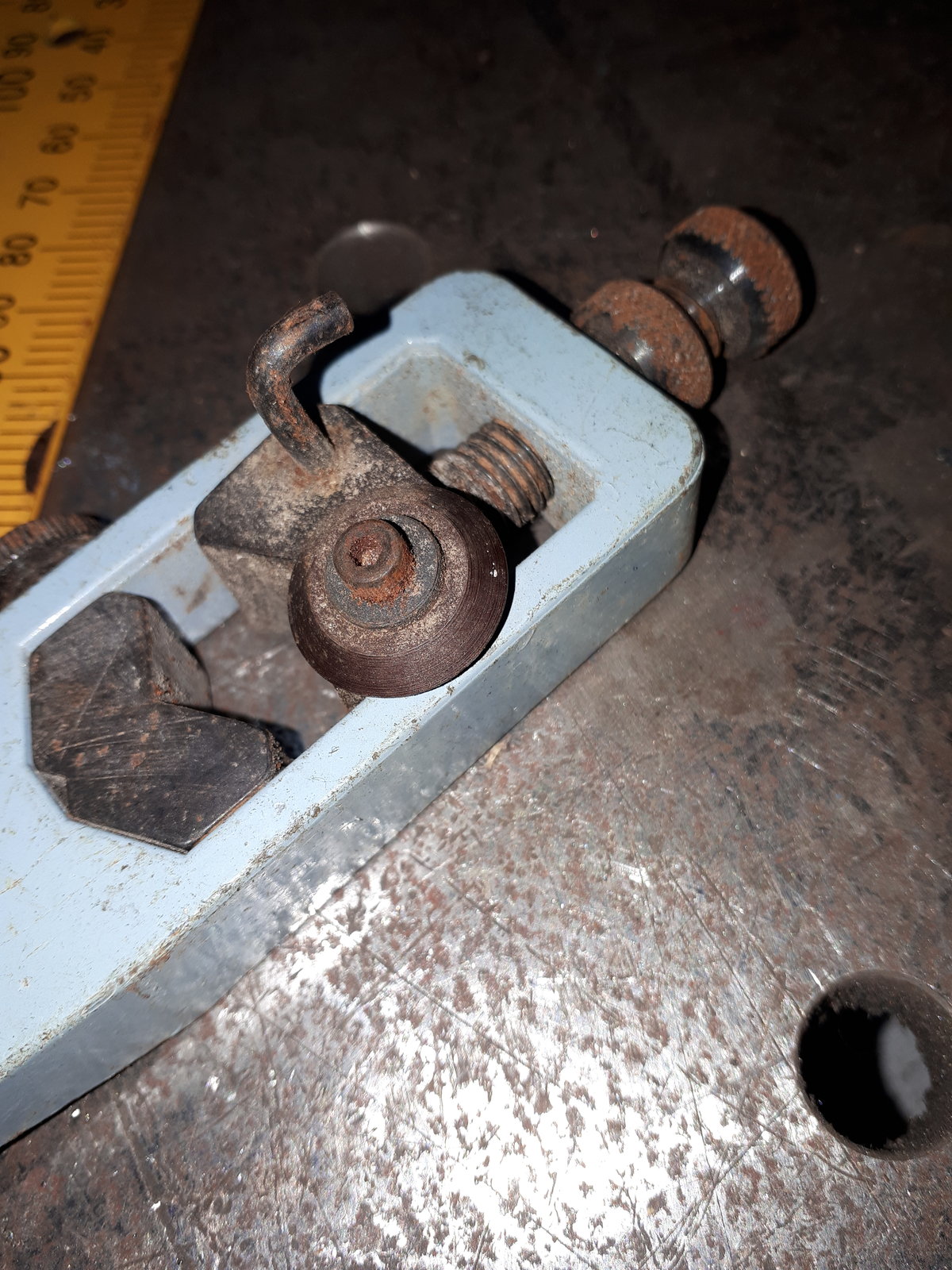

It's to draw the stripped copper away and stop it slashing your wrists / face, doesn't do a very good job in my experience!what is the little hook thingy for ? im just wondering if i can repurpose it for anything
...magnesium insulation...
No, didn't know that but will have a search, not that I plan on doing any more@Hood don't know if you know this but there's a chart on the net somewhere that tells you what metric pots, seals & glands fit the old imperial stuff, I had to do a lot in a school once, spent 4 weeks re routing supplies![]()
No idea but I will keep it just in case
So have I. Why DO we keep these things? I've got the little potting crimp thing as well somewhere.been 35 years since i used one....still have one somewhere
