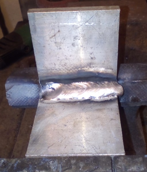

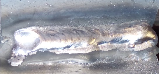

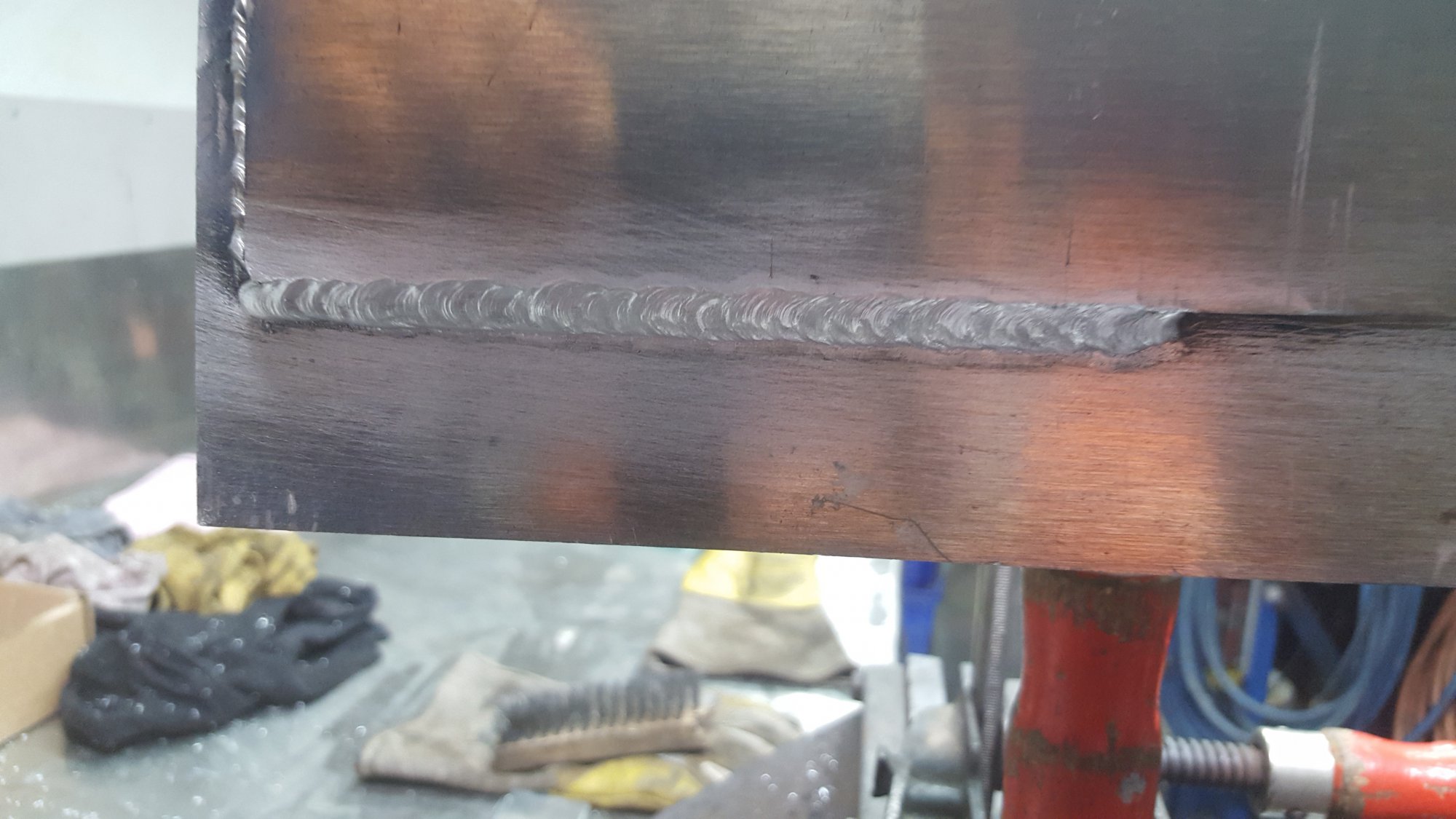

This is what I am talking about, the first pic was when I had the back door shut yesterday so no real airflow in the workshop and soot was minimal. Second pic was with the back door open to cause a through draught as the smoke was building up
As can be seen the weld is clean in both but the soot is much more on the second one, so likely lack of shielding.

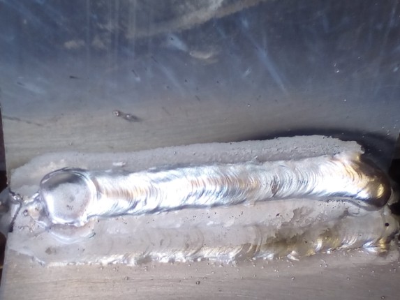

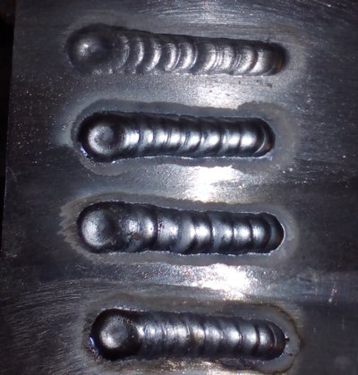

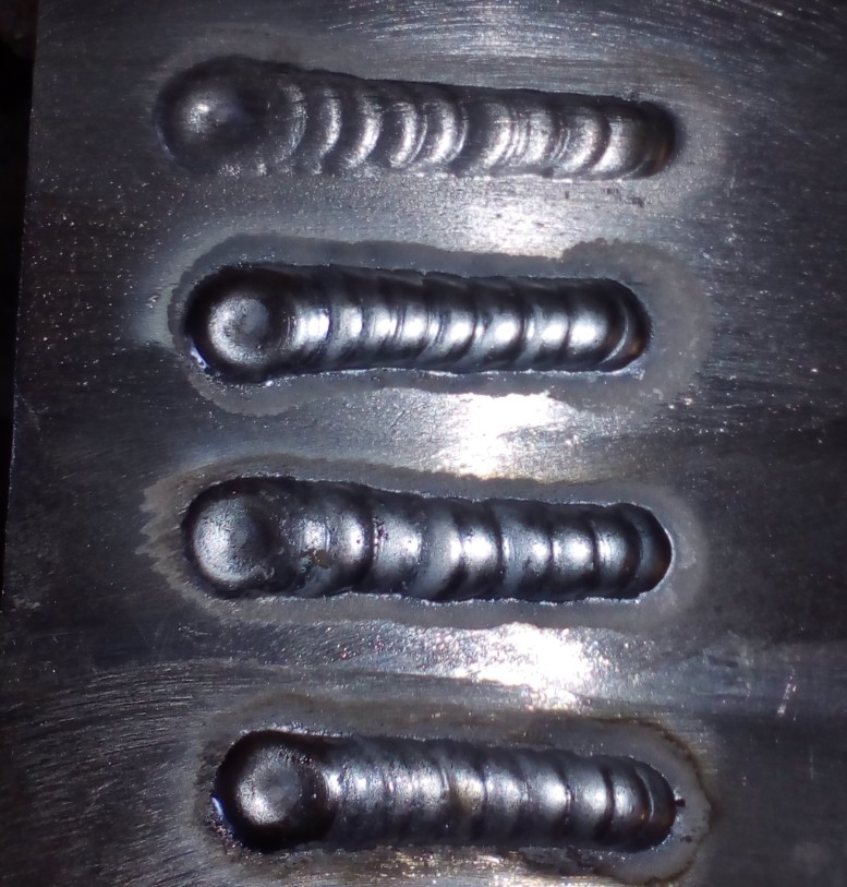

Rarely with Mig will you see the problems on the surface.Ok first test of the day and I do agree light wire brush is best.
First bead is no cleaning, second is wire brush, third is light clean with angle grinder and last is grinding with angle grinder.
Time to move to mig now.
Bottom two are contaminated. Worst been the very bottom. Even the etched zone looks dirty.Ok first test of the day and I do agree light wire brush is best.
No you wouldn't mate. It's not a run I'd ever let go any further than the bench then the bin. Nothing is more of an eye sore than a scabby Alu Tig weld imo.I'd be happy if I could produce a run like that......![]()

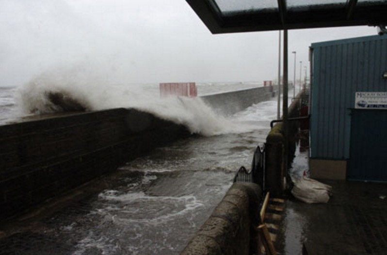

I never have clean stock LOL, I am about 10ft away from the sea. Here is a pic of the road outside my workshop taken on a stormy day.Rarely with Mig will you see the problems on the surface.
Unless your getting heavy porosity
I don't use a wire brush even if my stock is clean or new. No need a quick wipe to remove dust/finger prints and away you go.
A lot of what I do requires a good surface appearance and scuffs from brushing would not be acceptable.
Ha ha yes I see half the issue.I never have clean stock LOL, I am about 10ft away from the sea. Here is a pic of the road outside my workshop taken on a stormy day.

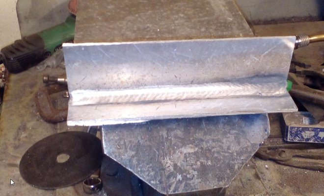

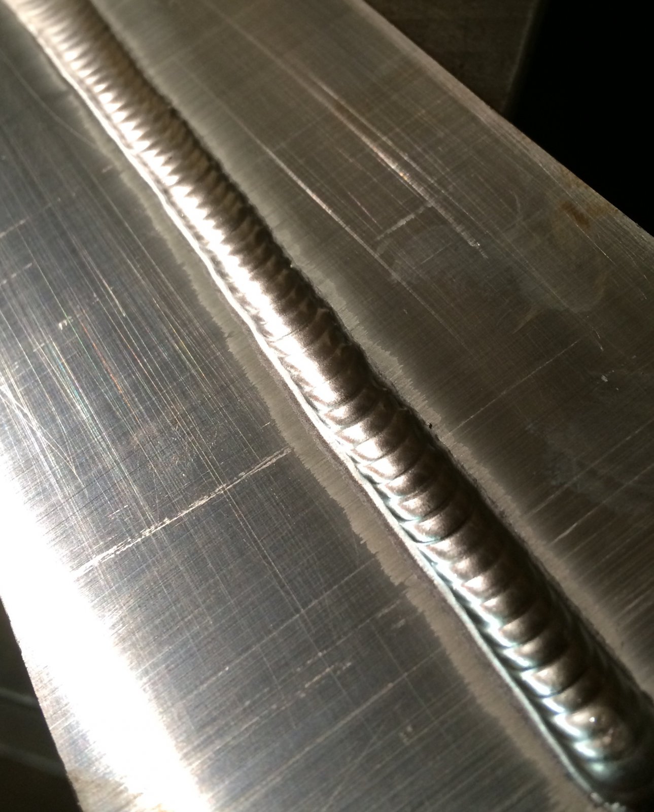

Nope never tried that.Has anyone tried the plastic bristle brushes in an angle grinder? all I do is run one of these down the weld area, degrease, then weld using push MIG, clean welds and a lot less faffing about.

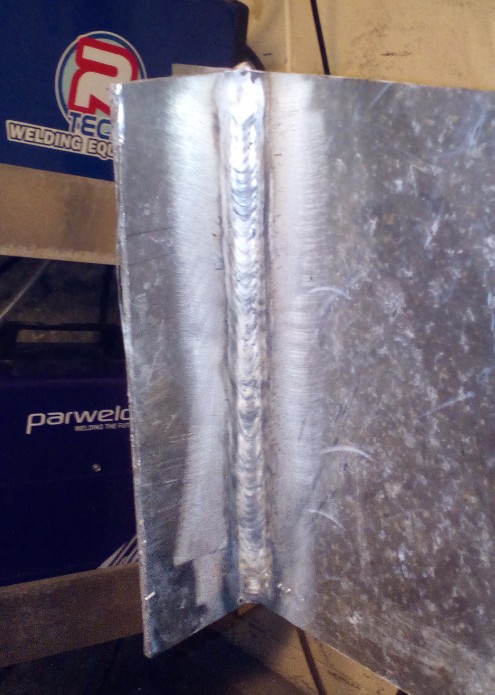

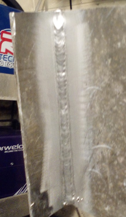

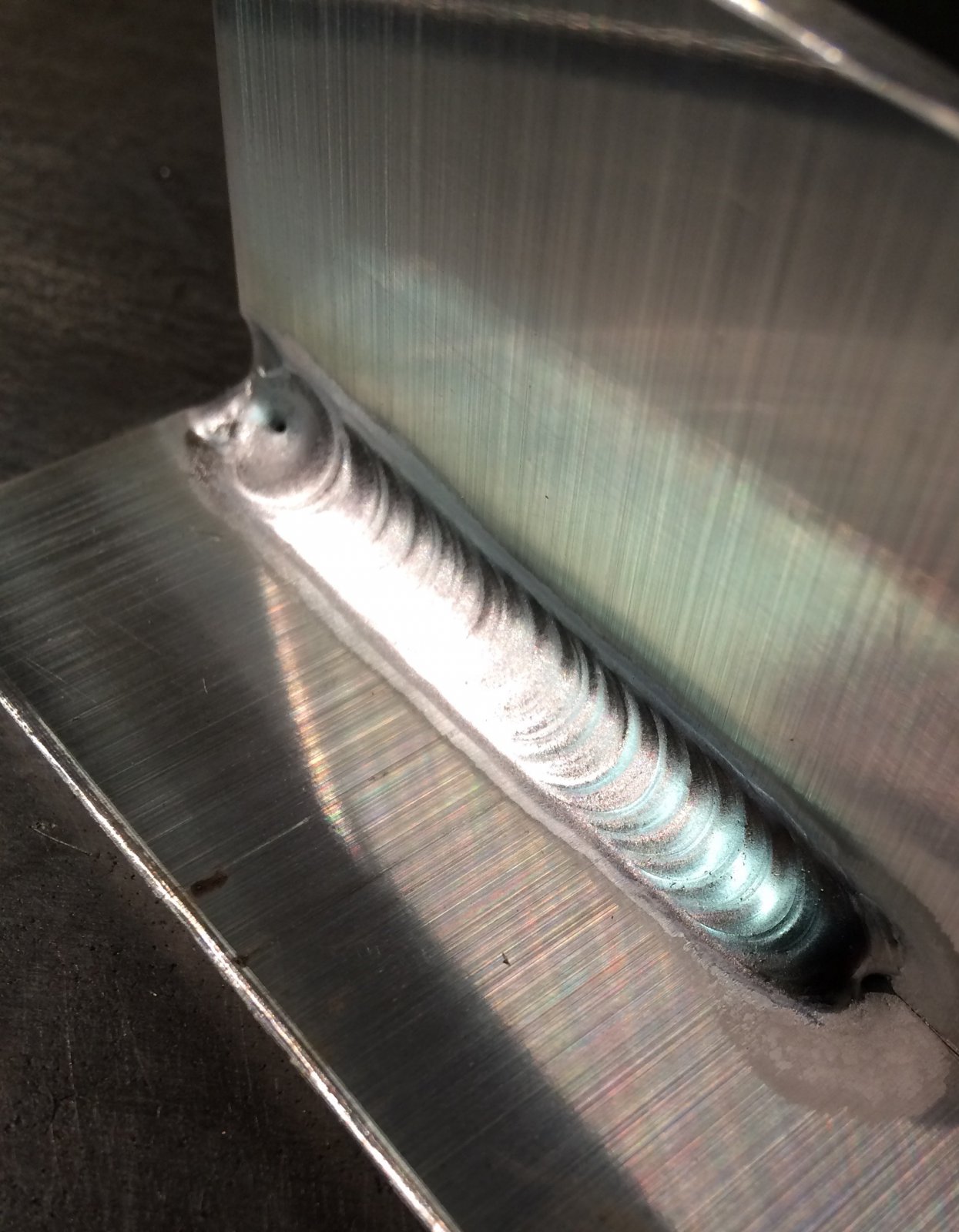

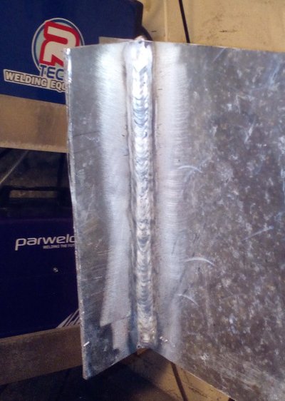

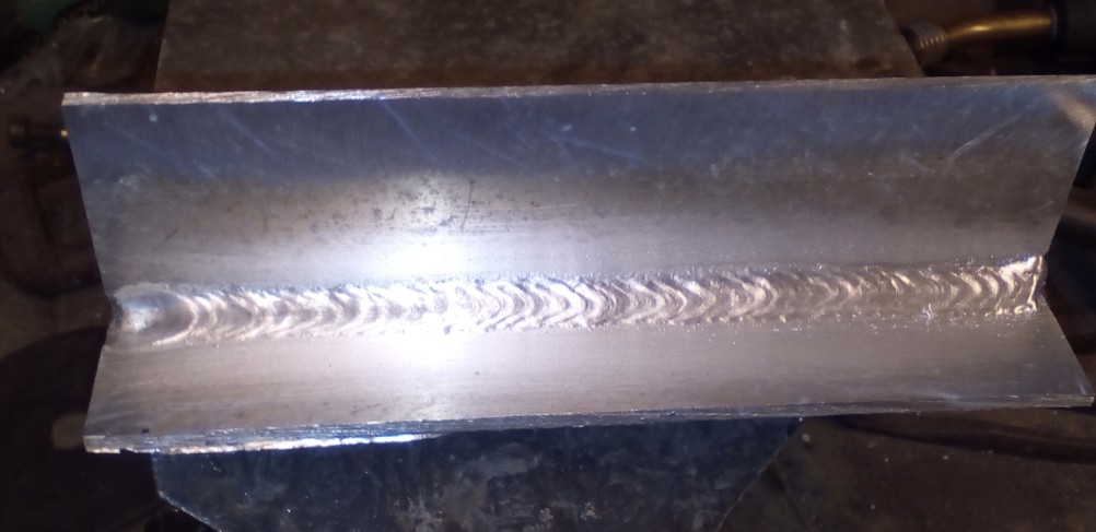

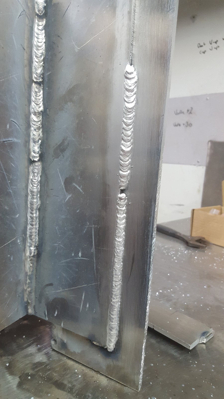

That first fillet looks a cracker hood.Ok thanks for that, just been doing a couple more tests myself and I have discovered something interesting, well it is interesting to me anyway
First pic 5mm 5083, 1mm 5356 wire, flat position
Second pic after it has been brushed
Third pic same material/wire but vertical up
Fourth after brush.
Now the interesting bit, piece of 6082 with 5356 wire, 1/4 thick so a bit cold on the weld but the soot is 100x worse. The tests I was doing the last day were all 6082, not sure why it would produce more soot than 5083 but it seems to.
