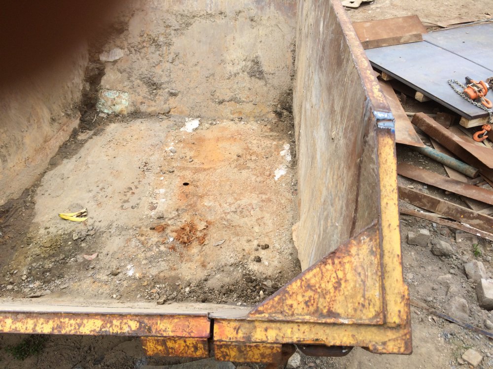

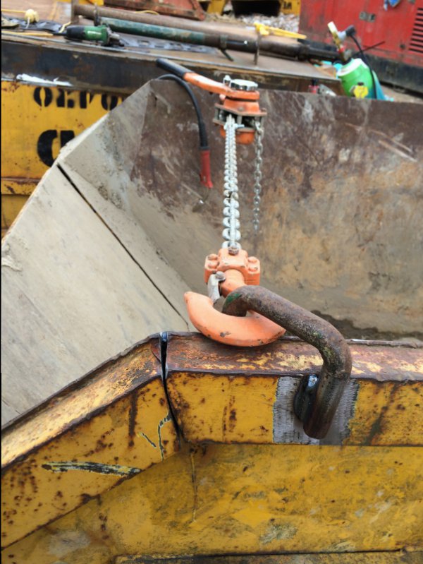

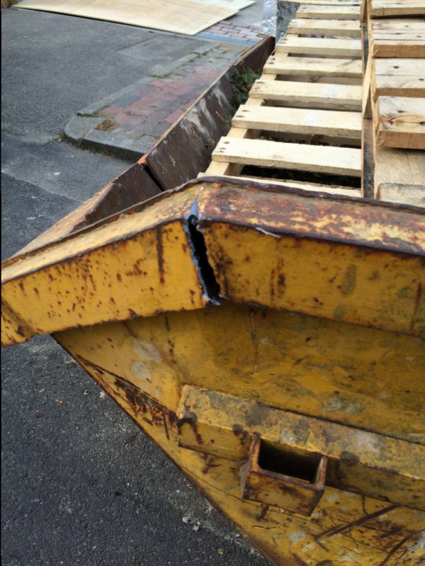

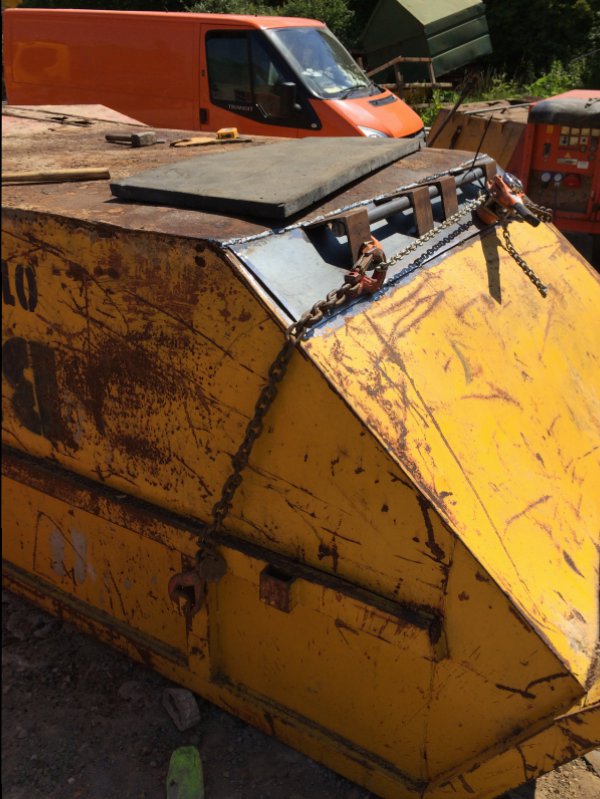

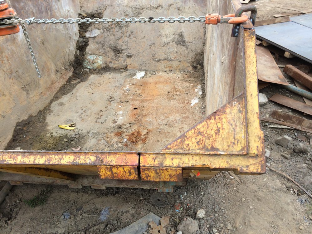

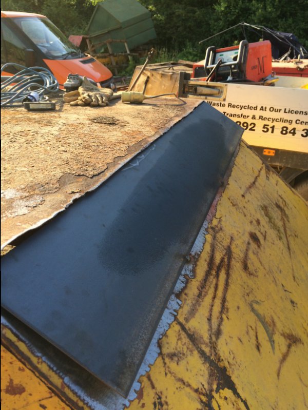

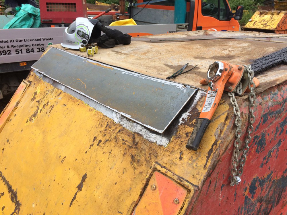

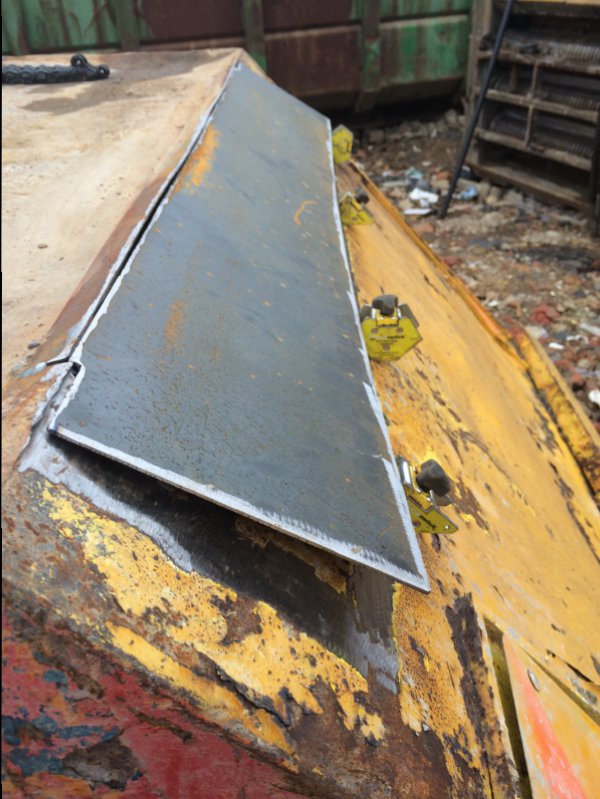

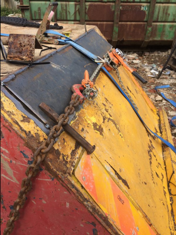

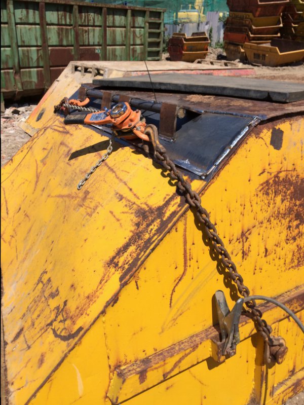

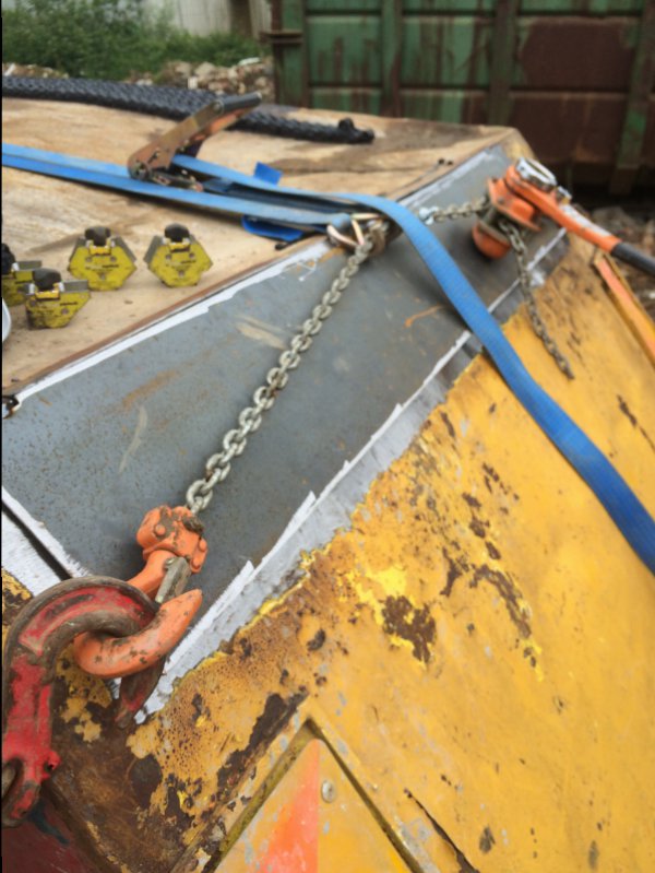

I hope you had good ventilation or a respirator when welding that, the hexavalent chromium it will produce is nasty stuff.

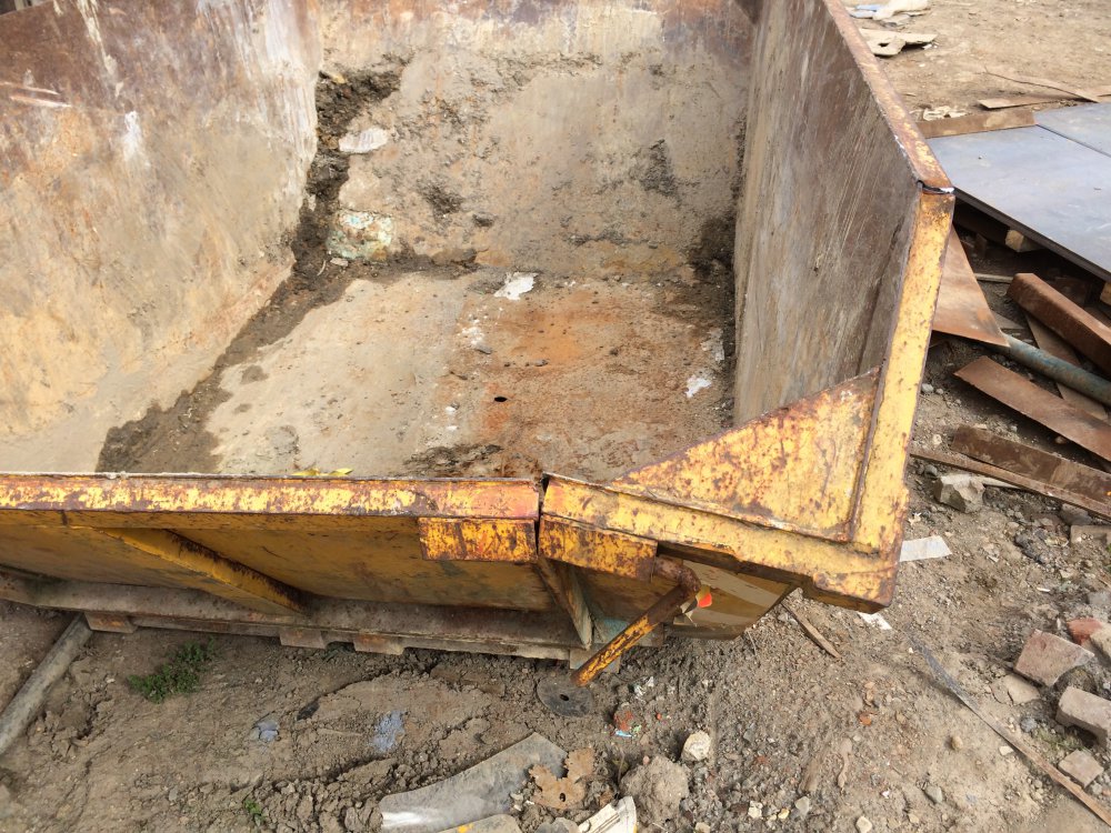

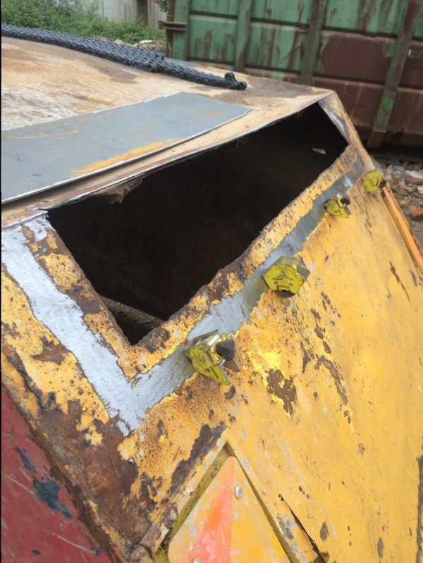

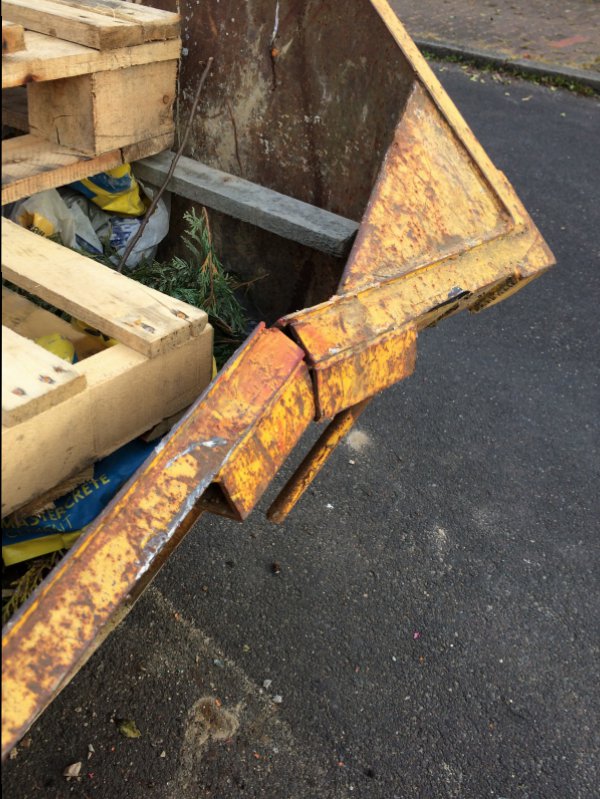

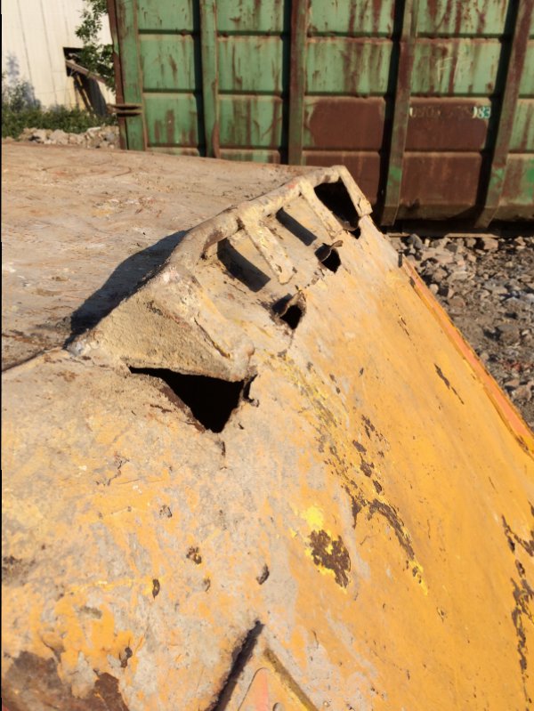

Having worked many a summer in a skip firm for pounds and raking, that is a bloody grand job mate. Did you have a lucky still day or just a high flow rate on the gas?
My Dad did this very same thing for a while with oxy acetylene and stick on a buzz box. Happy memories Simon, thanks for reminding me![]()
Sounds like you're having fun there mateThe back field is very open and even a slight breeze is a pain in the butt for blowing the gas away so I upped the gas flow to 20 l/m, if it gets a tad more than a breeze i put it up a tad more. the new optrel 684 mask with respirator is a pleasure to use, no more fumes and no more hot forehead

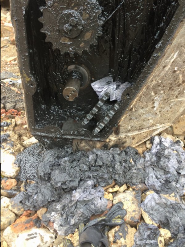

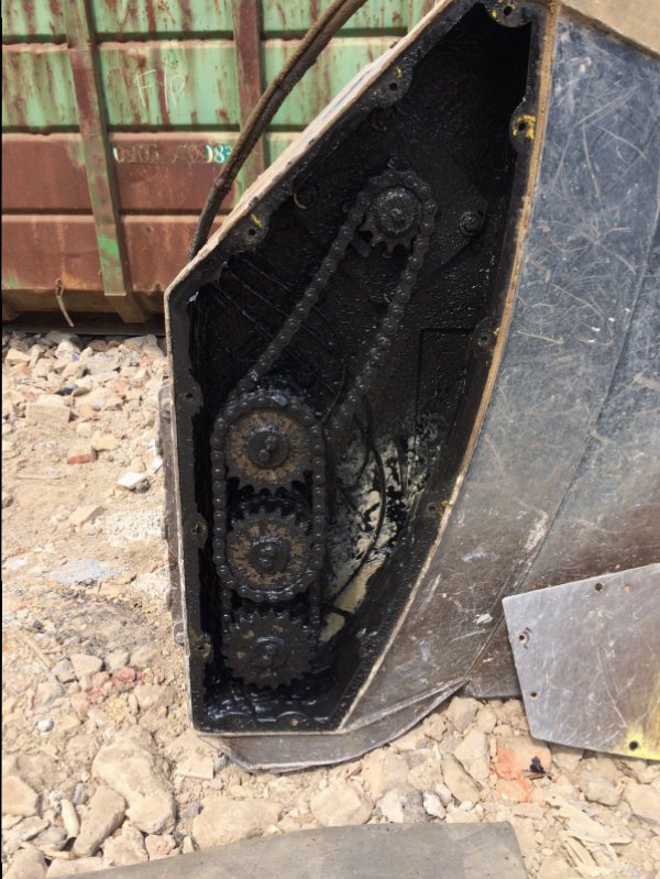

Reckon theres nigh on 100 skips to do and a couple of roll ons. I have a Remu screener bucket to rebuild tomorrow so I am quite busy tinkering away![]()
