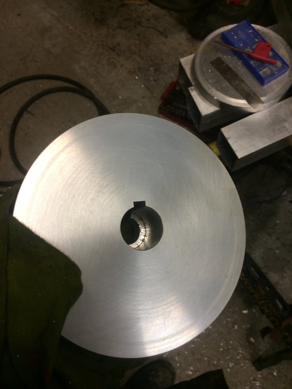

...... flipped the part and clocked it carefully to 0.8thou runout and 15 um on the face. Happy with that...

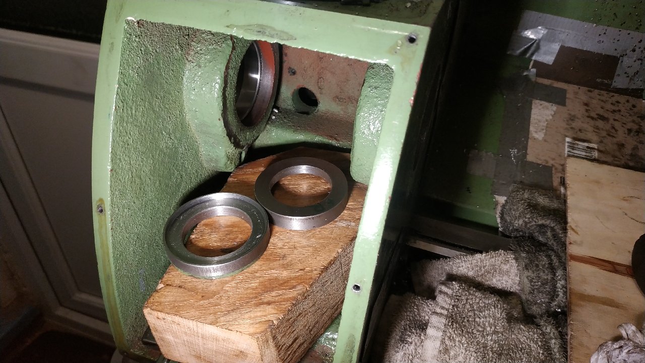

Bigger hammerSpindle out! Tight bearing took a lot of heat and hitting.
Now, how do I get it back in?![]()
then heat the case and put the bearing in the freezer and get it wound in quick may need some drilled plate either side as washers may bendBigger hammer
Seriously though, make up a puller of some sort, if it is the outer race then it can be as simple as a couple of washers and some screwed rod.
Bigger hammer
When I was saying washers I was meaning washers like we use for pulling in cutlass bearings on boats, usually made from 20mm thick platethen heat the case and put the bearing in the freezer and get it wound in quick may need some drilled plate either side as washers may bend
