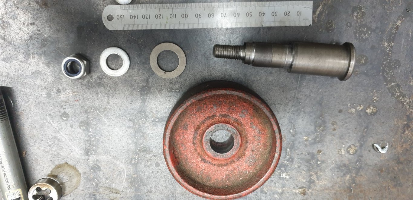

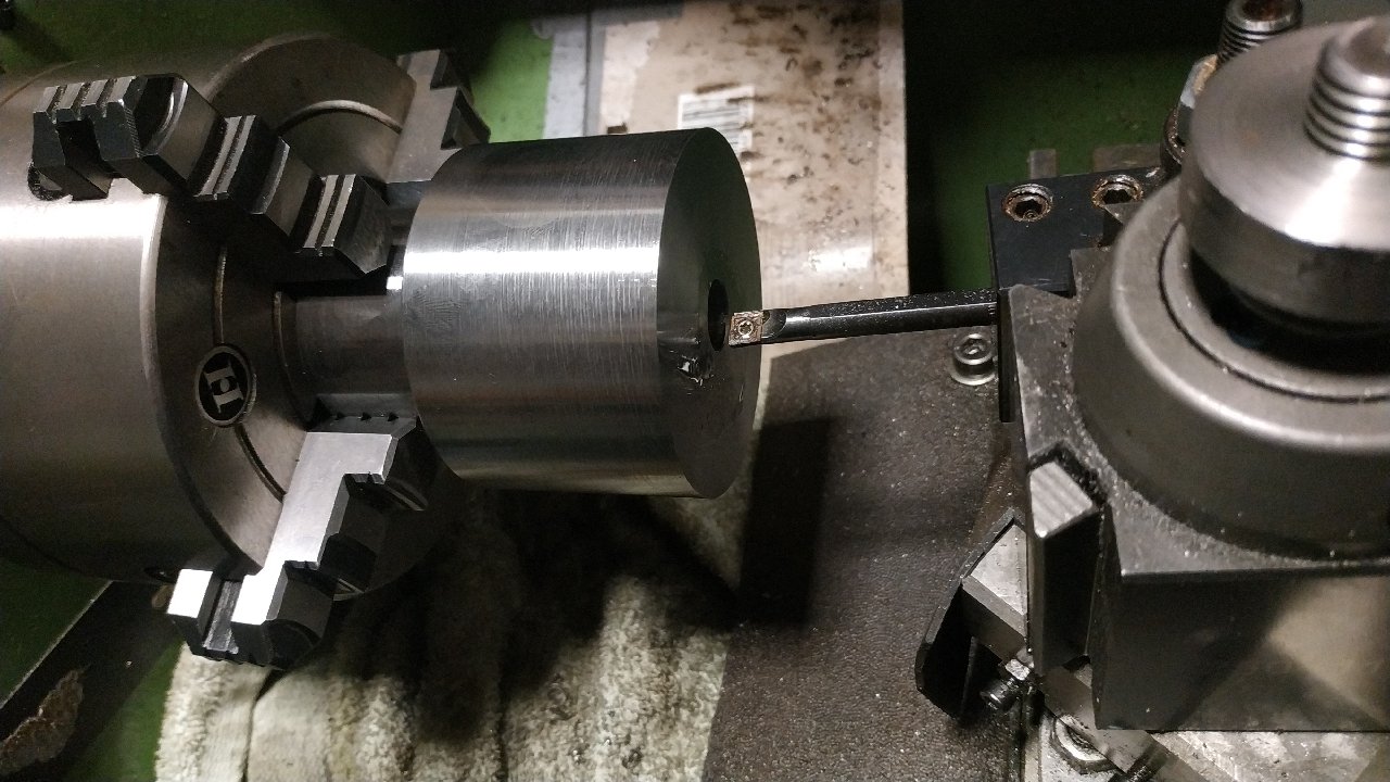

Superglued 3mm sheet alu to my previous error and turning to correct size 74.3mm, which will mean rear bearing will be floating from its seat by 0.3mm.
What is this alu sheet, Ive got a fresh sharp tip and it turns like sticky dogshit, pushing out instead of cutting!E]
That tool and tip is my preference for hacking out 6082T6 quickish in semi production. Responds well to coolant not splash and plunging in 1/3 to 1/2 the tip width by feel. Will notice it gets the way you say when the job gets hot.

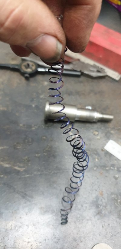

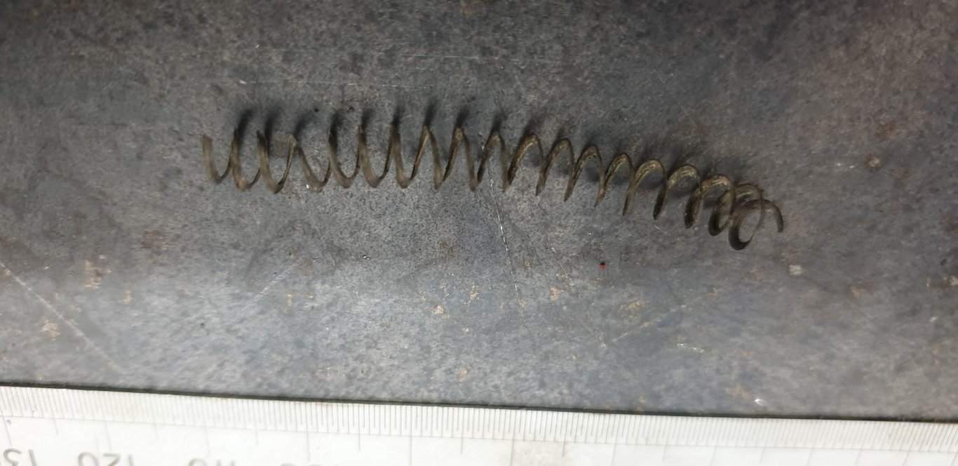

En19 stringer nearly cost me a finger . Two years on still have trouble with itEN19t scares me. Long stringy chips that have a lot of strength in them. Also curls that get fired down my jumper!
Finish damn good tho.![]()
They are nearly breaking@RaceDiagnostics I recommend trying some En19t
There is some chatter - turn sound down a bitOne of the stringers tried to shoot up my nose!
Yep, it's hard to go too fast for carbide! Proper depth of cut as (usually) carbide inserts have a bit of a radius on the cutting edge and won't cut until you pass it - reduce the feed rate so you don't run out of motor power/torque.
If you want to try coolant, it needs to be a constant flood or (if you're working it hard enough) the thermal shock of intermittent coolant can shatter the insert, cutting oil's ok as it doesn't have the same rapid cooling effect.
Unless you have unusually sharp-edged inserts, you can't take fine shaving cuts with carbide (that edge radius again), so *no sneaking up on dimensions*! Doesn't work!
Take the last two cuts (semi- and finishing) about the same depth, example: 20 thou" off final size, semi-finishing take a 10 thou" cut, measure to see what it took - say it's now 11 thou" oversize so it took a thou" less than dialled on - take the finishing cut accordingly, dial on 12 and it'll come to size - the loads on the two last cuts are pretty much identical so the tool will behave the same.
This assumes you've got the gibs adjusted right, toolpost's locked down properly etc. etc...

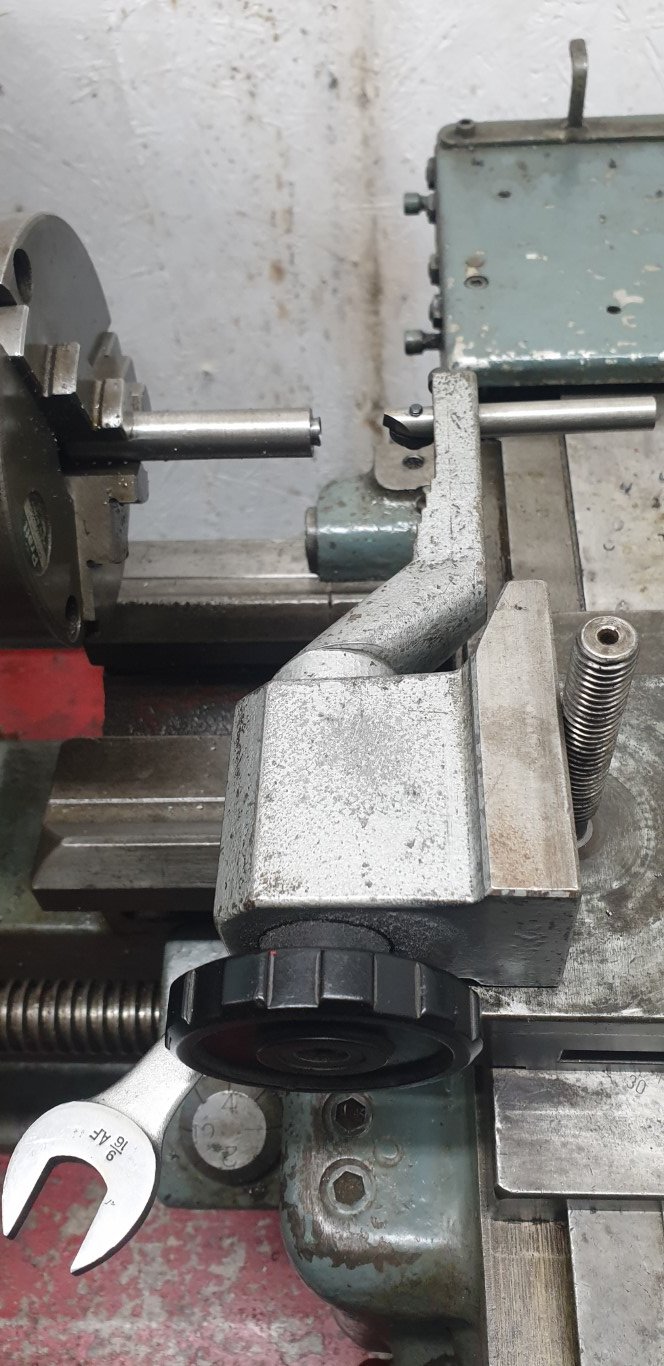

50mm facemill with mild steel on a lathe? Not very good. It is still in the hard skin but half hour for 0.5mm...
It'll improve when I add support on the vertical.
These 18mm Hydra cutters no problem. 0.5mm cut and Im sure can do more.
