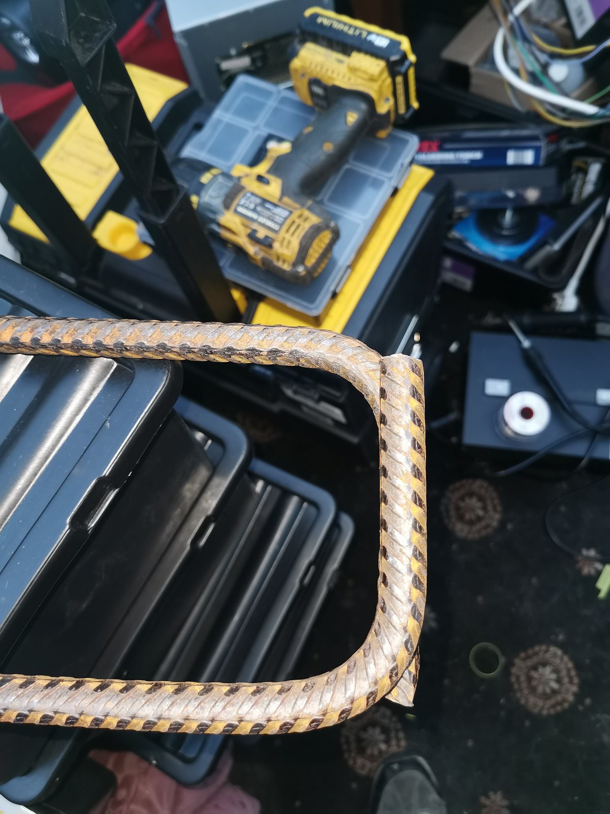

while I have the CAd design experts together. lol I am in need of some basic tuition. Using fusion I have managed to get this far!

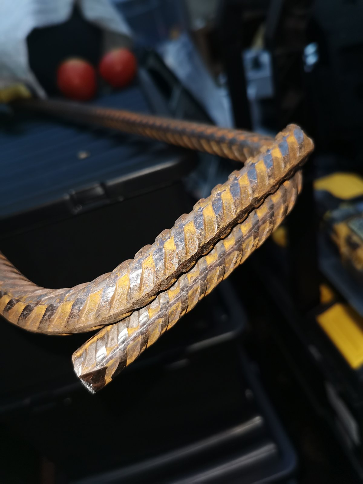

I need the part to hold 2 pieces of bent reebar in position. I need more that two pieces but each block will end up being and insert. Eventually made out of ally and welded in place.
But for now I am trying to prototype.

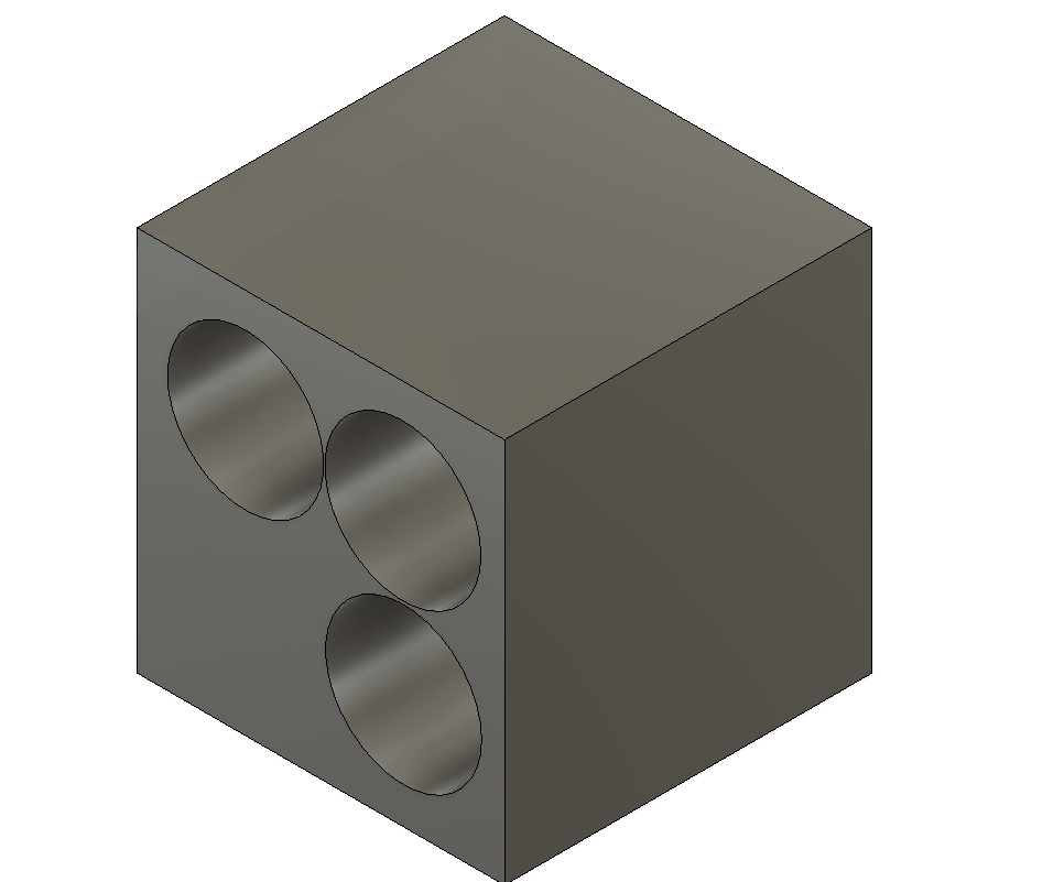

So the top two holes I need to cut lines 17mm apart to make the two holes join, with a radius at the rear. this will have a bent reebar pointing upwards. The single hole is fine as it is because the bent rebar will be pointing down. (matching the radius in the rear of the block.)

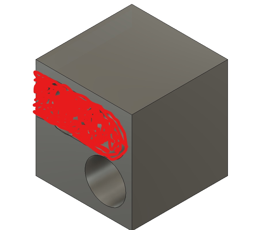

View attachment 243807 so imagine that red blob I just added extruded to the right all the way through the block creating a cavity. What process do I need to do that. I can extrude a round hole and I can add bits to an object but cant create a form tool to be able to extrdue the shape I want..lol I am sure thats the way its done but cant quickly find a tutorial.

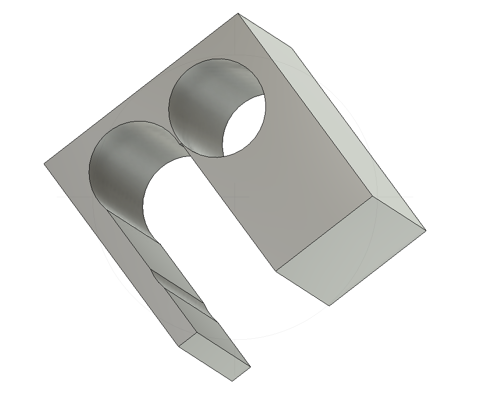

yes mate spot on. I just found a video which ironically helps me out as its the second thing he shows BUT it also highlights why many of us find fusion tutorials hard.. He then goes onto loads of other stuff. In this case I could just turn it of and go and carry out what I need but many tutors assume too much and start telling you things you most likely will never need.Is this what you mean? (Obviously not to scale).
well thats what I knew to do. But yes getting the shape and in the place I want it!Lad says click Sketch, draw the shape on that face then extrude. I assume your having trouble drawing the shape?
If it was AutoCAD I could have helped (draw the shape as a polyline and extrude).

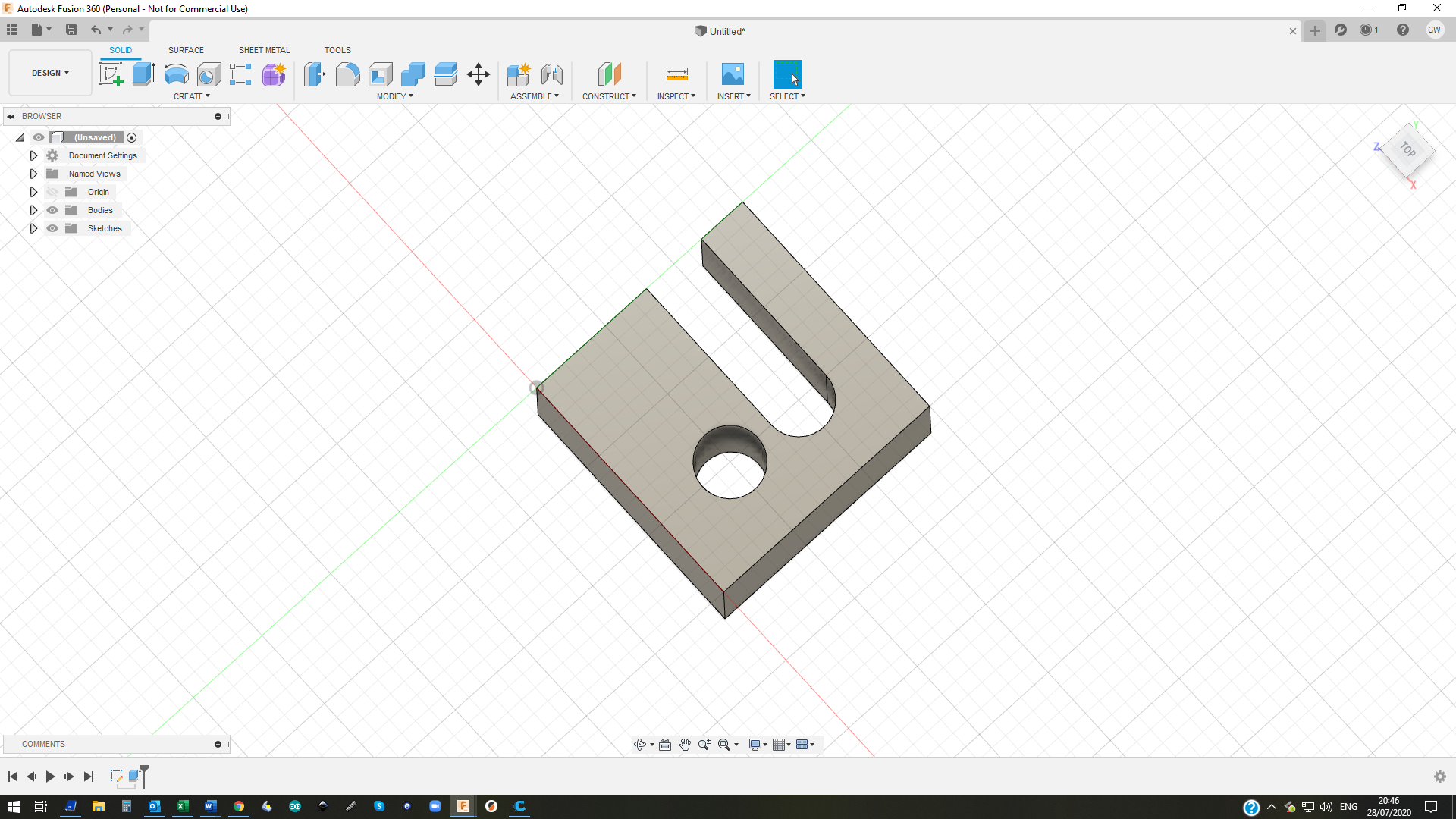

I will try your way later mate. I cobbled it out after a fashionCreate a sketch (doesn't matter which plane is used. Create a rectangle. Create a circle and position it (centre and radius) where you want the single hole. Create a circle and position it (centre and radius) where you want the top right hole. Create a 2 point rectangle starting at the left hand edge of the block with the diagonal corner on the vertical diameter of the top circle. Modify, trim and click on the vertical diameter of the top circle then on the left hand semicircle. Both should be removed leaving a round edged slot. Finish sketch. Extrude, click on main body and type in dimension of extrusion. This should give you your block.
They all seem to be a similar prodedure but in fusion , starange as it may seem I have trouble moving a sketch. So I moved the body instead..lol But it wont work all the time.If it was Sketchup I'd build the solid, then build a solid version of the hole I want, then intersect the two parts, create an "intersection" and delete the hole...
The method Bladevane describes is convenient as you have all the dimensions in one sketch so if you want to go back and change something, hole size or position perhaps, all your dimensions are in one place.If it was Sketchup I'd build the solid, then build a solid version of the hole I want, then intersect the two parts, create an "intersection" and delete the hole...

You can do it that way in most CAD programs if you want. It's slightly more controlled as a method though:
1. Create a sketch
2. Draw a rectangle in the sketch and dimension it so that it's the right size
3. Extrude the sketch to make it a solid
4. Create another sketch on the face of the new cuboid
5. Draw the circle, setting the diameter (or radius) and distance from each edge of the face of the cuboid
6. (Called different things in different applications) extrude/pocket/remove the new sketch, removing it from the block
You can also (if you **really** want to work in a sketchup way), extrude the second sketch into a separate object and then cut one from the other, but it's a bit pointless.
For something so simple, it's quicker to include the cut-out in the original sketch and extrude straight to the final shape. For more complicated parts, it's often better to keep the sketches simple (so each one is for one part of the design) rather than trying to cram lots of unrelated things into a single sketch.
