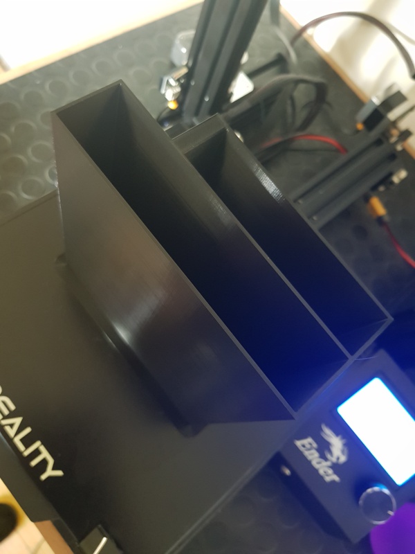

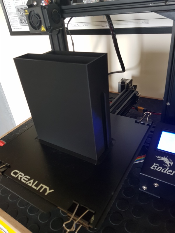

Its all this faffing around thats putting me off buying a 3d printer. Im at a stage now where I just want things to work all the time with minimal dicking aboutI did a 20 hour print of a frame of some drawers to keep bits of the printer in under the heated bed. Mainly to see how good it was, I was pretty pleased with the results. This was with the new hot-end because I screwed up the last one due to under-tightening the nozzle and the replacement came with a shiny new extruder to replace the plastic one.

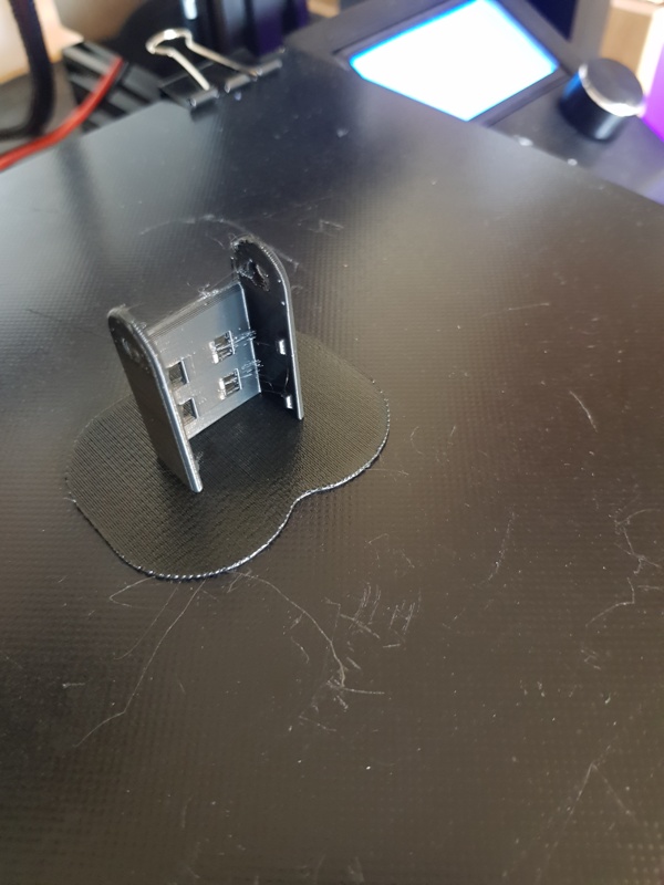

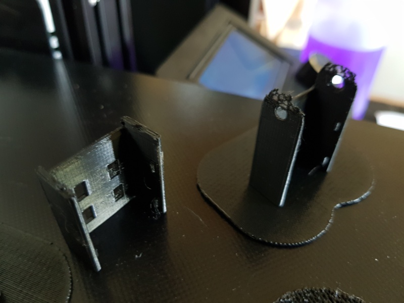

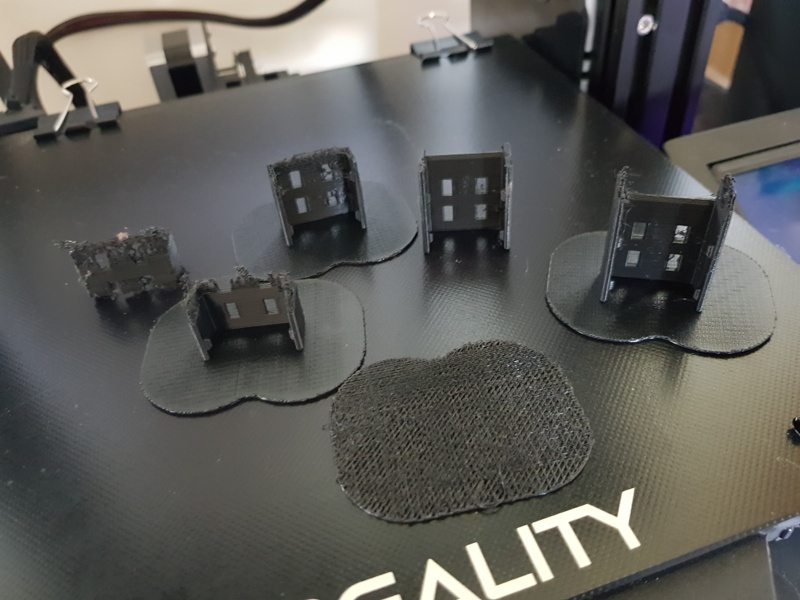

Then I decide to print off some simple clips to tidy up the cabling as they get in the way and could potentially get tangled up. Same filament, no changes to setting and it all went pear shaped, very poor prints. Here's a clip cover that is proving a challenge, many prints, all died in various stages. The symptoms are that filament stops being deposited and eventually the filament snaps at the extruder.
The raft at the front was before I started looking into the problem. Its very poor and looks like a feed issuse. The other rafts are after I tinkered with the extruder.
This is close but no cigar, the print on the right failed about 5 mins from the end

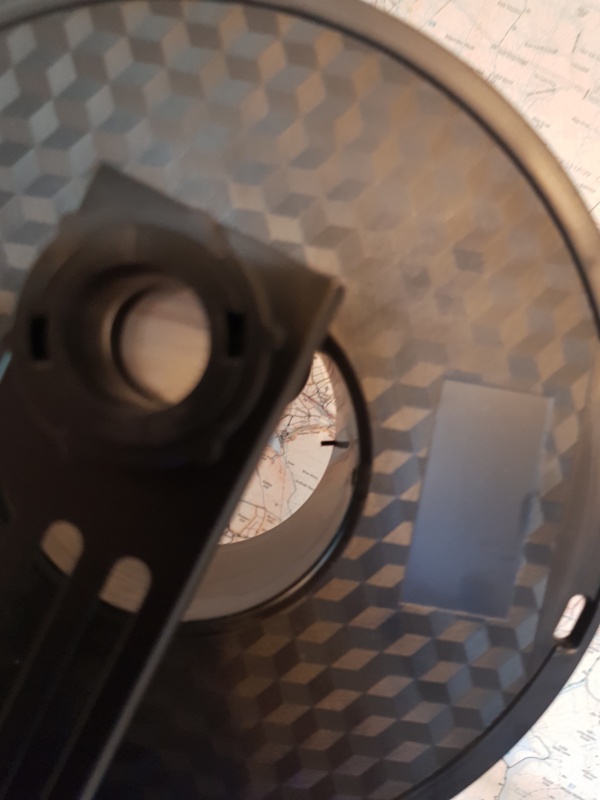

After reading around the subject, it seems that the most common causes are extruder issues, heat creep and other types of hot end blockages. After watching the next print I first looked at filament feeding, there was the occasional big clunk as the roll of filament turned and lifted over the obstruction. This was not the cause but easily fixed, it turned out that when they spool the filament on the reel, there is some left sticking out on the inside, trimming this improved filament feeding.

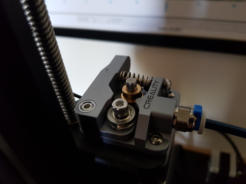

Next syptom was that a few minutes before the print failed, the extruder started clicking, this is where the rollers are exerting pressure on the filament, but the filament can't feed so eventually it slips in the roller, the click is when the feed roller tension is suddenly released. Below is the new extruder, same feed roller and motor, just aluminium not plastic body.
It only happens just before the print fails so I don't think this is the root cause, but after looking up causes the roller nearest, although on a bearing, several people have reported that loosening the bolt slightly so the roller can move a bit and line up with the feed hole helps. So I did that and increased the roller tension. This did improve the overall feed and the better raft shows that, but prints still failed.

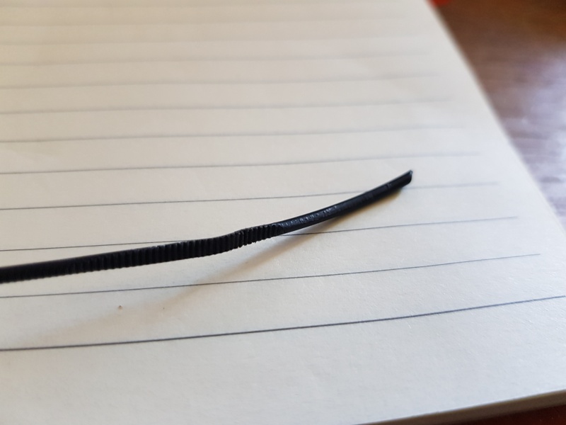

If you leave the extruder clicking long enough, the toothed feed roller wears through the filament and it snaps. just where the filament enters the hole leading to the bowden tube. You can see the groove being worn in the filament below.
What I did notice is that I couldn't manually feed the filament and get anything out of the nozzle when the issue hits. However, its not a nozzle blockage, if I heat up the hot end, pull out the old filament, replace it, immediately the filement exused from the nozzle. So onto problem solving in the bowden tube and hot end.
First up the bowden tube needs to be pushed right up to the extruder and the hot end, no gaps between extruder body and tube, or hot end and tube. I checked both ends, no issues and it still happended. if it was heat creep, that is heat from the hot-end creeping up to the heat sink and melting the filament before it gets to the nozzle, I would have thought that this would also show up when I pulled out the filement whiel herating the hot-end and replaced it. So discounted that for now.
I tried different filament temps, the box was printed with PLA at 200c, the problem started with the same PLA at 200c. so I lowered it and raised it a few, same issues. I've tried it from 190 up to 205c and given I can feed the filemt manually through the nozzle at 185c I don't think this is a root cause.
Although I have changed the extruder, this was before I made the box and it is virtually identical to old one, just better quality materials. However I wlll calibrate the feed by measuring how much filament is fed when the printer thinks it has pushed 100mm into it. There's also some calibration about how much the extruder reverses the filement to play with. Its 26c in the office during this heat wave, that may be playing a part....

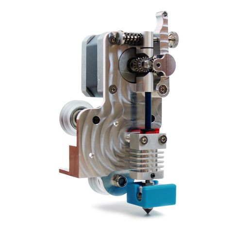

Although I've learned a lot from this, my finger just fell on the buy button for the micro-swiss extruder/direct drive hot end. Life's too short and I want to get printingIts supposed to get rid of any heat creep issues and other feed related problems. I will have to calbrate the stepss per mm feed with this but it will also print a wider array of filament types as it can go hotter without heat creep so I can tinker with stuff that stock bits can't handle.
