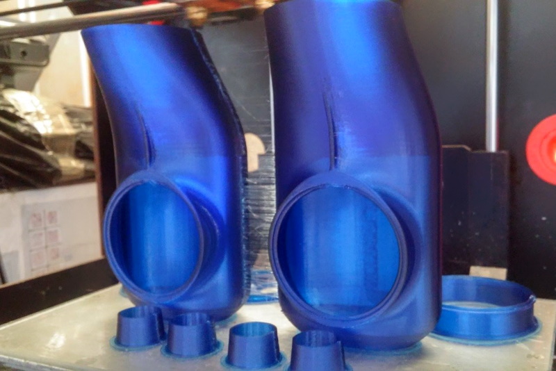

RC race series trying to squeeze out every last horsepower - I think I did about 30-40 of them.
The stuff does get that lovely satin silky surface like you said though, I love it when it prints right:

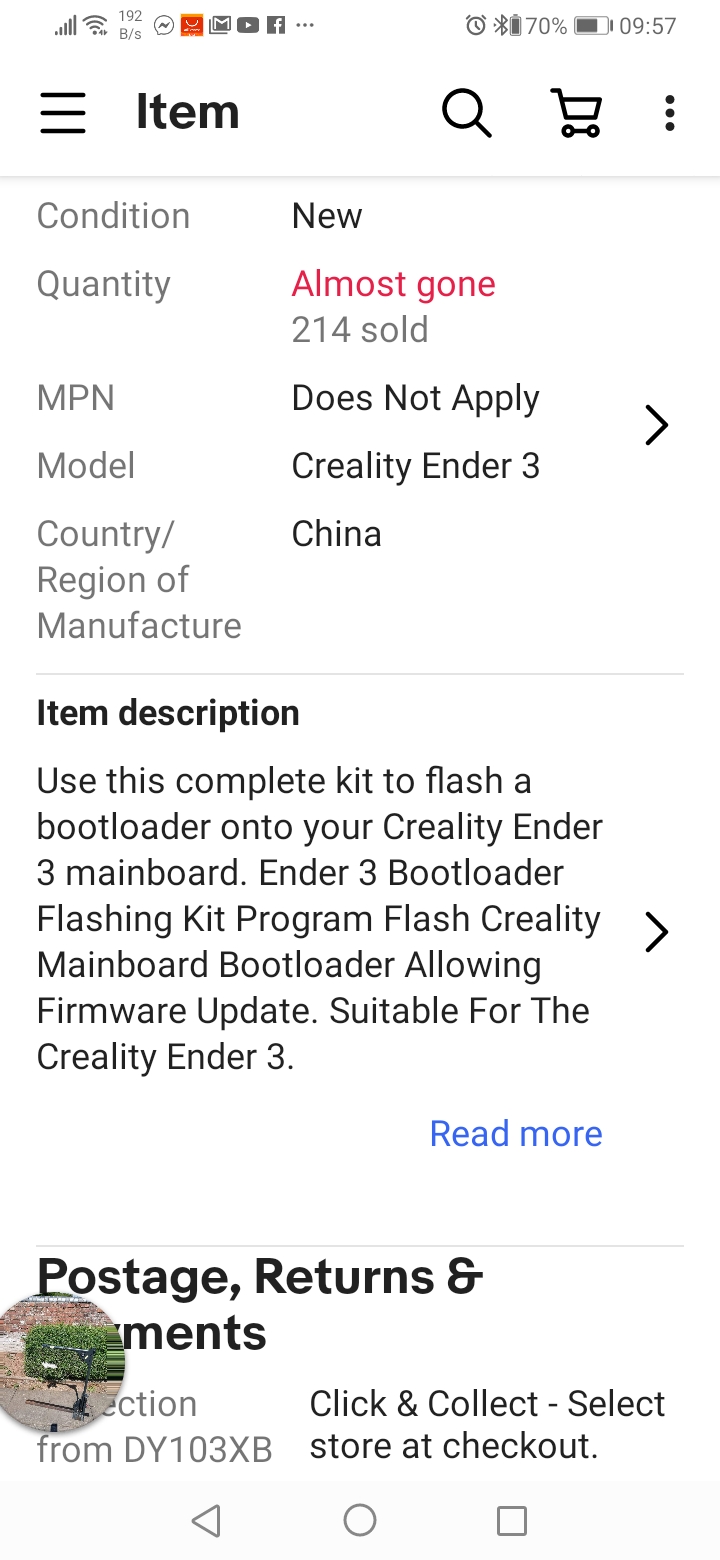

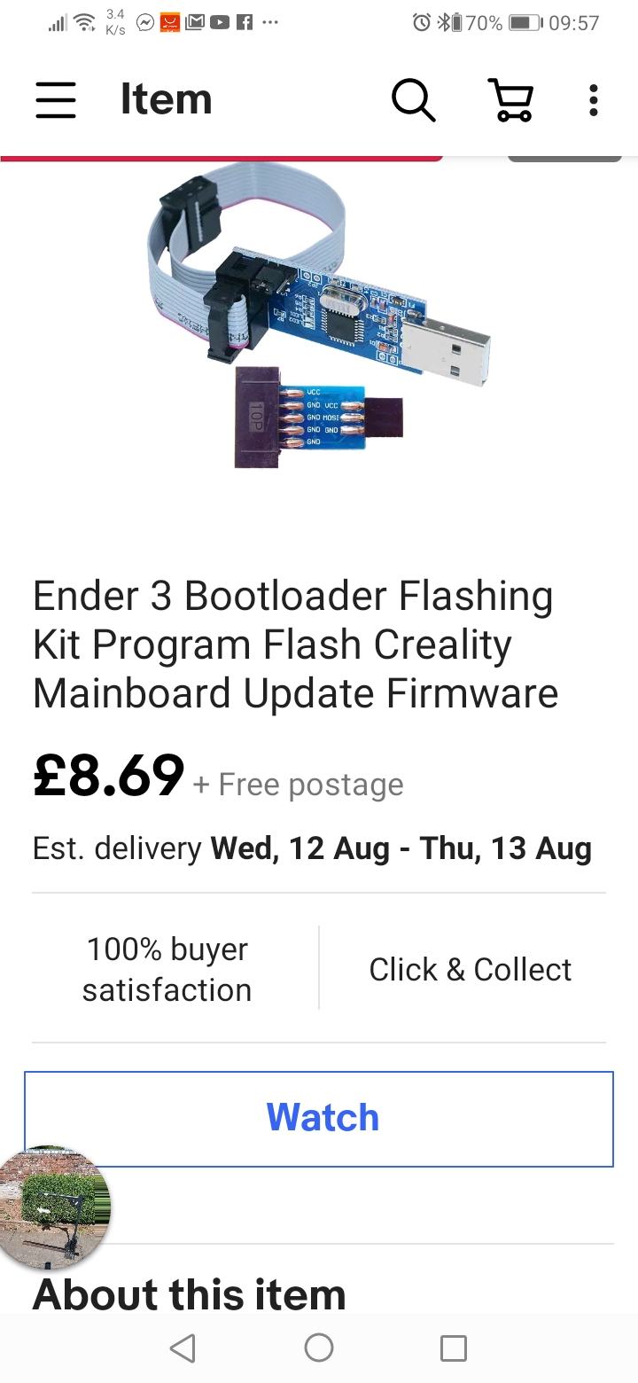

I was going to add a bootloader to the existing main board so I could upgrade firmware easier but the stock main board is struggling memory wise. Ender left out a bootloader as they would have struggled with other features because of memory constraints. So I've ordered a replacement board based on a 32 bit Arm chip for the princely sum of 35 quid. Its the BIGTREETECH SKR MINI E3 V2.0 32Bit Control Board With TMC2209 UART For Ender 3. It's a direct replacement physically and cabling wise for the existing 8 bit mainboard. I'll probably have to compile the Marlin firmware but others have done it before so could probably download it, either way I don't mind.

I used one of these when I installed my silent board. Creality claim to have a bootloader in the latest board mine did not. LolPrinter fixed and printing a polar bear for an automaton that the eldest daughter wanted.
