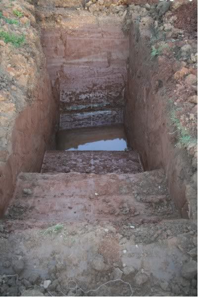

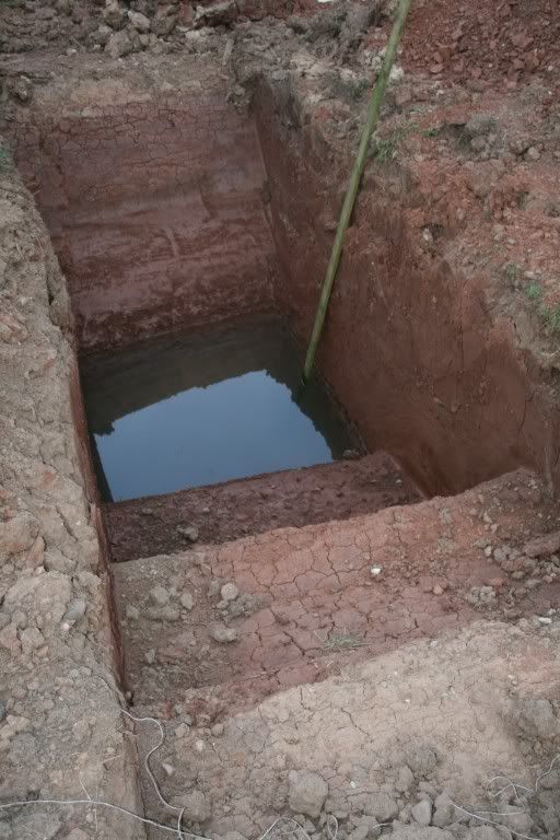

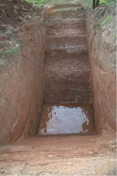

but not for long, l had an exploratory dig tonight just to see what was down there, lots and lots of clay is the answer, went down about 12 feet or so and eurekait was damp well more than damp wet infact
trouble is the clay walls are not allowing the water to seep into the hole very fast,
the bottom of the hole is 5' wide 4' long and about 2' deep it took about an hour for it to fill with water, not fast enough l could empty that in 30 seconds with a pump, still it might get better further down bad light stopped play tonight

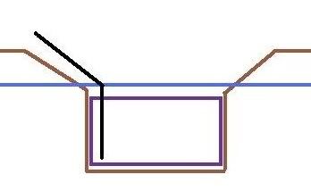

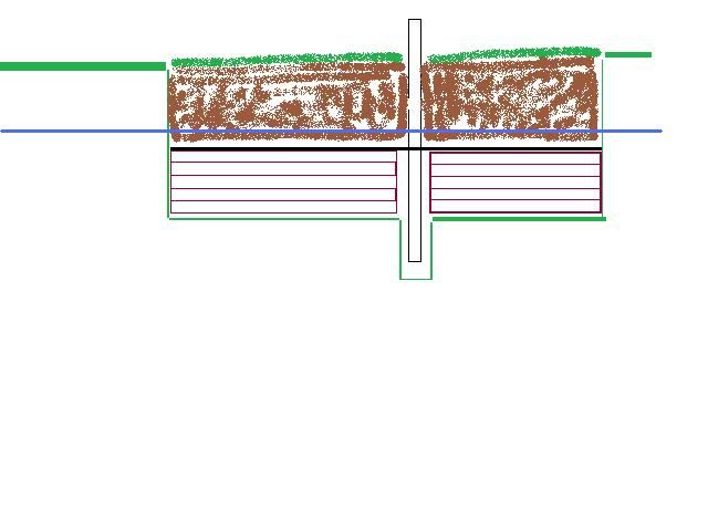

was thinking of putting lots of slits in the sides and top with an angle grinder and then dig a hole and place it in so as the top is 6" below the water table, again have 6 to 12" of 20mm gravel all round it, then slope the banks back nice and shallow so as it dosent all slide in, weld a 2" pipe into the roof that extends down the floor inside the container and use this to connect a pump to, all l would have to do is look in the hole if there was water showing above the gravel on the container roof then l would know l could pump out 40 cubic meters of water, would have to start at 11 pm of course to stay under the 20,000 litre rule
