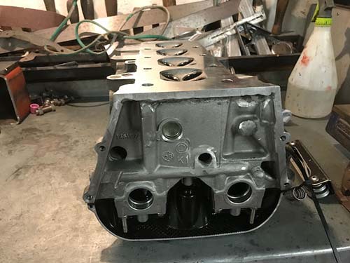

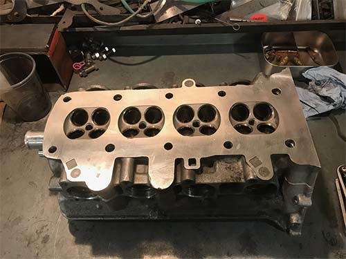

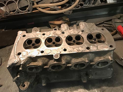

Progress yesterday finally welded the head up, the amount of contaminants was unbelievable. Had spent ages cleaning the head, grinding out the water ways and finally giving it a wipe over with acetone. Warmed it up for a good 40 minutes on the camping stove, set the r-tech to 190amps, 40% cleaning, 2.4mm tungsten and 2.4mm 4943 filler rod with 8lpm argon. Probably would have been better with a 3.2mm tungsten but the garage gremlins seem to have had them away, anymore cleaning action just melted to tungsten into a massive ball.
i used to weld up corrosion damage on bently heads , usaly use the first as a sacrificial pass ie weld it and dig it out back to clean , i welded up a friends austin seven head recently for dry decking , it was much modified with extra studs as it had a centric blower on it it had a seperate cooling system for head and block too
