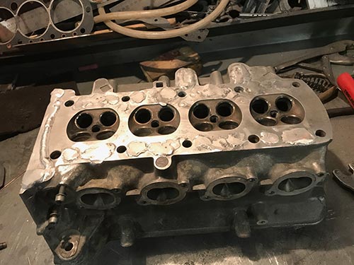

We did indeed, ******** if i can find any photos of it though.... i know they exist, because i can see them in my head (maybe on your fb? cant be bothered to look especially), me preheating with the oxy propane, then you welding.... weird? Only thing ive add to whats been suggested, is to make sure it cools slowly. I built a insulated box full of vermiculite for another job (definetely for another job, 100% didnt spend time at work building a box just for my cylinder head, no sir, that would be wrong.....) which it went into immediately after we'd finished. was still nice and warm 12 hours later, so defo will have cooled nice and slowly.... to be fair, if youre anywhere nearby, youre very welcome to borrow the cooling box, id need it back after though, it does actually still get used occassionally!

Did we cut slugs and weld them in, slightly proud, then put it in the bridgeport?

Will do, blocks just about done just waiting for one more set of plugs to be machined to fit.

Would that promote cracking around the weld area as the plugs and head would expand and contract at differing rates in everyday use?
