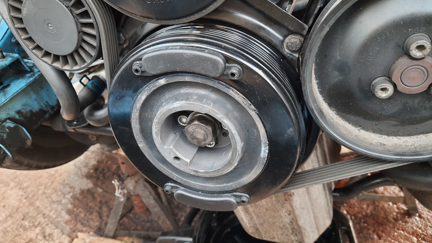

To be honest it gives us the chance to look for yin worm and clean out behind the wings, its amazing how much crud gets trapped.For some reason i thought it was a T4. LTs are easier but still awkward. Working through that hole in the doghouse is always fun. I never took the whole front off unless pulling the engine, but it does give you loads of room to work in.

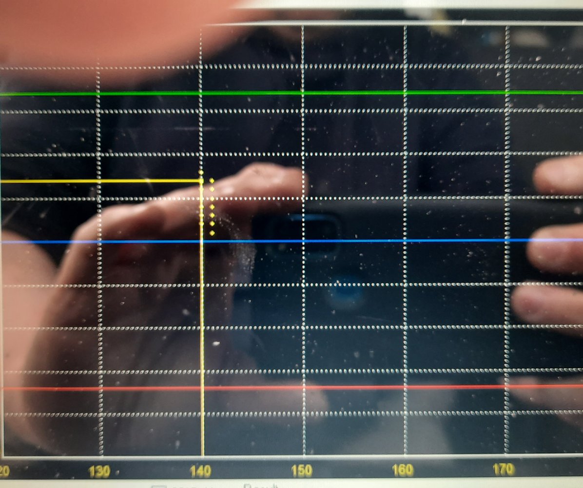

I don't know if your software will allow it but you can get VCDS to cycle the turbo wastegate or vane system via the N75 valve at idle. This was my T5the N75 turbo control valve is still suspect but that is an easy swap, thanks all for input and interest.
