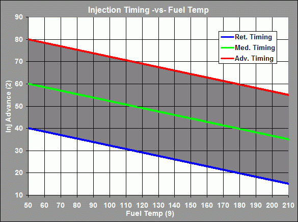

The LT35 ANJ 2.5 tdi threw a wobble a few nights ago as i was driving, it suddenly sounded like the engine was not timed properly and lost power, after plugging it in we got a P1248 code and cleared it but the issue is still there and the code returned, The physical timing looks fine as in no jumped belts so a quick google seems to point to "Start of Injection Timing Regulation not OK" which in my head means the pump timing or some king of electrical timing being the issue, is there any common fault or issue that this could be, the vehicle is a well maintained 150,000 2004 plate but i did drive over a rubble road 2 days before this happened that shook the daylights out of it, the LT was scanned again and the same code is back P1248, both the N108 AND G80 are within specs, i have now got a new N108 on the pump but as i drive it seems to have no power then suddenly burst into life and pulls like a train again, but that issue is not always there but has only started since it threw a wobble while driving, It starts fine hot or cold and does not smoke, i have wiggles everything i can get at so not i am stuck, anyone ever has an issue like this?
