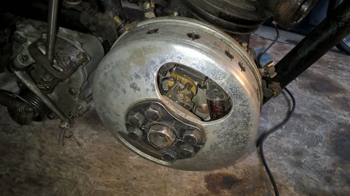

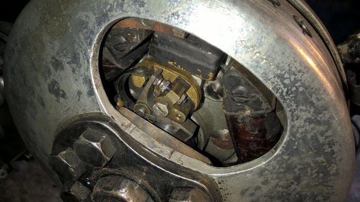

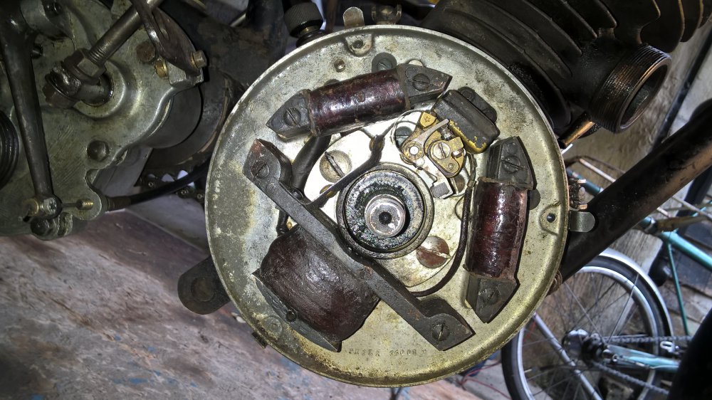

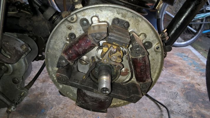

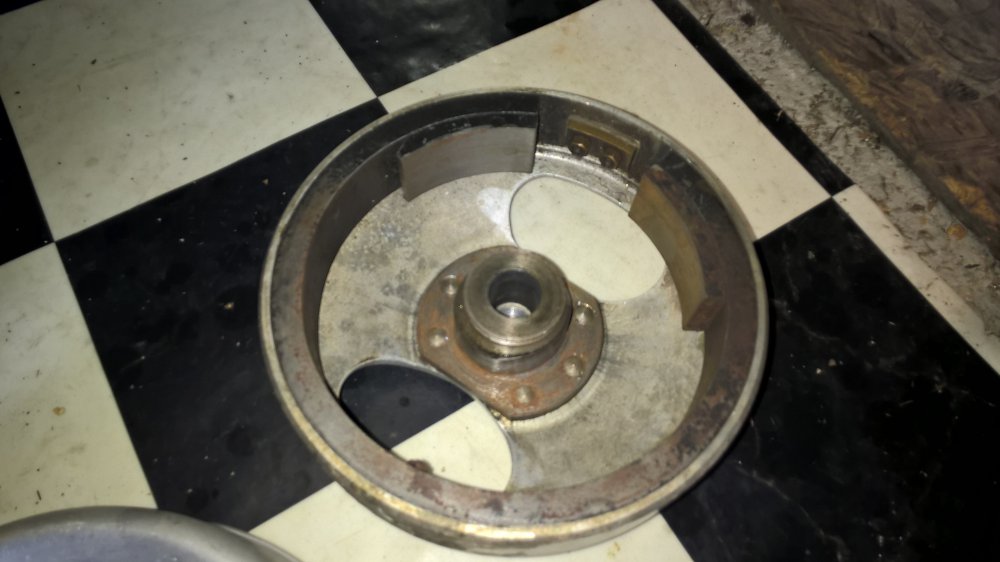

They do seem a bit weak. Thought about trying the trick to remagnitize with a arc welderNice bike, have you checked to see if the magets in the flywheel have any go left in them?
another job for a multimeter test the voltage coming from the coilThey do seem a bit weak. Thought about trying the trick to remagnitize with a arc welder![]()

Not familiar with that trick, I'm keeping an eye open for a magnet charger to sort out the Lucas sr1on my Howard.They do seem a bit weak. Thought about trying the trick to remagnitize with a arc welder![]()

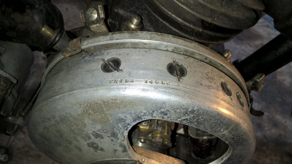

It looks like a villiers flywheel magneto haave alook at the drawing on this page
http://www.historywebsite.co.uk/Museum/Engineering/Villiers/Villiers3.htm
