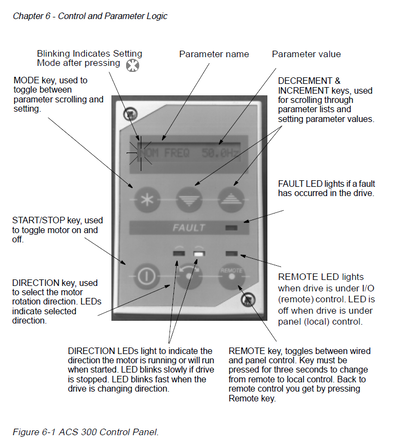

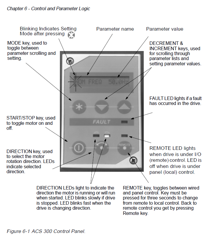

I did a project at Springfields using those, but only interfaced with them from the DCS system so had very little to do with the drives themselves. They looked OK, pretty much all manufacturers seem to have settled on the same format for their displays/front panel. I quite like the Schneider (optional) larger graphical interface with the large round navigation wheel. Lenze were probably my least favourite in terms of front panel (They had a removable keypad), horrible and confusing menu system, though the software wasn't too bad.That's one of the things I really like about the ABBs I have - meaningful screen, meaningful manual, e.g.:
