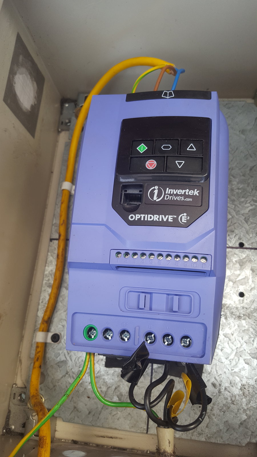

One for the VFD gurus. I know there are a few threads already on VFDs, but as technology moves pretty quickly – are there any updates to recommendations for reasonable and affordable VFDs?
I see there are mixed opinions on the huanyang ebay cheapies, but some people have had good success. I’m also looking at some that are available from Inverter Drive Supermarket such as the WEG, Yaskawa and Invertek. Any others brands I should be considering or any I should avoid?
I’d also like to run two machines (identical motors, same model, manufacturer and rating) from one VFD in some form of exclusive interlocked configuration – has anybody done this? I guess I would need some sort of stopped/ready to run signal from the VFD to avoid switching load while under power. Presumably in vector mode the spindle would have to coast to a complete stop before you could switch over?
