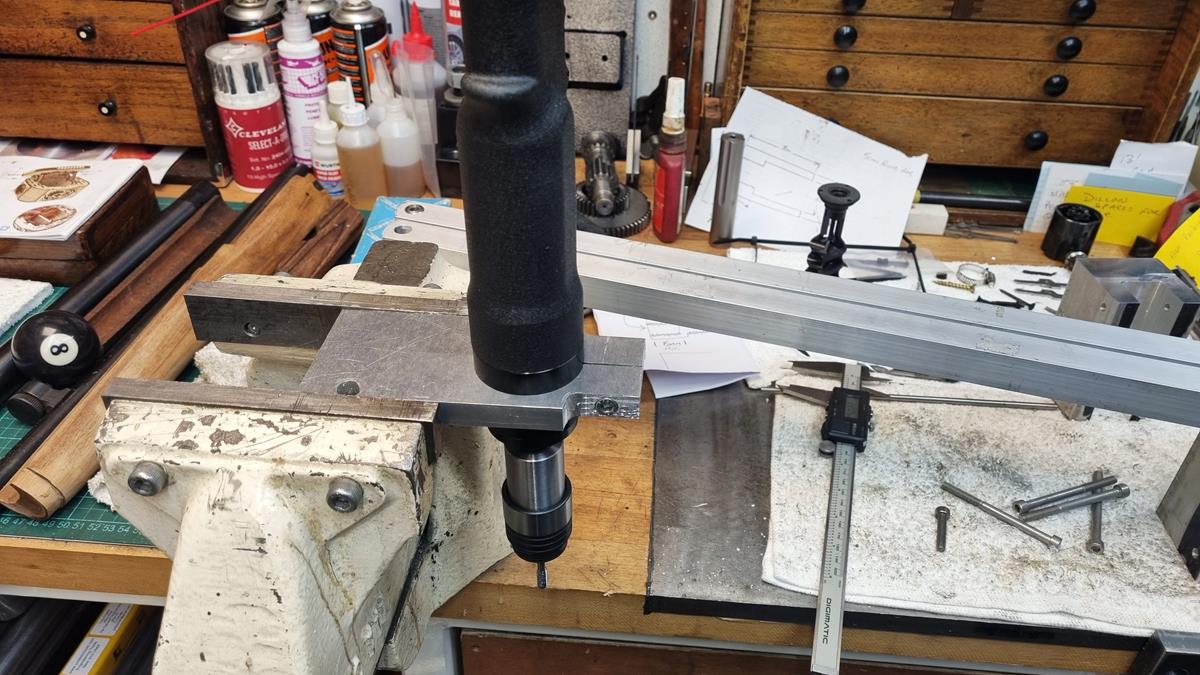

It’s hard to say though I wouldn’t think a decent cordless would bother it.What sensible maximum hole size could I expect from this Vevor before it starts to bend/rattle about? The base would be solidly bolted to about 60kg of bench.
I cant be bothered with air so spindle would be cordless powered.
Well in that case I think Im going to buy or make one! Should work as a light duty drill press if I make up a sliding, cordless powered spindle to go on the end?
I have very little space but this looks like it would suit being attached on the welding bench.

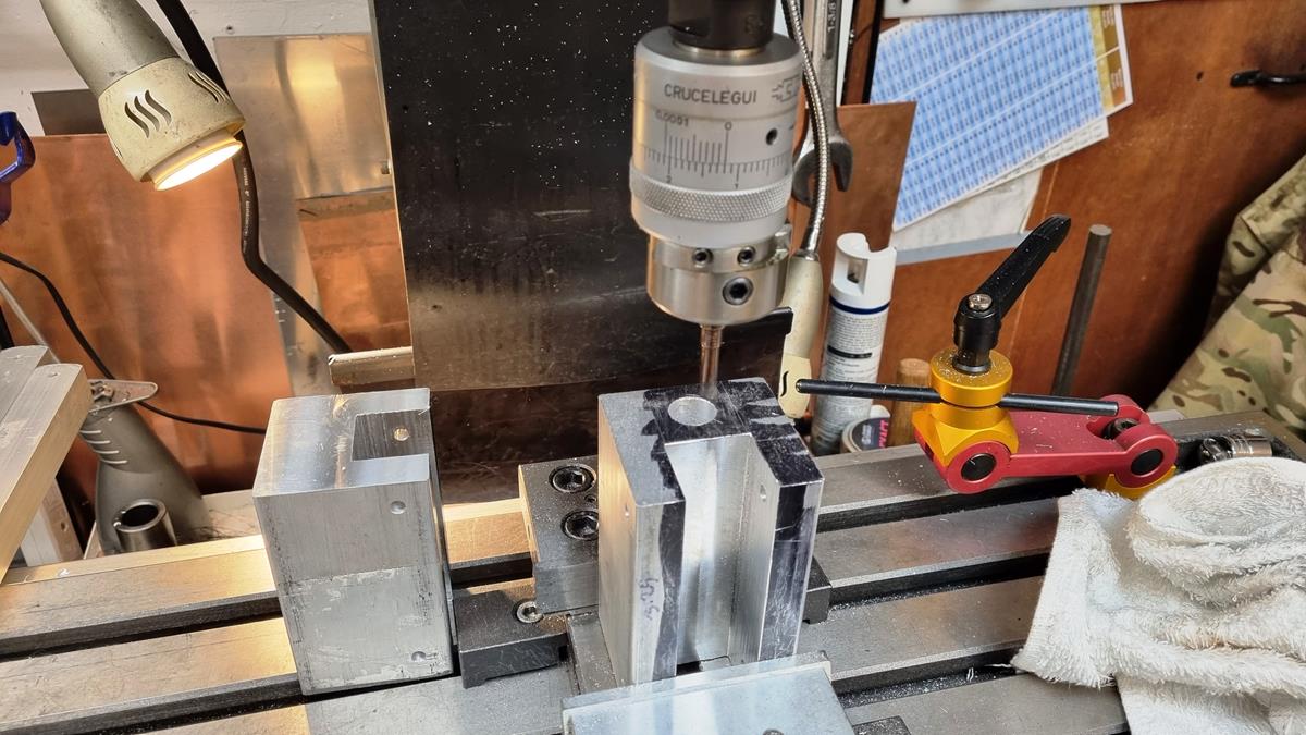

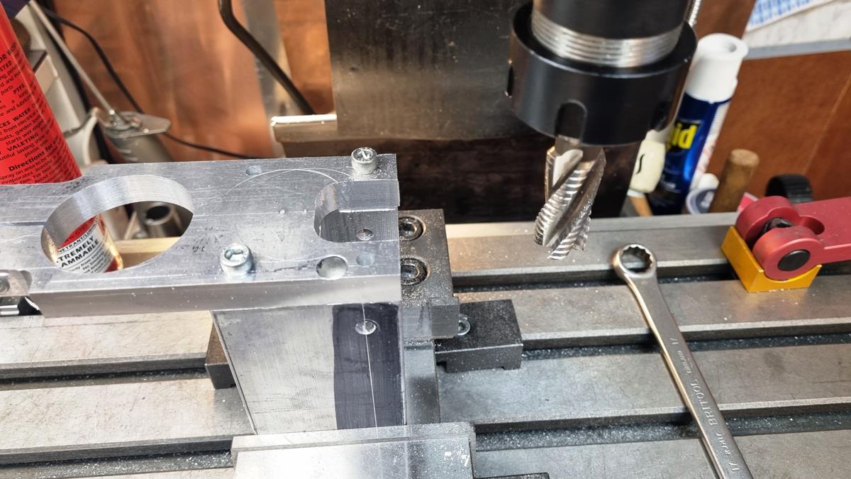

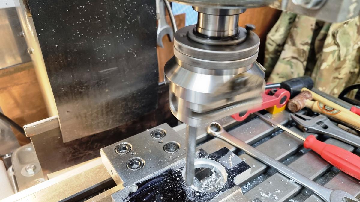

Gave my Wohlhaupter boring and facing head away many years ago, hardly ever used it and I knew the the guy I gave it to would.Got on a bit more with this this afternoon, needed the big Boring Head for the first part:

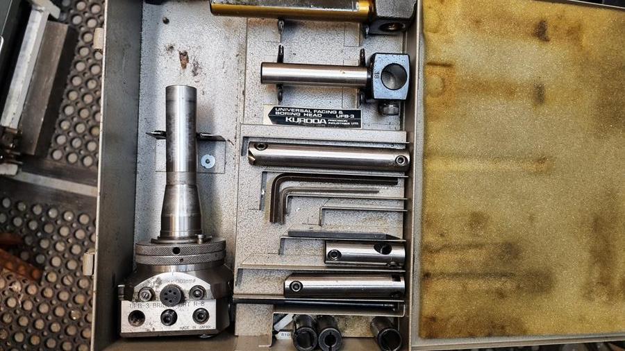

It is this bad boy:
Eaqual to or better than a Wohlhaupter in my opinion. Bought it in "as new" condition as the guy wanted the "real thing"? Can't work some people out.

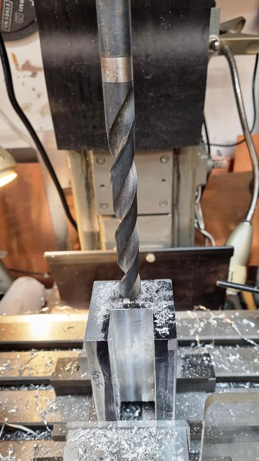

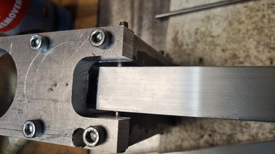

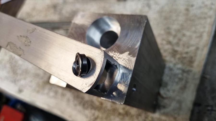

Then a hole drilled and we needed the Ikkle boring bar to make a bearing housing to create a pivot I bored a 16mm hole first and amazingly my care in setting it all up paid off as the hole came out the bottom at the same place as it started off at the top, amazing.
Then the boring bar:
I haven't created the bearing pocket yet as tea called and I don't want to queer my pitch right now. Mostly because I don't want to fix fence panels!
