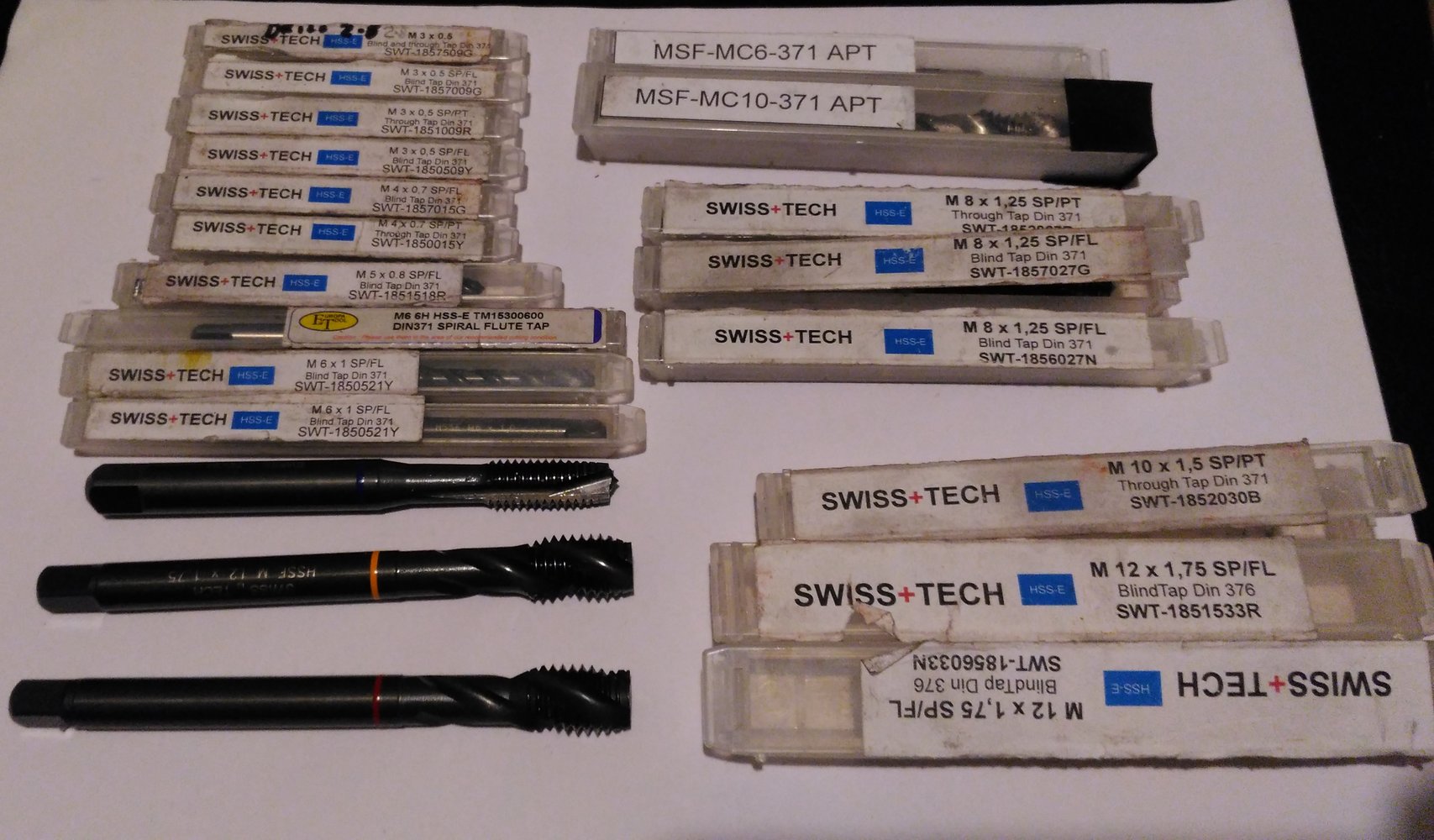

I prefer spiral point but I couldn’t find any for good value....I hardly ever buy spiral flute, then again nearly all the stuff I tap is through hole. I have found spiral points just breeze through stuff compared to spiral flute and they centre a lot better if tapping with a cordless drill.
The taps are JIS shank which they failed to mention![]()
There’s the most common which is iso then there’s DINAre those different diameters to ours?

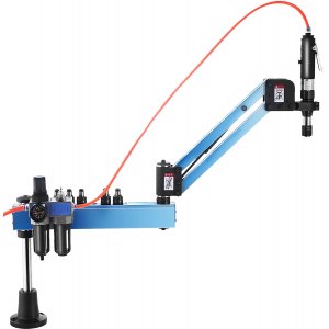

Have you got a link to the tapping arm or has that sold out now?![]()
Just go on vevorHave you got a link to the tapping arm or has that sold out now?![]()

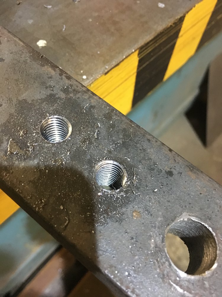

What size tap was that??In 25 mm mild steel with a used spiral tap it’s on its limit so no fancy metal though a new tap might help
Biggest thing is air oiler is total junk!
300 plus 99 pence delivered now.![]()
VEVOR VEVOR Universal Vertical Type Pneumatic Tapping Machine Flexible Arm High Strength Machine Arm 1000MM Air Tapping Arm Collet M3-M12 | VEVOR UK
Discover VEVOR Universal Vertical Type Pneumatic Tapping Machine Flexible Arm High Strength Machine Arm 1000MM Air Tapping Arm Collet M3-M12, High-strength Material and Simplified Operation at lowest price, 2days delivery, 30days returns.www.vevor.co.uk

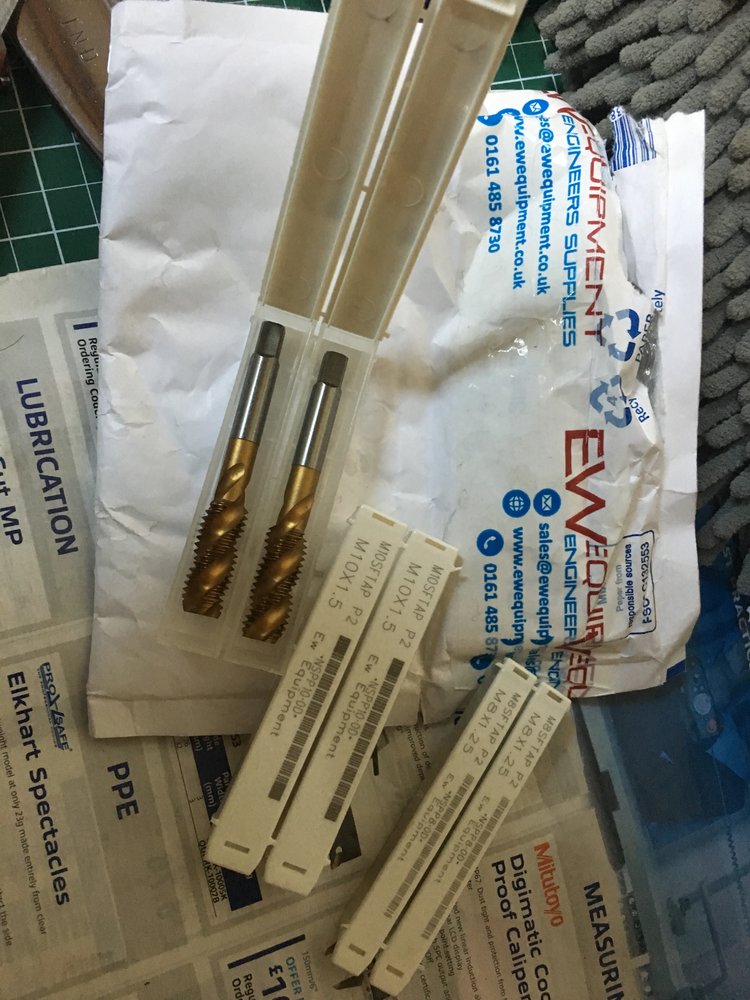

EW Equipment are pretty good mate they wouldn't sell crap. They stock all big brands too.Bought some chinesium spiral taps off eBay to try
The price seems to good to be true and I would risk on anything fancy but for dirt work like laser cut stuff I’ll try
I'm a convert to powder metal taps now. I've got a few dormer and a few guhring. They are unbelievable.I wait for Cutwel to have a sale on the YG Prime powder metal ones, they are excellent.

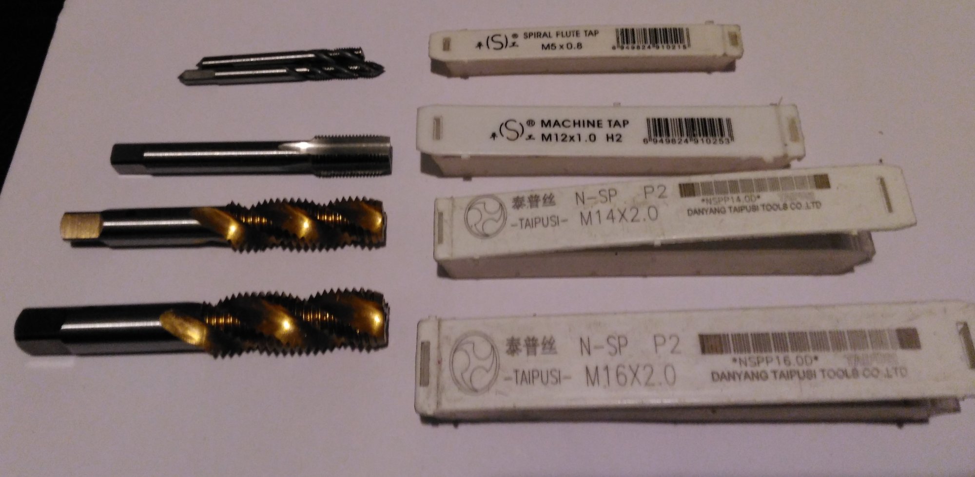

Danyang Taipusi, I think, I have a few.Bought some chinesium spiral taps off eBay to try
this is my collection
