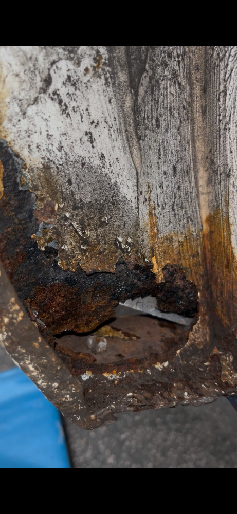

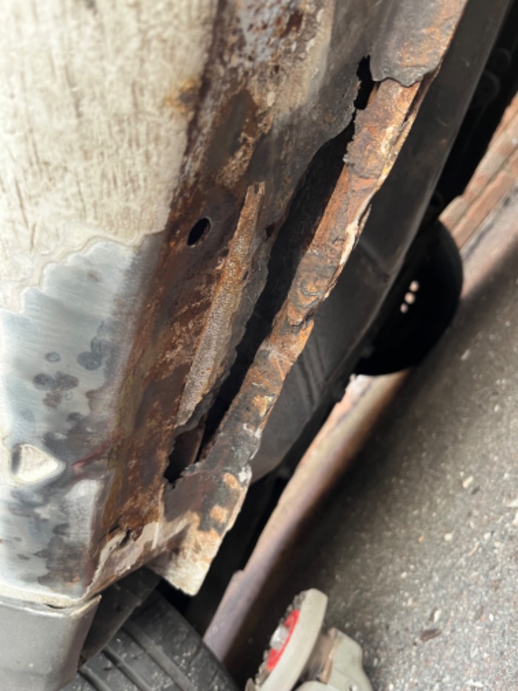

then apply some acf50 inside the sil once its done ,,,, that tends to give it a chance of staying fixed ,,,, and dose it every two or three years after thatYeah will do once I get to clean metal I cut the rust out template it onto new metal and butt weld he new sheet in hopefully
