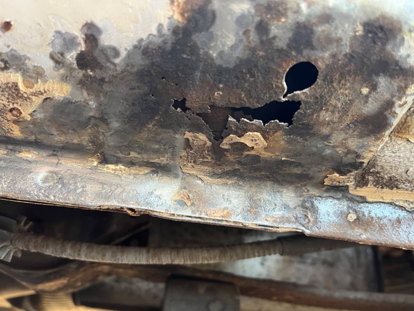

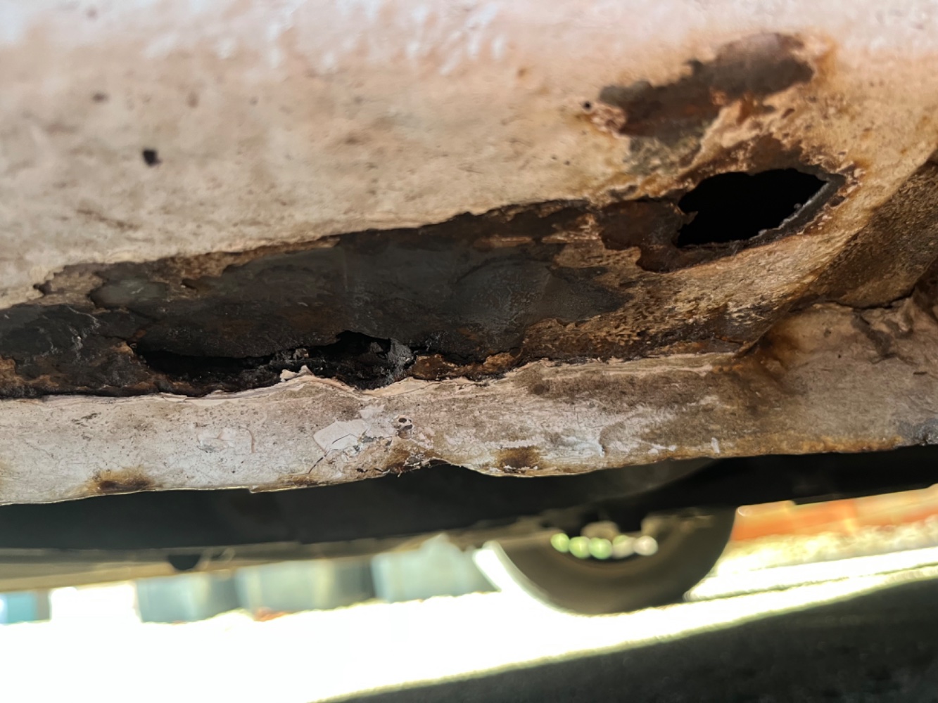

You're gonna need it ford's love to rust.I’ve loads of sheet metal

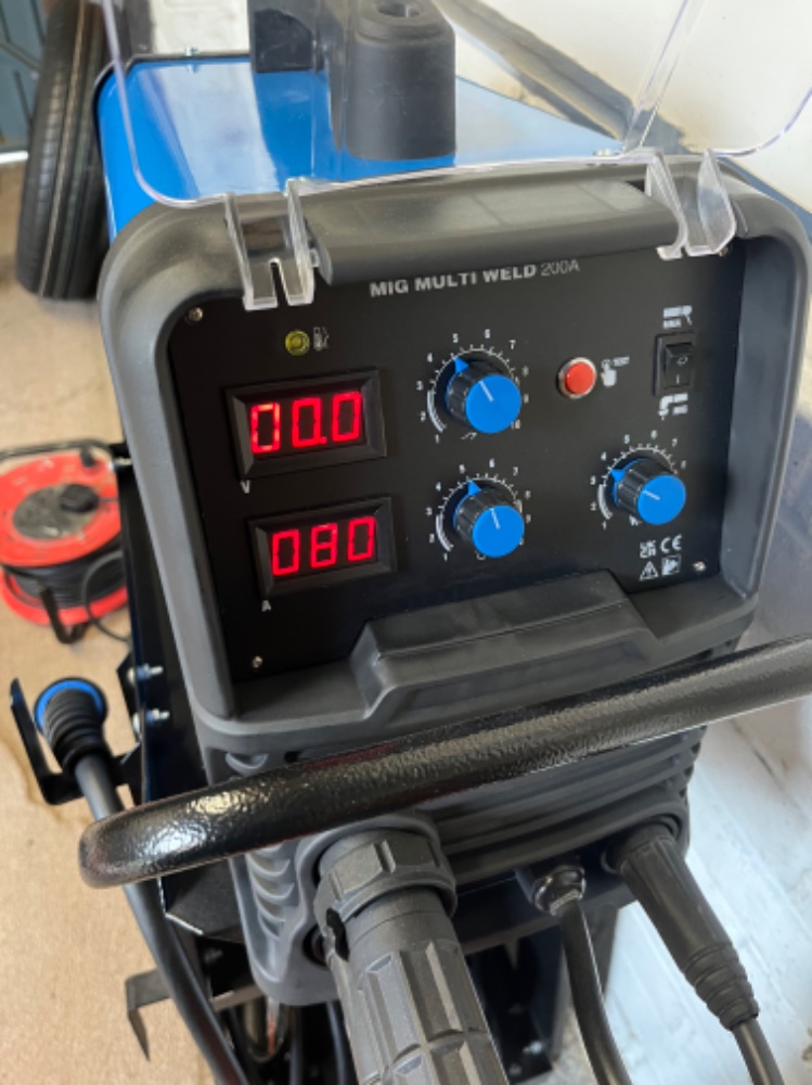

+1 for this...it's exactly what I usually do.cut out a slightly larger area than is necessary, and use the non-rusted part to fine tune your settings.

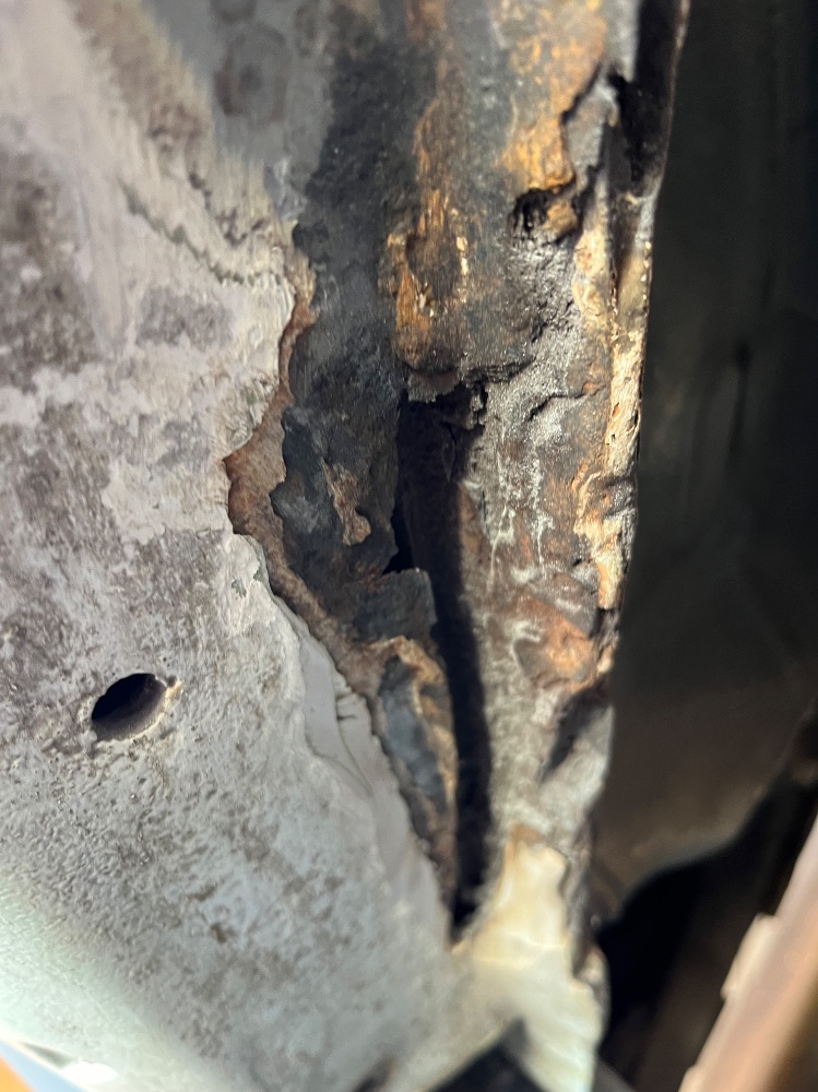

This is incorrect. It's a Ford, cut through the roof pillars and replace from there down.Hit it with a hammer till it stops flaking and starts bending then sweep up and start cutting. Weld on your 1mm plate edge and lap it onto the thin stuff.
