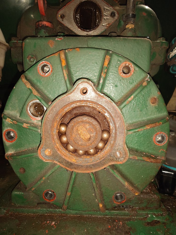

Hi folks,
Anyone have any experience with vacuum pumps used on the likes of a slurry tanker, I'm repairing one used by a portaloo company which has seen better days, see bearing pic...
I've only ever swapped vanes before so this total strip down is more of a challenge, not mechanically, more knowledge really.
Basically it's apart, I've got the correct rebuild kit from the manufacturer. My issue is that there is some faint score / wear marks in the housing where the vanes seal / run. I'm not sure if they're really an issue, or if the new vanes will just bed into them. I'm sure even if they wear a line in the vane it'll pump better than it did with half the balls missing either end...
I did wonder if I could skim the bore but worried it would take it out of spec for the vanes etc.
It's a Battioni Pagani Mec 1600P pump, belt driven by a Honda GX200.
As always, any help much appreciated.
Cheers, Dan
