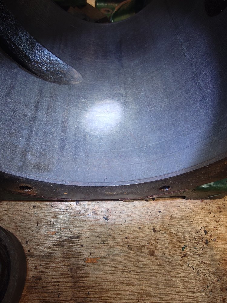

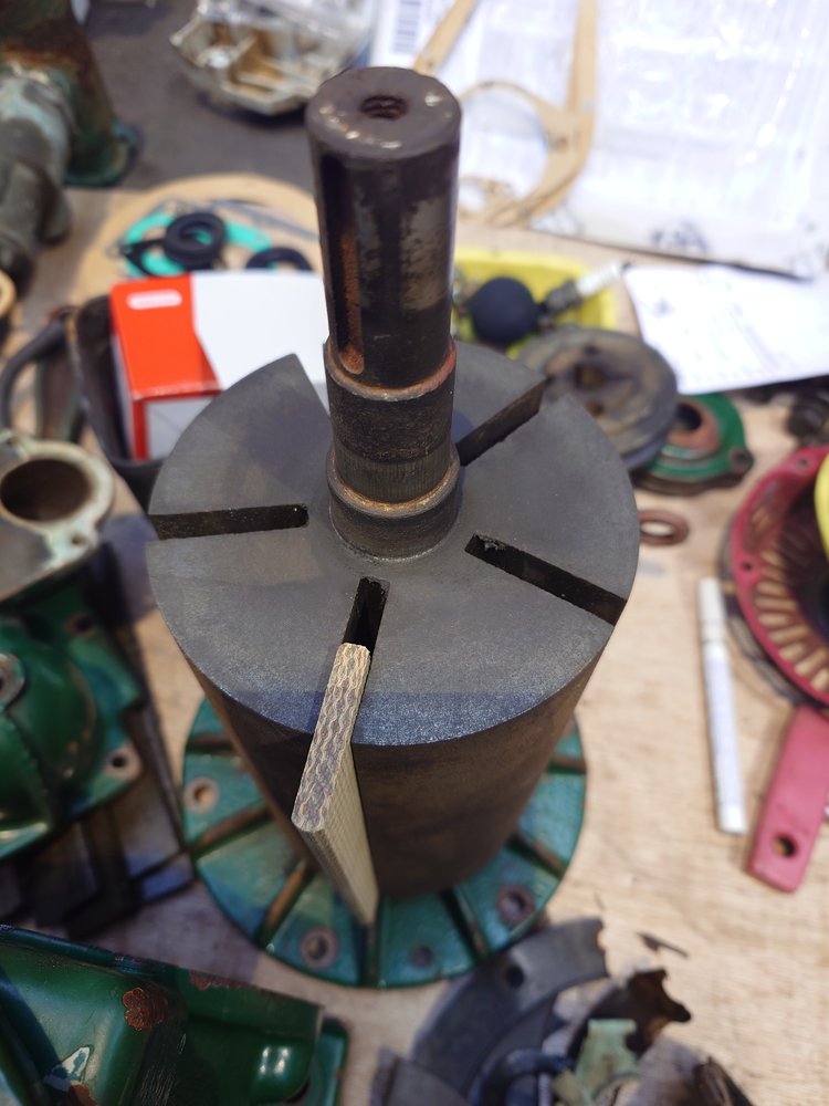

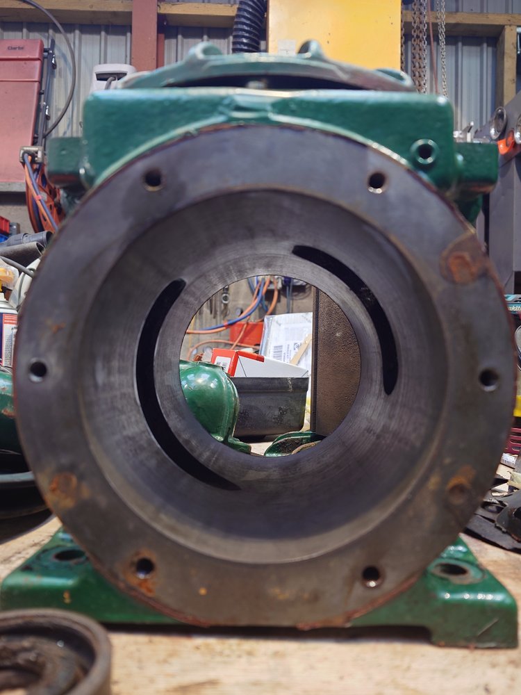

Not sure this has dowels, just a machined register on the end plates.Yes my mistake I should have said furthest away. After boring you should set the rotor clearance by removing the end plate dowels and laying the rotor on feeler strip but I don't normally bother as they are quite a rough old pump.
