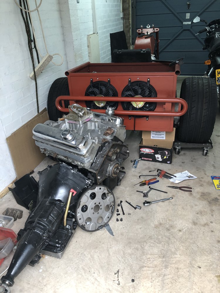

Progress is progress.About 3 hours work since Xmas….![]()

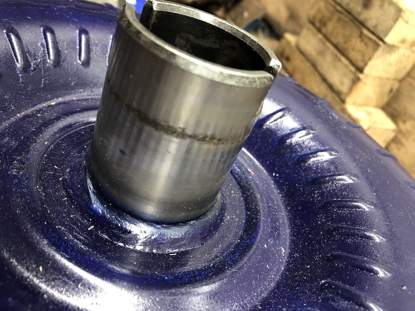

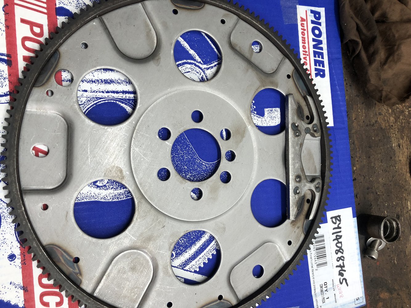

Real Steel are real people, nice and friendly, or they were last time I dealt with them.Having dropped mentally and emotionally to new depths recently I had a revelation today, an epiphany maybe, and I picked up the phone to Real Steel and ordered a torque converter and flex plate, and when it arrives I shall bolt them all together and start work on the trike again.
I had nearly ordered them from the US a few months back, as many people told me it’s far cheaper than Real Steel, but with the purchase, postage and packing, import duties, VAT etc etc it would have been £150 more expensive to buy from Summit or Speedway.
Yes, I called them up and spoke to a really helpful guy. I even joined the Gold Card club, saves 10% on anything I buy.Real Steel are real people, nice and friendly, or they were last time I dealt with them.

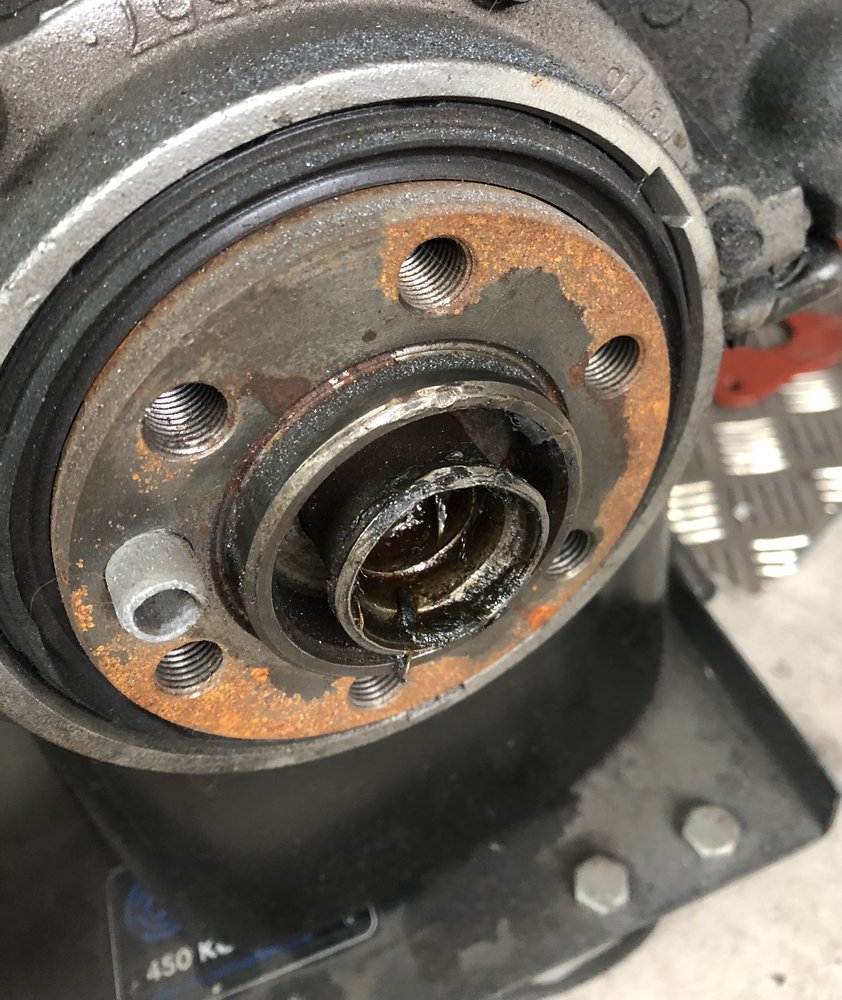

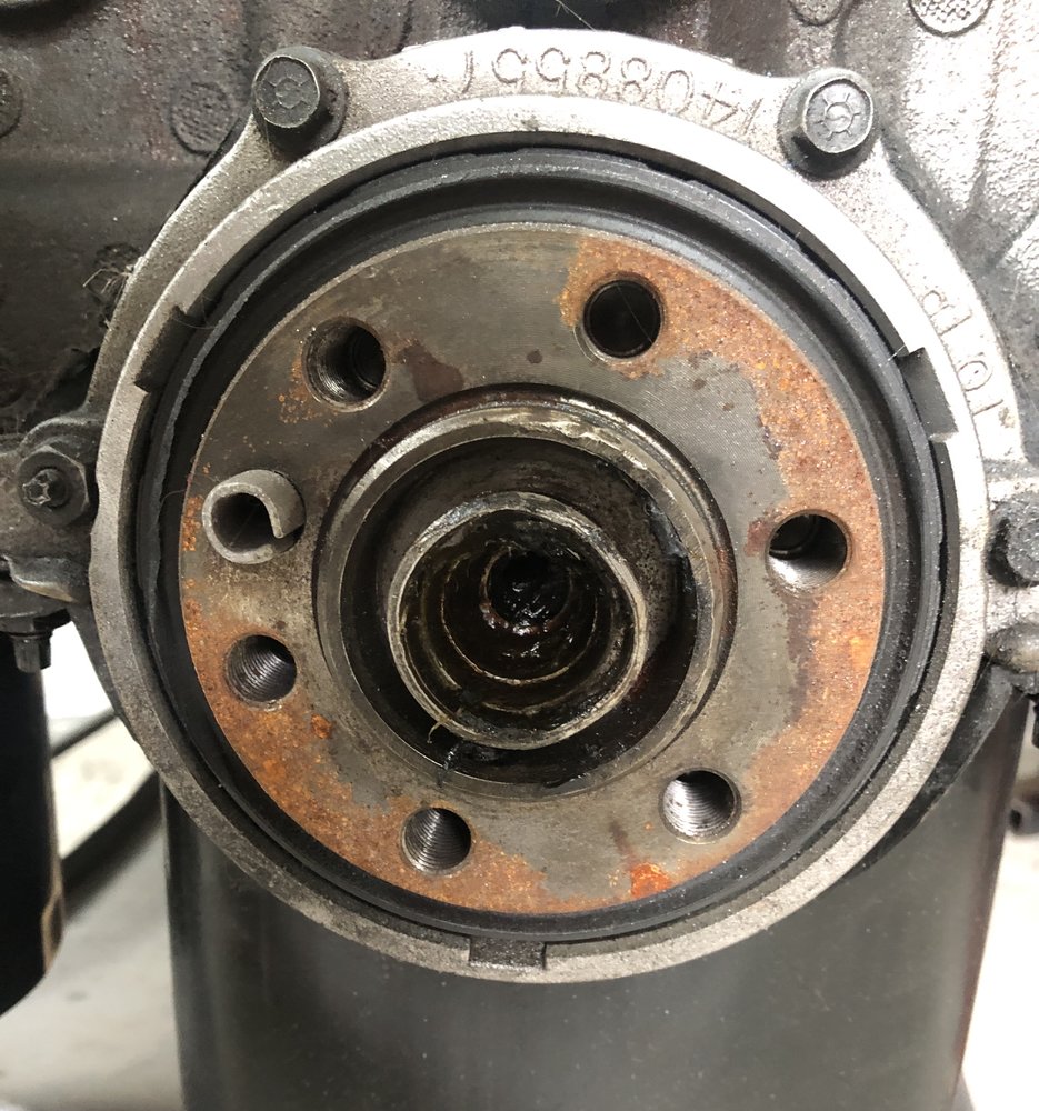

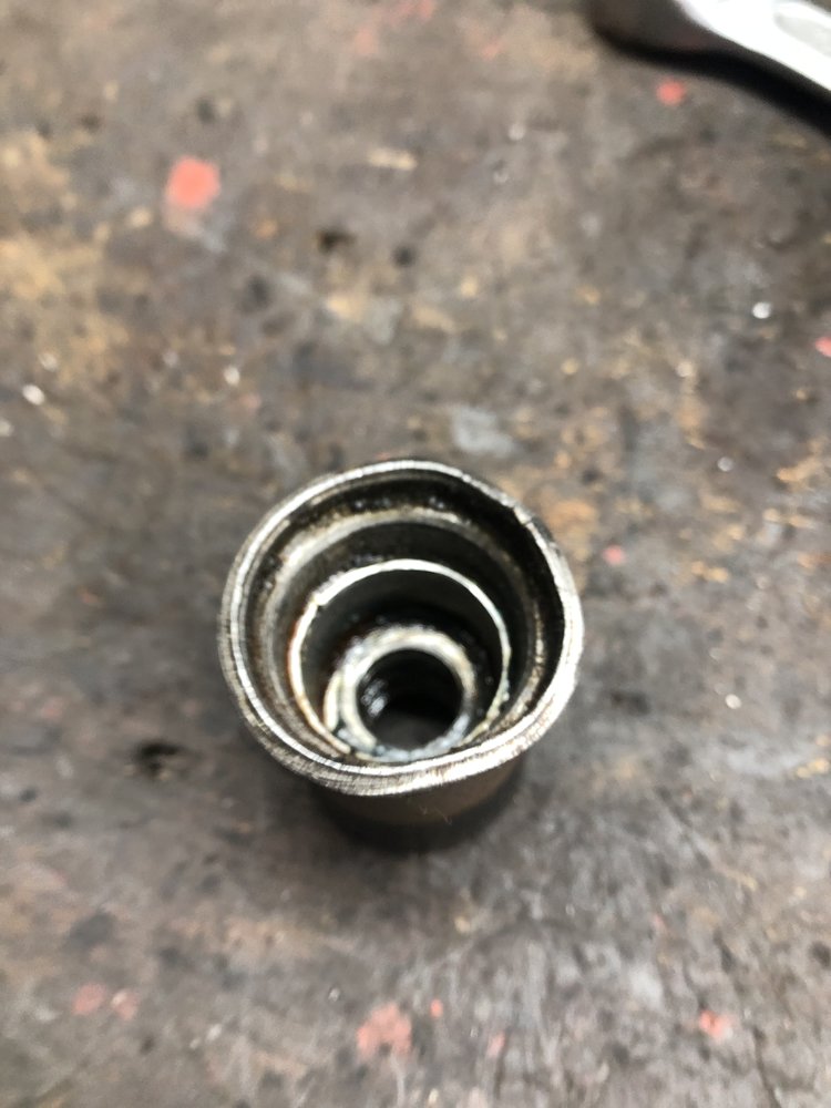

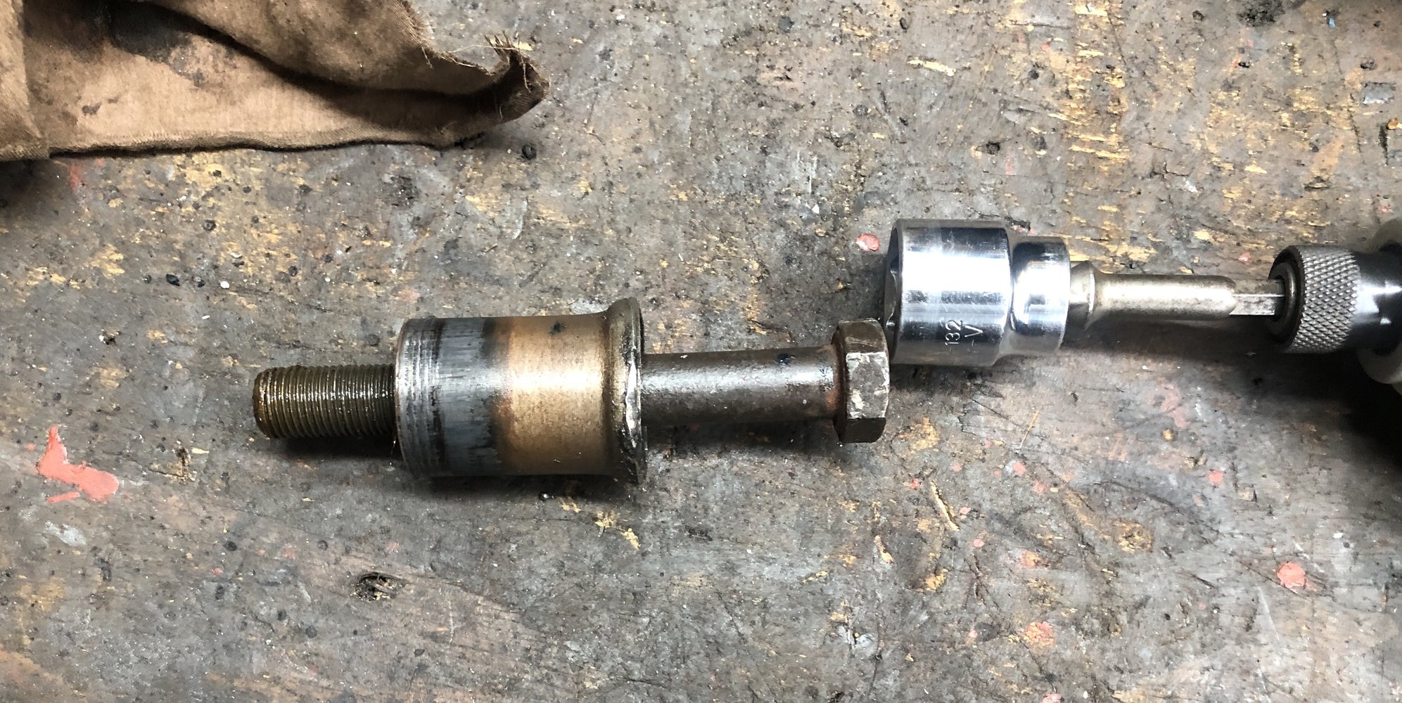

I had a closer look at the back end of the crank today. There’s a small abused looking piece of tube poking out. I’m assuming it’s some sort of pilot bearing that was codged up by the previous owner, who had it in a rear engined kit car.
I’m thinking I can weld a piece of bar to it and make a draw hammer, to pull it out?
Usual way is too pack it with grease or bread and a tight fitting drift/punch too force it out
Well done on the win. Glad to hear you're back on this - can't wait to see the progress.this little garage win has restored my outlook on the world.![]()
The guy was an enormous body builder, so that might explain it.did the last owner fit the gearbox with a sledge hammer or something?!
that bush thing didnt half get a beating!!

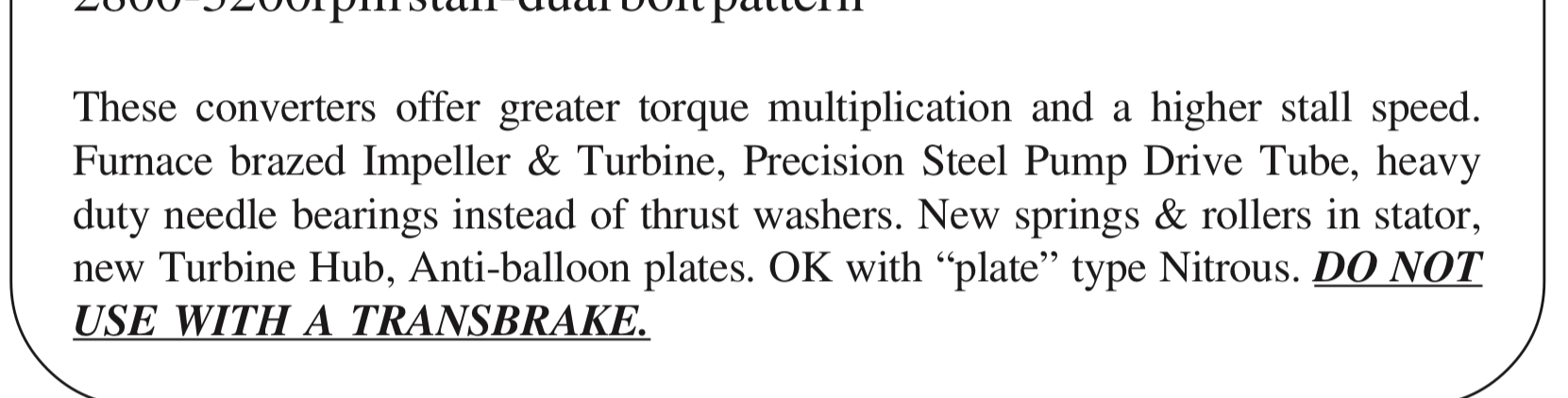

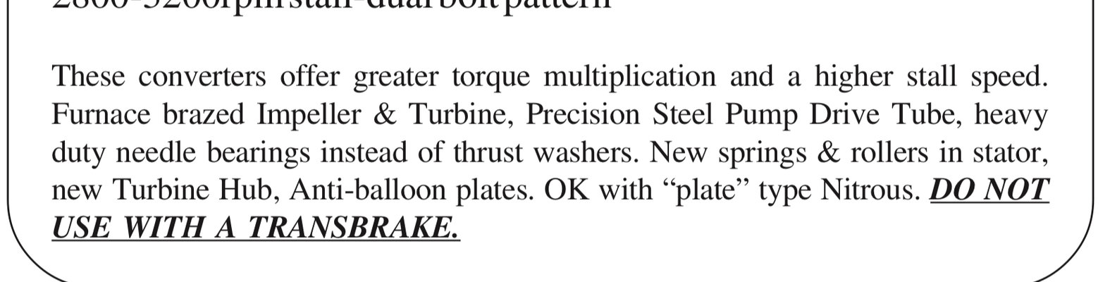

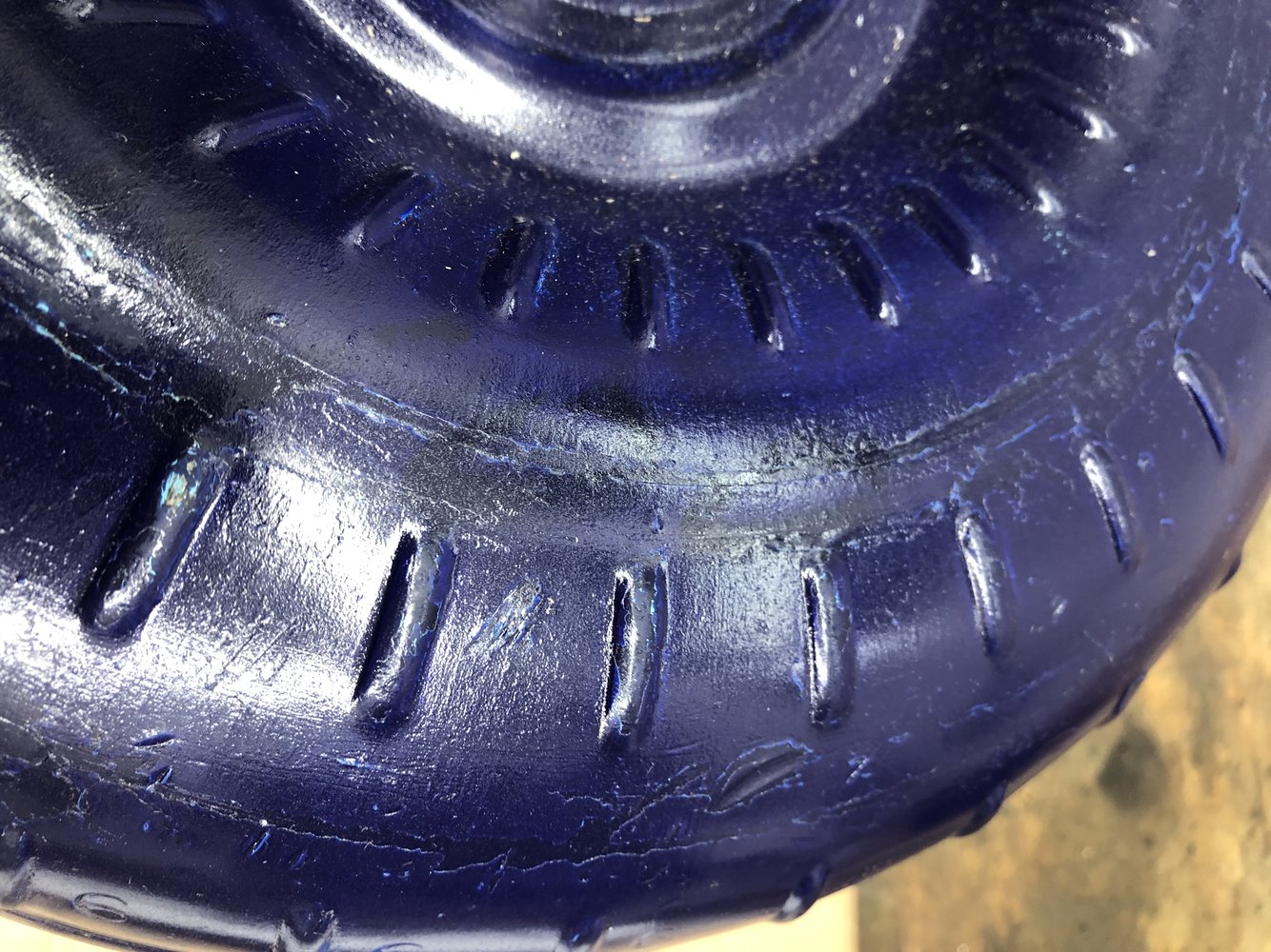

I’d imagine they simply cut old ones open and rework the internals. I just saw on the Real Steel web page it does say something about having new parts installed. GM built over 100,000,000 of them, so it would make sense to utilise existing casings.Don't know anything about Chevy Engines, just a bit about Ford small blocks and 351C and 400M.
I heard a long time ago that B&M do not manufacture, but remanufacture. Don't know if this is true, but that certainly does not look new to me.
