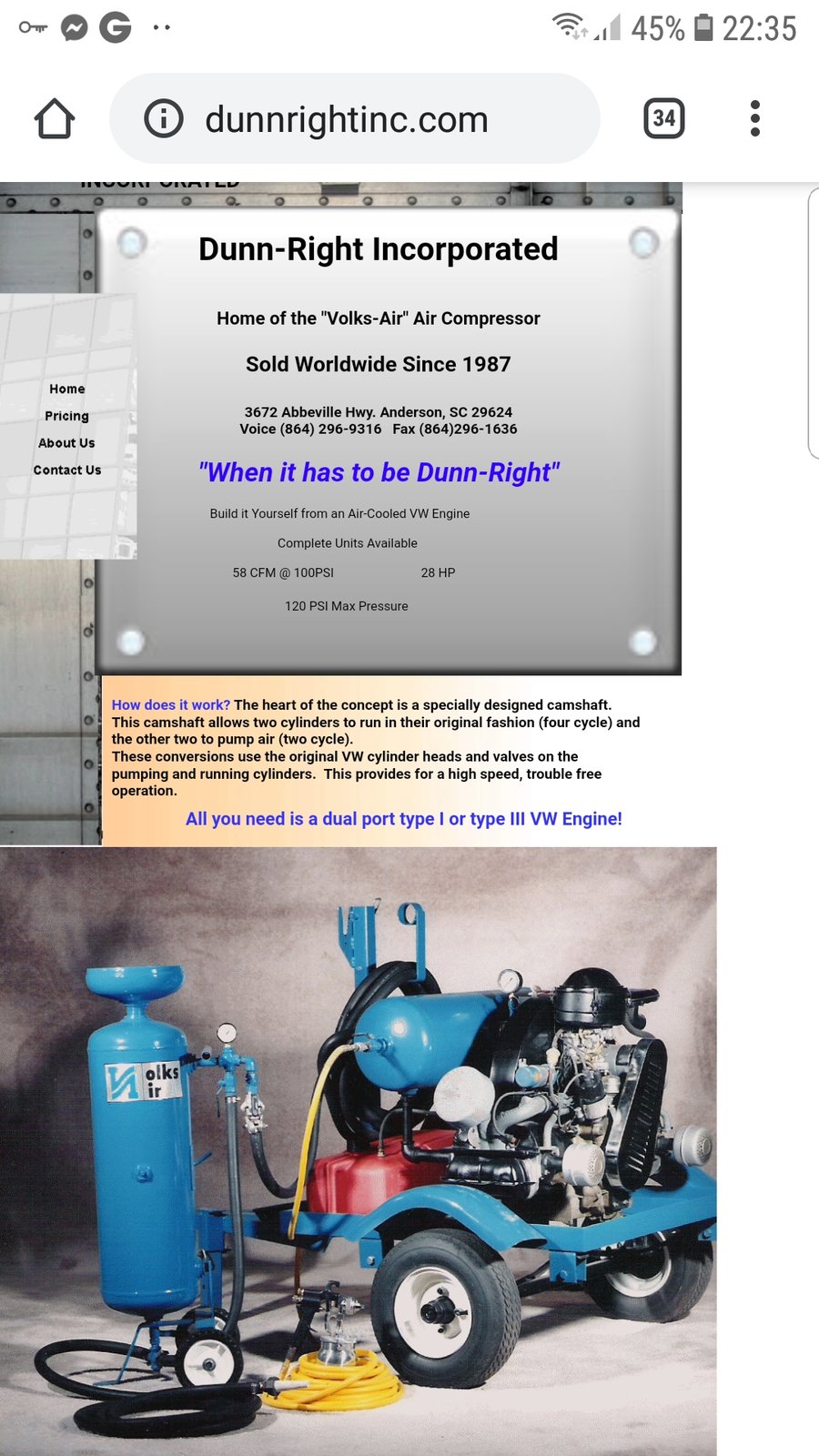

I thought I spelled it out above - flat head, spring loaded poppet valves instead of using the cam - sigh....
Has anyone tried this? The Americans used V8 engines, one bank running normally for power, the other purely as an air compressor, no fuel nor sparks, as a air supply for surface supplied air scuba diving
I'm sure there's lots of reasons why it's not done, but it's an interesting concept, well, to me at least.
I do not claim to know how scavenging works at a fluid dynamic level and the effect of swirl in what is effectively a shock wave but I do know it is critically important in the design of a cylinder head. The system is optimised to use that feature to both generate pressure and evacuate the cylinder. A makeshift compressor assumes the volume of air will simply be pushed out due to the displacement of the piston.
This is a commercially available kit, looks impressive for a small package 58CFM @ 100PSI !
serious kit, uses a redesigned cam
