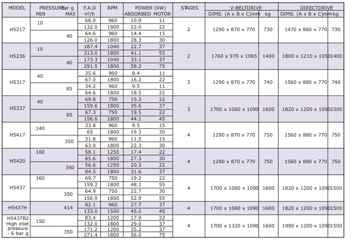

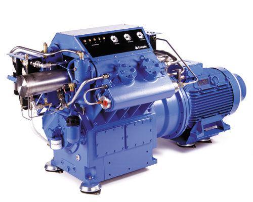

I think that's how the dive compressors mentioned above work although I think they have a lot of coolers between pistons and possibly the pistons are varying sizes?
Yup, 4 stages are common. 1st stage is normally a big high volume cylinder and getting progressively smaller with cooling between stages, but this is for high pressure compressors- 200-300 bar. for low pressure and high volume you'll need to run in parallel with as much swept volume as possible.
