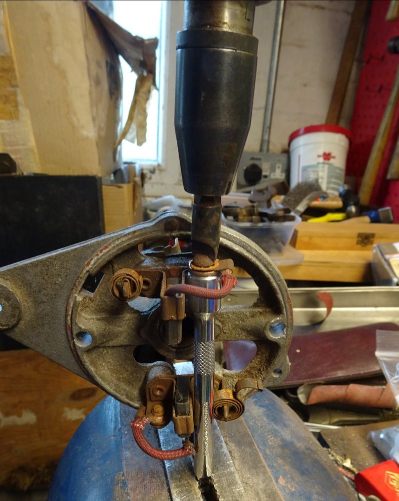

I’d give my left ball for one of those. Finding them at sensible prices however….I wanted to share with you an aircraft engineering tool. It is not something that needs to be thrown out - far from it. When removing fasteners from aircraft panels, this tool is worth it's own weight in gold.
It's called a Brutus Bar. This link shows one you can buy, but they were generally shop made. I have never seen them used except on aircraft.
Brutus Screw Extractor #8 to 1/4″ – Aircraft Engineers Store — UK
