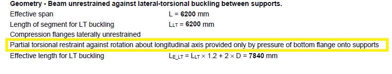

The reason for them according to the SE:

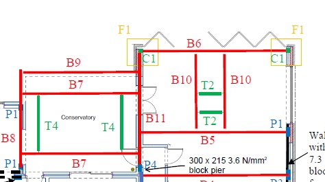

I was forced to intervene while watching a so-called welder our builder had brought in during the knock-through of the next door bungalow we bought. One beam had to be welded at 90 degrees to the other to support the roof. Even when working on the floor welding angle cleats to the beam, the 'welder' was making a mess - I wasn't about to let him do any positional welding.Worrying how much "structural" welding like this goes unnoticed and then covered up
It'd be interesting to know how many structures are being held up by nothing more than a bit of tacking between the beams.
joiner . Its put together like its made from wood.Hi, I have to say that I find it odd that the beam is between the columns rather than on top. Why has the architect and structural engineer not decided that it could be easier or safer when they could be dealing with an unknown quantity (the builder) to finish their vision or calculations. After all it doesn't save any space constraints it also removes reliance on the fixing of the two together. I realise that it could be seen as pandering to the lowest common denominator but you have to work with what you've got. Or is there another building type principle at play here?

. Much prefer arc welding on the odd occassion I do need to weld something. Would love to TIG weld.Hi, I have to say that I find it odd that the beam is between the columns rather than on top. Why has the architect and structural engineer not decided that it could be easier or safer when they could be dealing with an unknown quantity (the builder) to finish their vision or calculations. After all it doesn't save any space constraints it also removes reliance on the fixing of the two together. I realise that it could be seen as pandering to the lowest common denominator but you have to work with what you've got. Or is there another building type principle at play here?
Colin
one other thing.. which may well upset the builder, get the SE and building control to sign off on it before work proceeds, if BC is not happy they can and will make you rectify it before issuing their completion certificate... not having it may make your house more difficult to sell and may invalidate insurance if there are any future issues

I thought you'd be lucky to only have 2mm deflection over 6m as you put before!!!![]()
would an i beam not been better and give less drop ?
