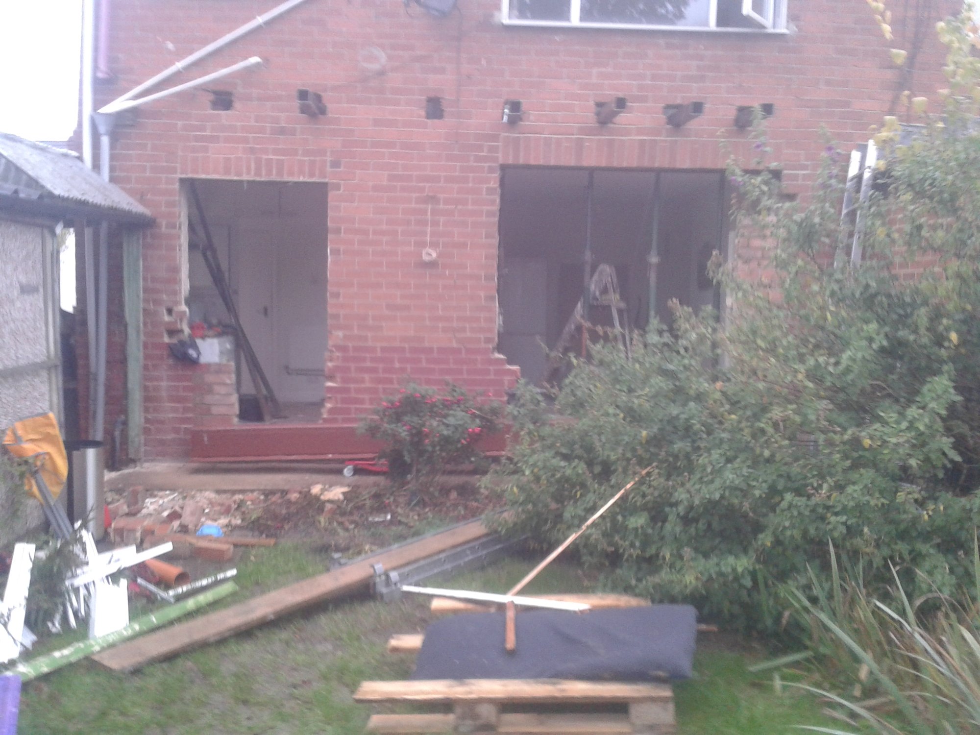

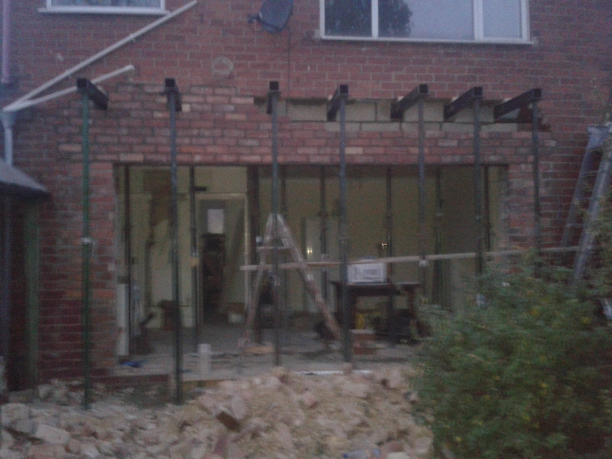

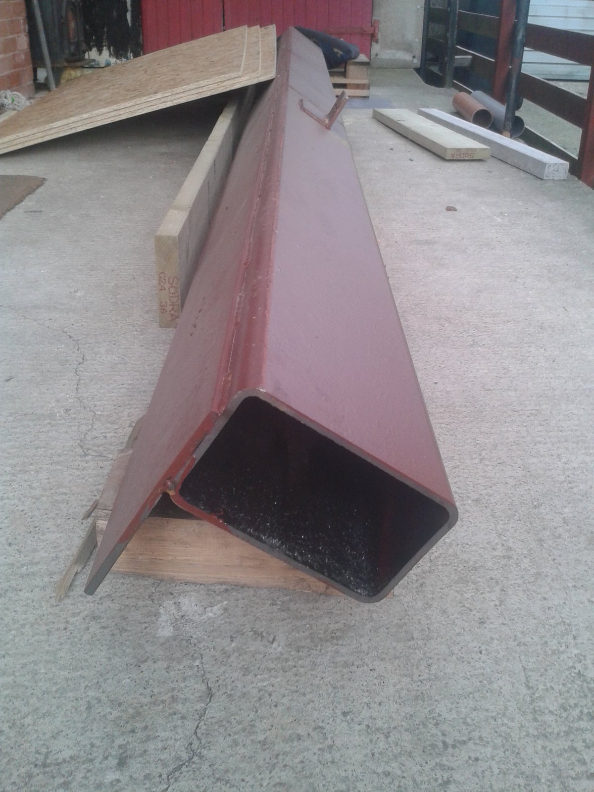

Hi guys, just joined the forum because I'm in need of some urgent advice. Having some building work done which involves a steel goal post for some bifold doors. The beam is a 6m long box section (200x100x10mm) which connects to the posts which are 150x100x5mm. A 80x160mm box section was welded to the posts and the large box section slots into that, and originally hollo bolts were going to be used to connect the 2 steels together. However, the decision was made to weld it onsite instead with a section removed from the bottom so it can be slotted in from abov e and then welded afterwards.
Now the builder has been good otherwise on all aspects of the build, but on this part he brought in a welder which I think clearly lacks experience. I was hoping for some confirmation that the welding done is not up to standard.
Please see attached pictures. I have a little knowledge of welding, and the welds look absolutely terrible. He used a small arc welder, didn't clean the metal before welding. He didn't even bother knocking off the slag, so i did and it looks like there is porosity in the weld bead, it looks inconsistent, it's undercutting in parts, it's definitely not penetrating fully and he hasn't even gone all the way round.
I'll attach a few photos to this post, but here is a link to the full set (mods please remove the link if its not allowed):
https://drive.google.com/drive/folders/1aYt1LhmVwftcxLeJeQKJvC5vMAhuXHDm?usp=sharing
Comments welcome, I should get this redone right? It's supposed to be a structural weld!

I think your missing an even bigger issue, if a structural engineer has done drawings and calcs for the job the builder can't just come up with " a better way " or deviate from the specced method of fixation. This will just make the calc's void and your building inspector won't be a happy bunny never mind the ****e welding.
Quite right. The structural engineer's design is covered by HIS professional insurance. The connections should be specified and followed and you cannot allow the builder to deviate from it. This bit is a problem:
If he did it off his own back the HE just became the designer. If you agreed to allow him to do it then YOU just became the designer. That means that 1. You are no longer covered by the designer's professional insurance and 2. you wasted the money you spent employing him in the first place.
My advice is that you stop work, get the builder in for a meeting and come to an agreement that you will pay for the frame to be re-made to the design and he will pay to fit it properly without any of that truly dreadful welding. You could otherwise ask the designer to specify a welded connection, which he could certainly do, then get a good welder in to grind and re-weld.
Replacing a bolted connection with a welded one is a risky undertaking in the first place but doing it with work that bad is simply unacceptable.

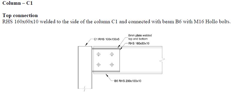

You are absolutely correct. There has already been some back and forth with the SE on other things, but the original design should have been followed in this case.
I'll definitely be stopping work on this part. I will go back to the SE and see if they can specify a welded connection here as I think that's the best option. See attached connection detail. I could still use hollo bolts as per the original design, as long as the bottom part is properly rewelded on, but the problem now is that I don't trust that the smaller RHS section has been welded on to the column properly, so would rather get it all fully welded now.
I spoke to a friend who is a fully qualified SE and he said that a welded connection would technically be stronger provided its done correctly. It is supposed to be a moment connection which will not allow for any movement. This allows the frame to be rigid and not 'parallelogram' as it were. Any lateral forces should be transferred down the column and into the ground. Makes sense.

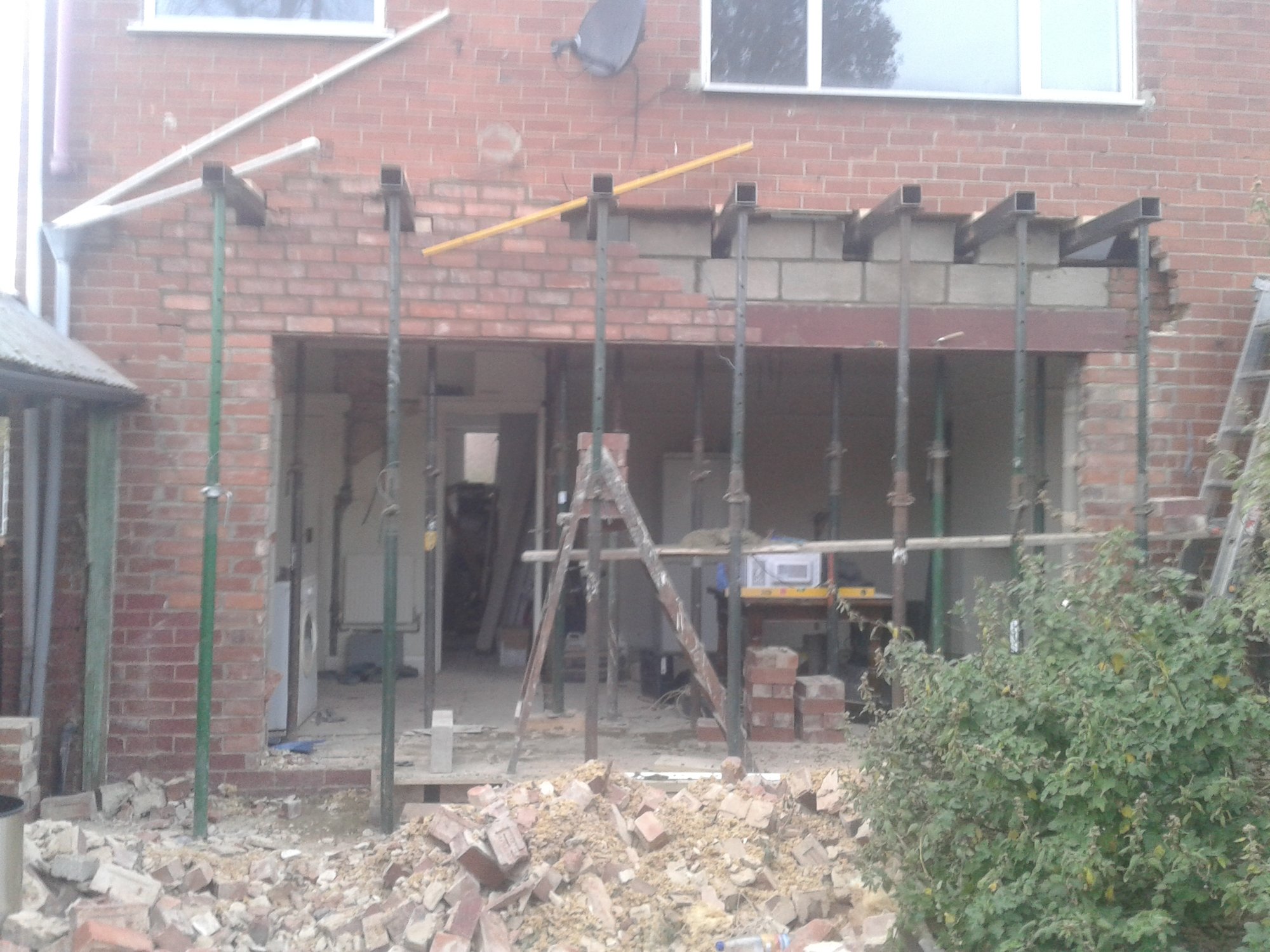

He wanted to do it this way so he could set the posts in concrete first and then build up the brick wall to DPC level on the sides as its faster and cheaper than having to get a crane or slotting in the column from the side.
A crane how high up is it? are the bi folds not on the ground floor?
