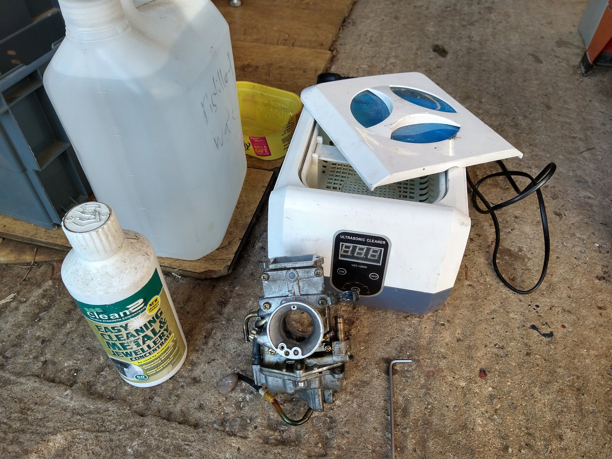

intrested in what the guys who do carbs are using for solutions, I'm back to just using demineralised water again, tried a few of these so called dedicated products, even some of those kitchen products and either they do very little, or end up with furry white carb bodies afterwards. I run mine at 60°C, and to date water is the only one that i have confidence that doesn't damage the carbs, there must be others that are more efficient, as I normally do three or four runs through the tank to be sure. Recommendations please...
elbow grease in poundland but meny more places and i only use normal tap water and dry with air compresser
, had a look at poundland, won't get that locally here. I already degrease with the degreasing tank to take off the really heavy crud, then a blast over / in with carb / brake cleaner, but the real works done by the ultrasonic. I use demineralised water, thinking it will have most of the "potential solid by-products" already taken out. To be fair the water does a decent enough job with minimal risk. some of the other stuff has turned the alloy very dull grey, or leaving a white furry residue, if that's what you see on the outside, you can only guess what it's done to the miniscule little passages in the carb body. Just wondering if there's a better option (faster)
