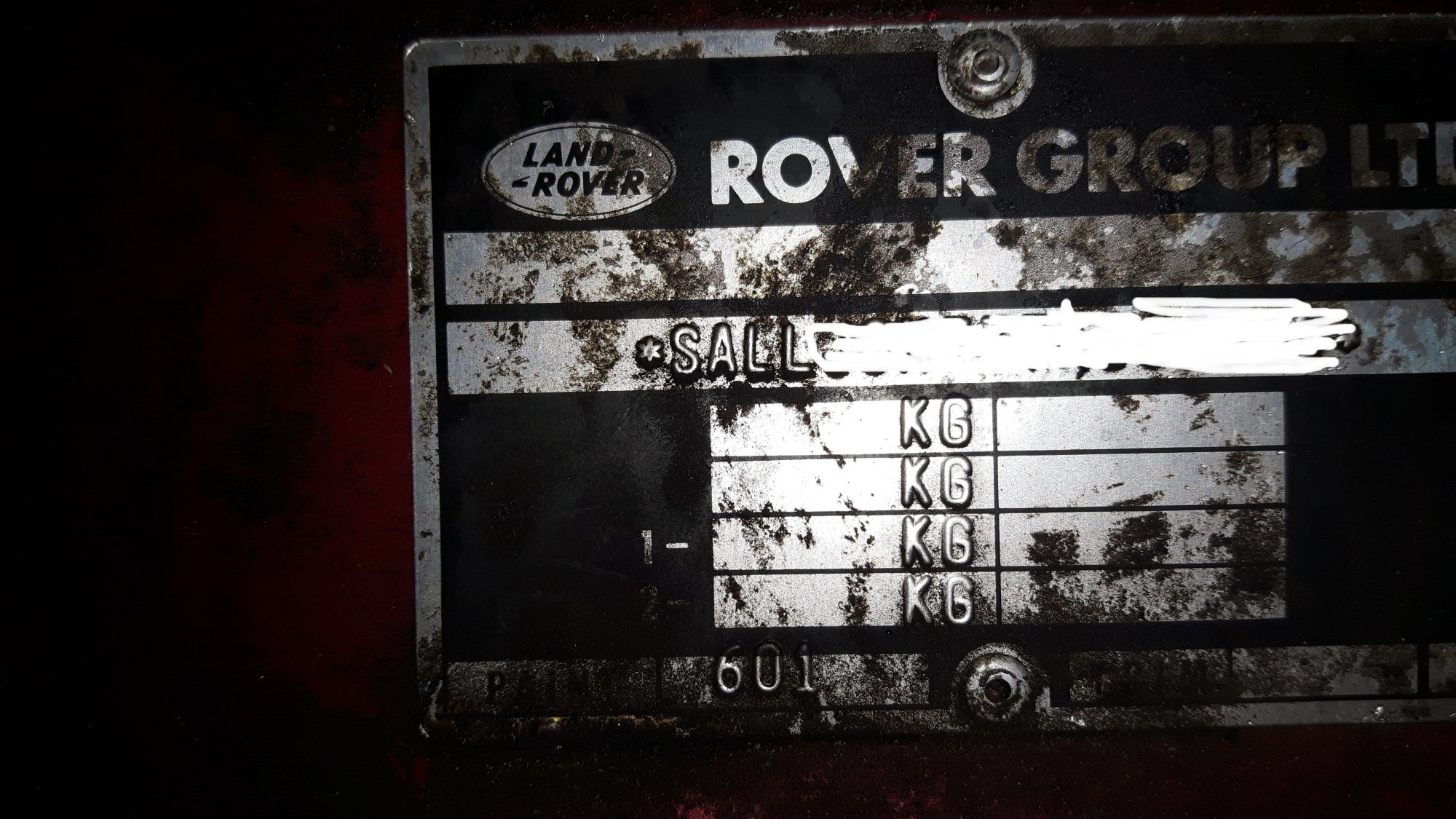

Same as me with my jeep, just use it and don't take the p*ss and the police will just ignore you as they don't want the hassle trying to work out the paperwork on such an old vehicle.So how do I stand with a 1950 pickup?
The bulkhead plate in my series 3 says:View attachment 112268
just sent this to tag you re above post.It says should not as there are some that can still tow without it on the plate.
Where a Must not would stop all vehicles.
Vehicles that pre a date I think in 1980 but cant remember for sure.
