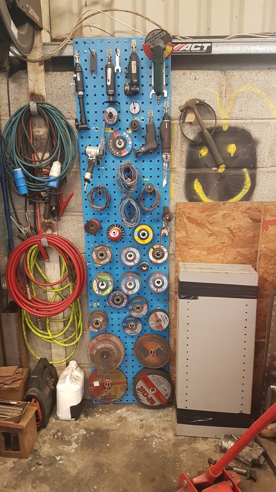

I can get cutting discs no problem it's the grinding ones I struggle to source
Anyome tryed the cheap 3 inch electric eBay grinders?
The grinding discs are a lot harder to find, snap on sell them i think its about €20 for 6 of themThanks auto,

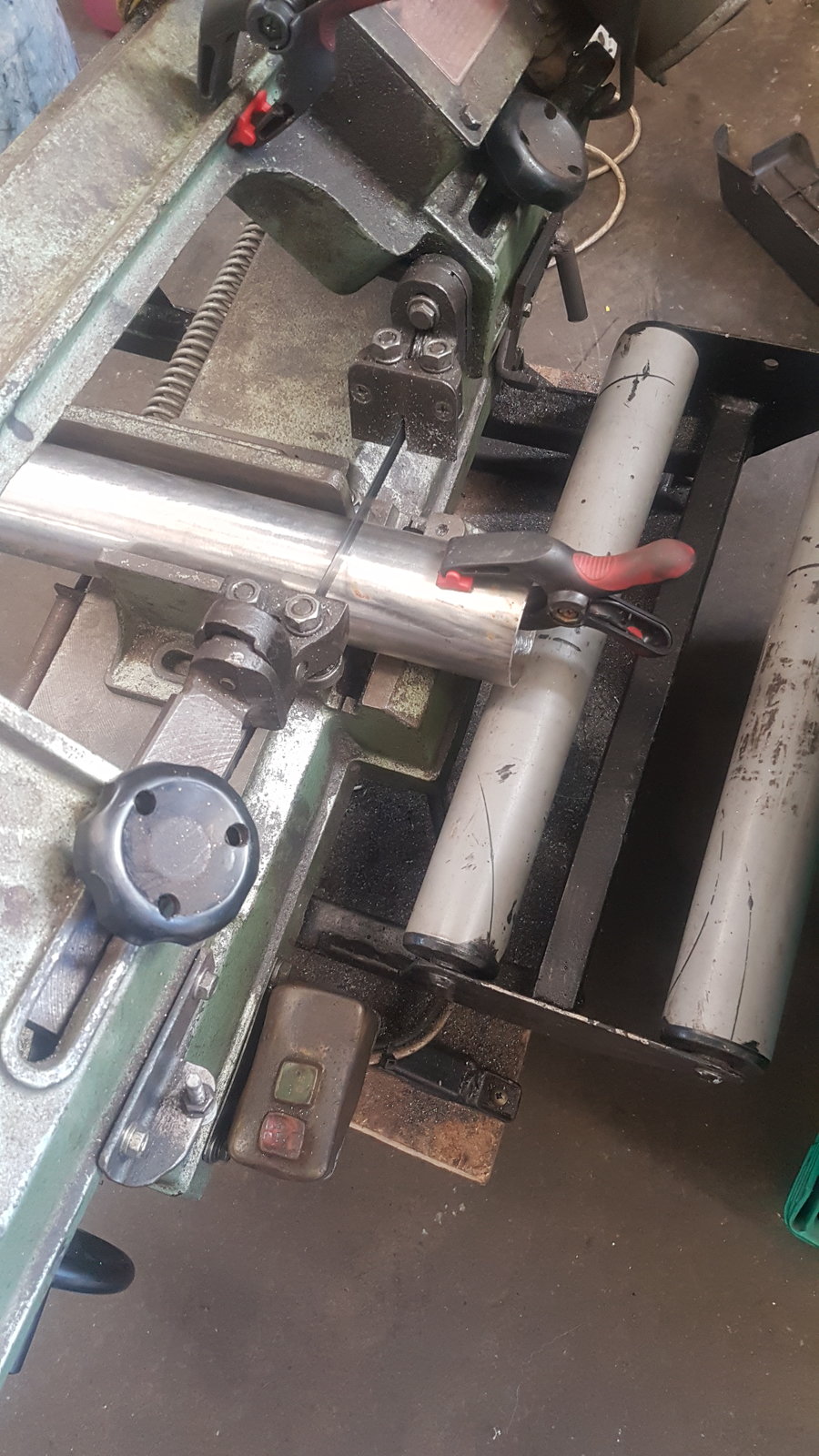

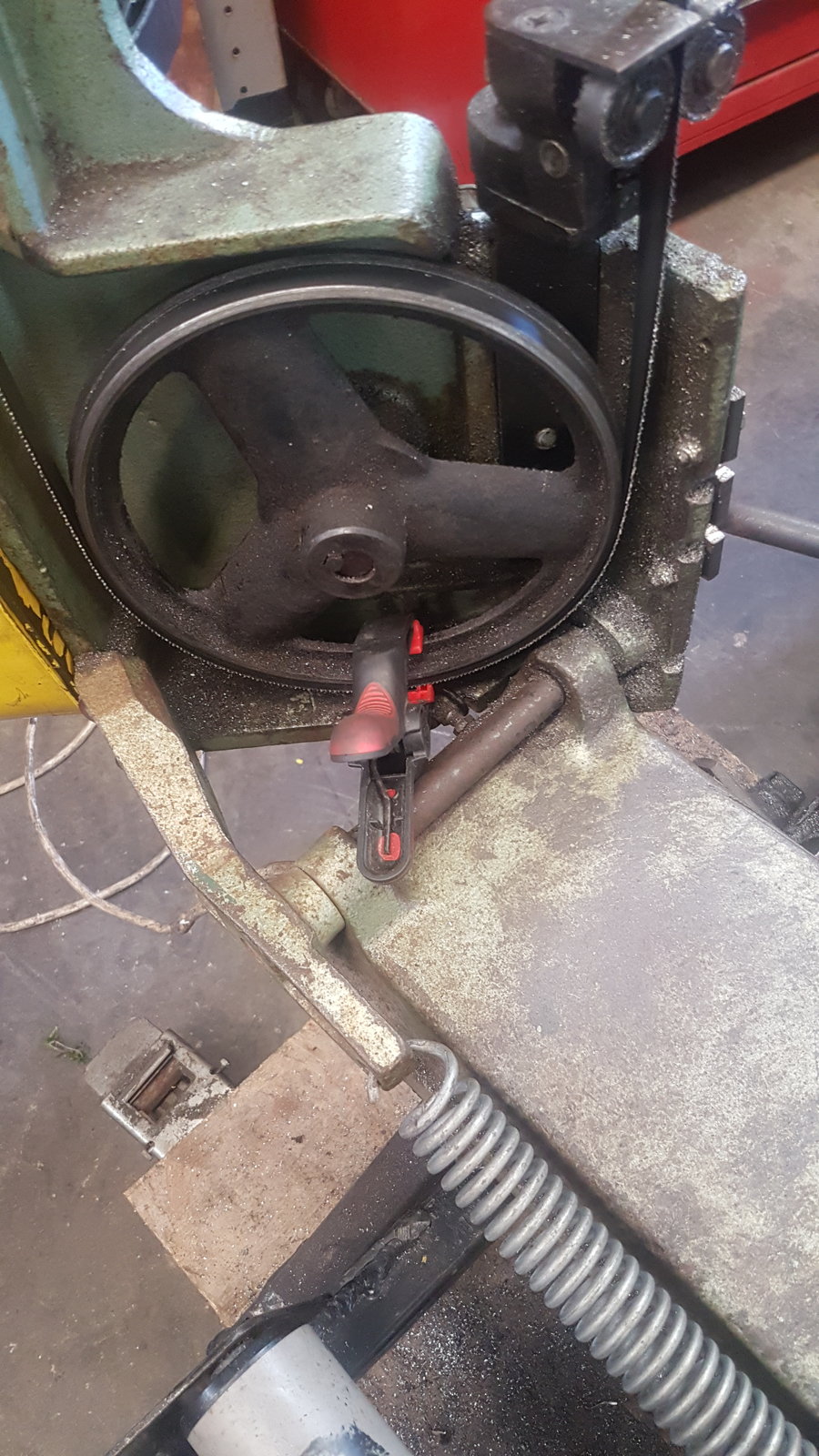

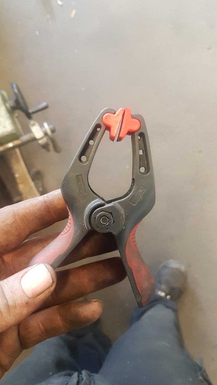

Todays tip. I got these plastic clamps in Lidl a while back, they make a handy extra pair of hands when changing blades on the bandsaw.
They also work brilliantly for taking out that really annoying ringing noise you sometimes get when cutting thin wall tubing. Just clamp one onto the piece you're cutting and the noise is gone
Those clips can really fly if you are not careful!
