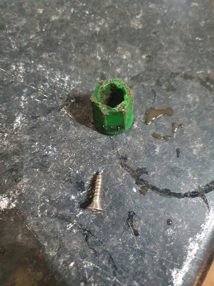

Probably. Even human hair will do, or sheep's wool. Or, as Welderpaul suggested, PTFE tape, but don't wrap it flat. Let it "crumple" a bit, as it's being wrapped.Would dog hair work, I've loads...
They're a quarter turn.Sorry to state the obvious….have you opened a tap in the house to allow air out?…Did you count the turns when closing outside valve and count opening?
You haven't bought one of those daft outside taps with nrv to prevent back flow instead of a stop Cock have you, they can be a pain.
Mines not though it looks like itThey're a quarter turn.
String .... has got me out of trouble.Where do you buy gland stuffing at all? Where do you buy gland stuffing at 8pm of an evening?
A suggestion of a likely-available short-term alternative would be helpful here.
Course String might do, animal hair like dog, sheep and human will disintegrate on the thread.String .... has got me out of trouble.
