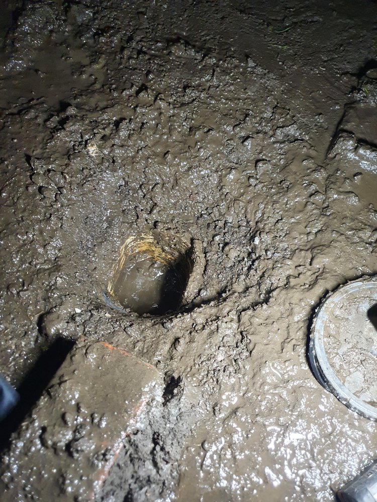

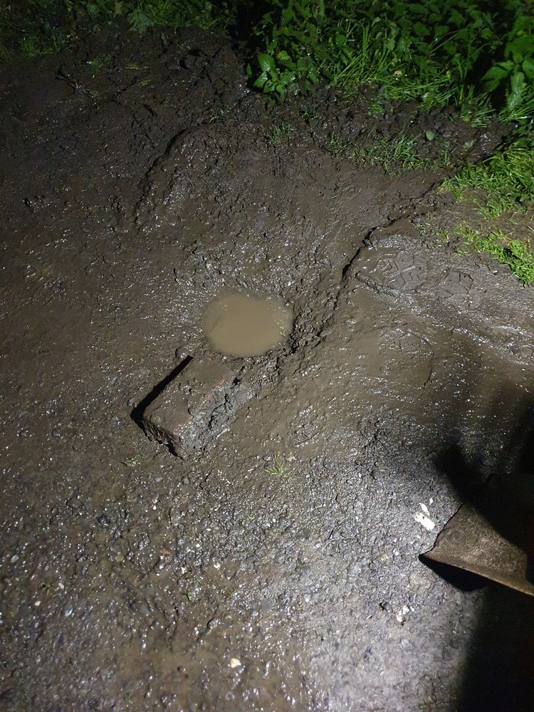

Is it not just the gland on the stopcock that's leaking?
The lady isn't looking at SWA cable?
Some gland stuffing should sort that out.
If it's before the meter, can't you phone up the water board ?
Up to the meter, it's there responsibility ?
No ?
6 pack of plumbers tapeA suggestion of a likely-available short-term alternative would be helpful here.
Thick wall black alkathene, usually 1/2" bore. Tons of it around here on the farms.It's black plastic pipe coming into the house, she's telling me it's measuring 21.96mm
I don't ever recall seeing black in 22mm?
Might it be?
That comes later after a job well done.Some gland stuffing should sort that out.
Pipe jointing compound and horsehair. Most of us on here probably have the first. Parcel string or long fibre cotton wool is an alterative. Undo the gland nut and clean out the old stuffing, work the jointing compound into the horse hair/string/cotton wool and then wrap it several turns around the tap spindle and push into the gland, then tighten the gland nut onto the stuffing. If desperate, vaseline and string would probably work.Where do you buy gland stuffing at all? Where do you buy gland stuffing at 8pm of an evening?

Would dog hair work, I've loads...Pipe jointing compound and horsehair. Most of us on here probably have the first. Parcel string or long fibre cotton wool is an alterative. Undo the gland nut and clean out the old stuffing, work the jointing compound into the horse hair/string/cotton wool and then wrap it several turns around the tap spindle and push into the gland, then tighten the gland nut onto the stuffing. If desperate, vaseline and string would probably work.
Id agree some of our field stuff is old black imperial pipe.Thick wall black alkathene, usually 1/2" bore. Tons of it around here on the farms.
Of course, the adjoining domestic premises use it too, 'cos why not if it's there already.
Bugger standards.
