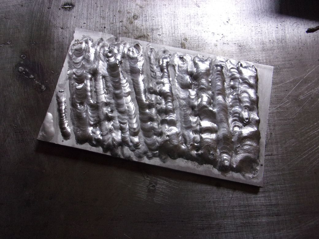

Is your TIG torch plugged into the negative on the welder?
You may find that ESAB reads the balance the other way round to the conventional way. I.e. it’s telling you EN (electrode negative).
what thickness is your aluminium?
For 3mm thick aluminium you’d need about 130-150A just to get a puddle going. Then back off once the plate has become heat soaked.
