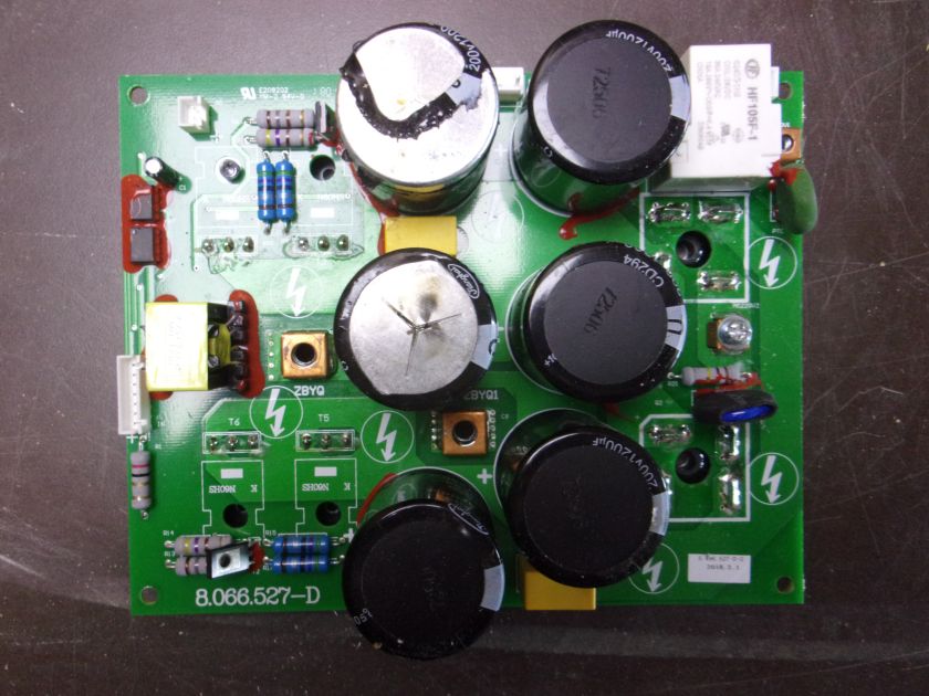

    My TIG welder is a Parweld XTT 202P. I'm completely new to TIG but have been arc welding for the last 55 years. I finally gathered all the kit and materials so this afternoon I was keen to finally have a go.
    I was trying to weld 1mm thick aluminium as a lap joint and tried various amps; I don't have a foot pedal but after a few attempts started to make progress at 40A then suddenly a loud bang followed by a dense cloud of smoke.
    The welder is brand new but sold to me by the buyer who had stored it under his bench for about a year; the warranty isn't transferrable. I came up to the bungalow to allow the smoke cloud to disperse whilst I enjoyed a mug of tea.
    Having now checked and found it wasn't covered by warranty I had nothing to lose; I've stripped the welder pulling out a circuit board containing a bank of 6 capacitors; Jianghai CD294 200V 1200uF two of these had expired big style; I'm now trying to locate capacitors of the same physical dimensions; I can easily buy the 200V 1200uF via eBay. I restored vintage valve radios for ten years so changing a couple of caps isn't going to upsert me; normally I'd just upgrade the voltage but given the many electronics on this machine I'll stick to original spec.
    I'm just posting this for interest because I'm used to such problems; I wondered if any other member had suffered such a problem; as I say I'm new to TIG welding but I expected the machine to be idiot proof which it obviously isn't.
    Yesterday I bought a new Optrel Crystal 2.0 helmet and at least this is absolutely brilliant as the Americans would say it's awesome.
    Kind regards, Colin.

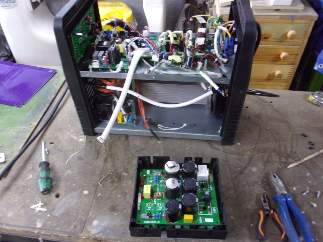

    Two blown caps; easy job to replace them but more difficult to remove the circuit board.
    A smaller circuit board had to be removed to gain access to one of the mounting screws. I took a lot of care not to touch any of the component connections because I'm well aware of static problems.
    The circuit board out ready for the caps to be replaced. This is most unexpected.

    Hopefully it is just the capacitors that are the problem and I can not see how there is anything you could do (welding wise) to have caused it.
    Might be worthwhile replacing all of the caps if they are all the same brand/size.

    Depending on the layout on the reverse of the PCB it might be worth a look at the rectifier diodes.

    As WorkshopChris suggested, I would turn the PCB over and trace the connections around those two failed capacitors.
    Are they in parallel? Are those two connected to the other four? On the component side of the board, to the right, there are two rectangles outlined in white. Are these two bridge rectifier blocks? If they are connected to the caps, a possible shorted diode there would explain what happened to the capacitors.
    The working voltage of only 200 volts is strange. Most inverters rectify the mains straight off, resulting in 325v DC, and the rest of the circuitry runs off this DC bus. This part of the machine is obviously running at a lower voltage ( or the designers were really optimistic when they selected the working voltage of their capacitors...! ). Can you trace where the AC mains input goes, and scout out what components are connected shortly thereafter?
    [ I hope the capacitors have all emptied themselves by now, whether of magic smoke or of electrons.]

    The 200v rating is *probably* because the two that blew are in series so each only has half the rectified mains applied (340v across the pair, 170 each) - 400v rated electrolytics are a lot more expensive so it's pretty common to do that. There should be bleed resistors across them individually too so they discharge when the power's off, around 100 - 500 ohms per volt would work ok, so something over 20K Ohms and fairly chunky, 5 watts or so each?
    The most common cause of that failure is excess ripple (too small a capacitor for the load) closely followed by a failure of the upstream rectifier, AC kills electrolytics, so definitely check the bridge rectifier(s) feeding them! When one fails, the other will follow very very rapidly...
    Interesting fact: a lot of 400v input VFDs (particularly older ones) have series connected electrolytics in the reservoir circuit, some hackers (Guilty!) have been known to move the neutral of incoming 240v to the common point between them to make the input stage a voltage doubler so they can get 415v or more out from 240 in (I'm pretty sure this is what some well-known VFD sellers do when they hoik the prices up a lot for 240 to 415v inverters).It does shorten the life of the capacitors a bit though!

    Another problem with caps in series is voltage sharing. Due to the often wide tolerances on cheap caps it is difficult to ensure that the voltage is shared equally between the two. As they are both already working close to their limit it doesn't take much imbalance between them for one of them to exceed the max voltage.

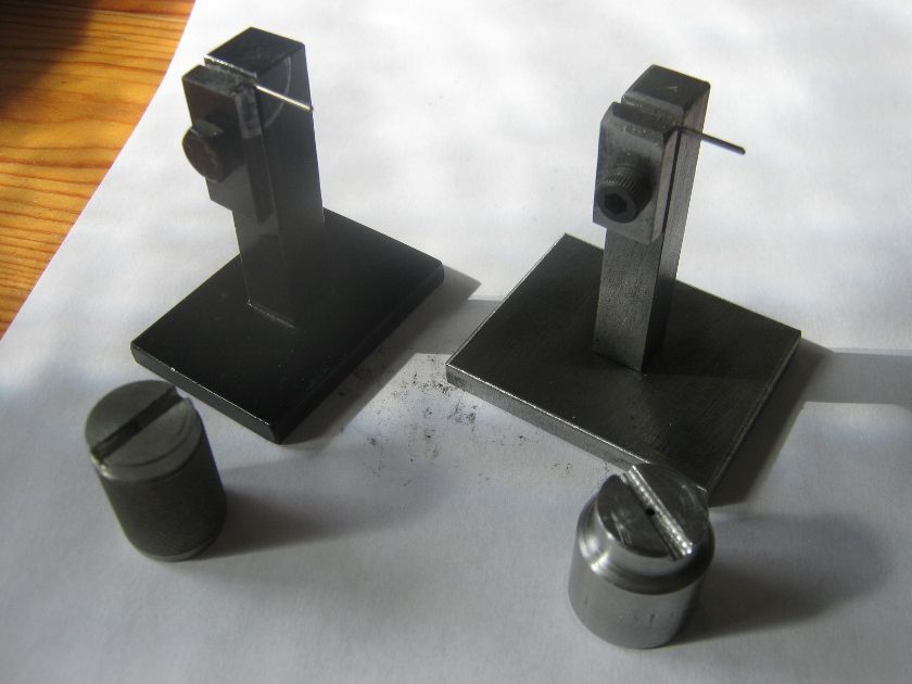

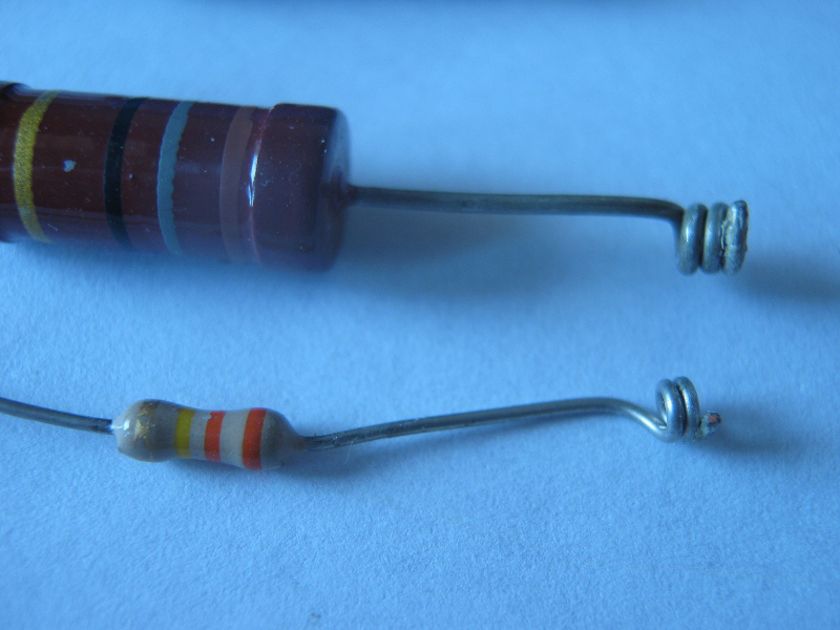

    Out of interest; when I first started restoring vintage radios I quickly found I needed three hands for replacing chassis components like caps and resistors; one hand to hold the soldering iron; one hand to hold the solder a third hand to hold the component. I dreamt up a mini wire winder; I designed and made the winder and it worked a treat; there are many of these now in use; I must have given over a dozen away as gifts. In use I could now snip out the original component leaving two small tails at about 1/4" long each; these indicated where the component had been which was a bonus but with a craft knife I could scrape clean the tails and having added a coil each end of the new component it was slipped into place locating it then only two hands were needed to solder it in position; a very simple solution.
    A pair of my miniature wire winders.
    Components with coils added ready for installation; soldering was rapid without causing collateral damage; lots of these are now in use.
    Here's the top side of the board again.
    Here's the underside; the two rectifiers are seen on the left.

    So under those silk-screened rectangles there are indeed two bridge rectifiers. There's also some beefy power transistors, so this is the main input power section for the inverter.
    Thinking about the fact that this is an AC/DC TIG welder with square-wave pulse capability, it must of course have TWO power buses - one positive and one negative. That explains the two bridge rectifiers. There appear to be three large bolted connections, for zero, plus, and minus outputs?
    Two 1200 uF capacitors in series, the total capacity is halved... would they really do that?
