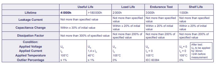

In particular, there is a suggestion from Panasonic that out-of-date aluminium electrolytic capacitors need to have the layer of aluminium oxide on the foil "reformed" by applying the rated voltage through a 1K resistor for 30 minutes.
