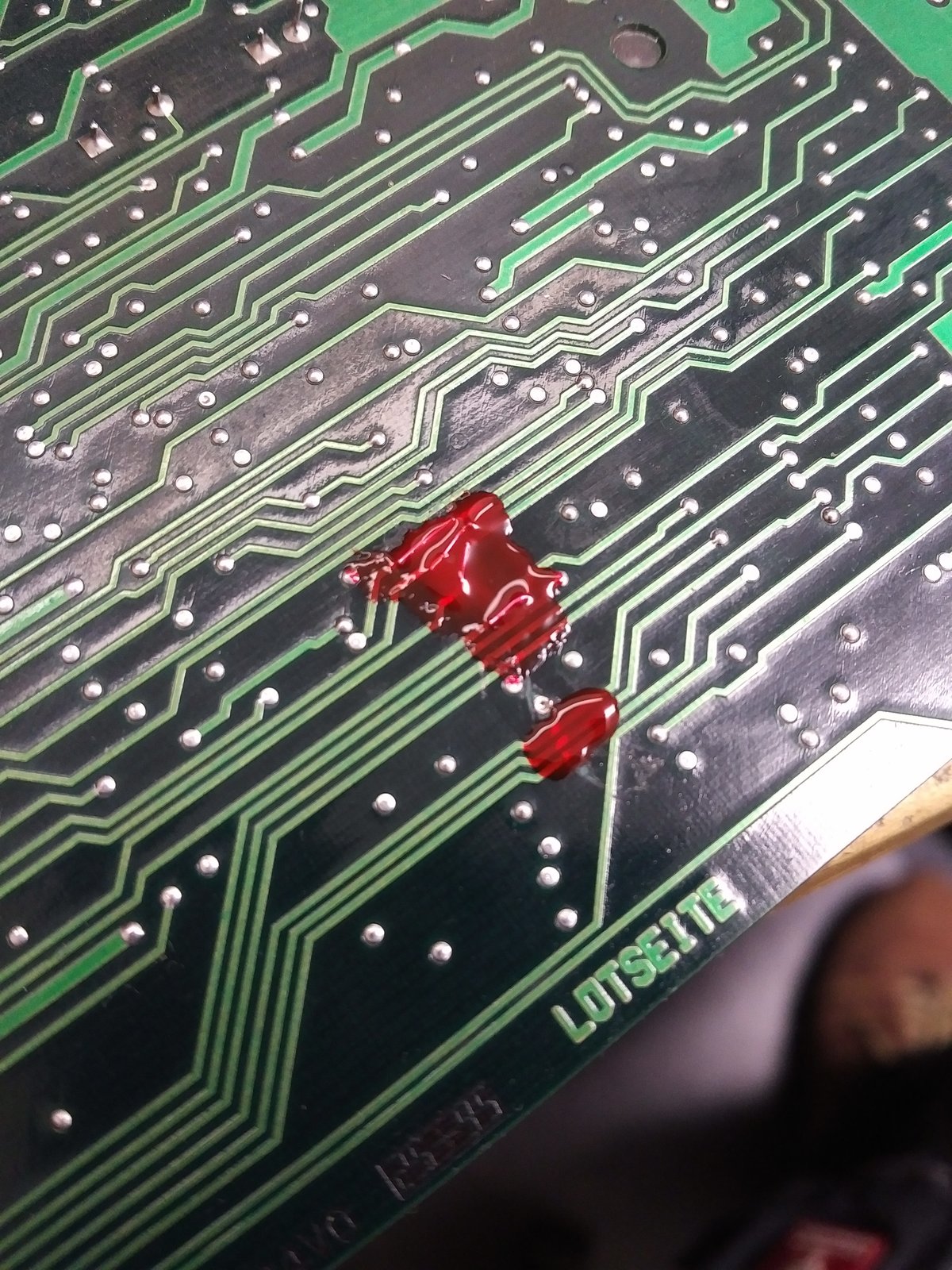

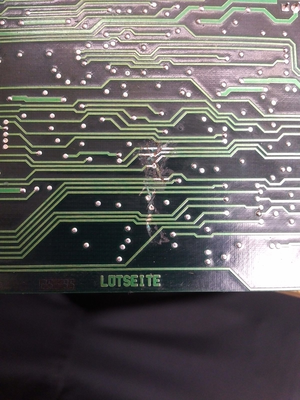

Enough damage that the bloody thing wouldn't power upWhen you said you'd drilled the board I thought you meant you'd done proper damage![]()

Ha ha. Well done. You fixed it.Update: everything works including the lift-arc![]()
Ha, I think nothing. I just switched it into lift arc and fumbled around with the torch switch and touching/lifting and it works.Ha ha. Well done. You fixed it.
What was wrong with it.
