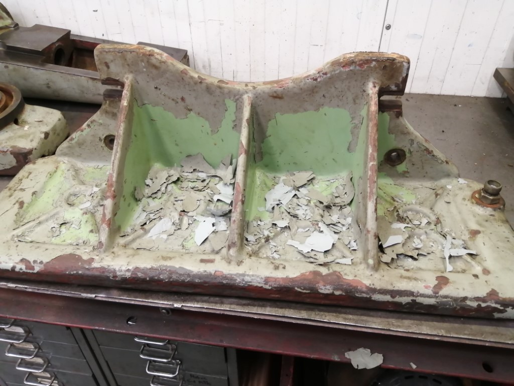

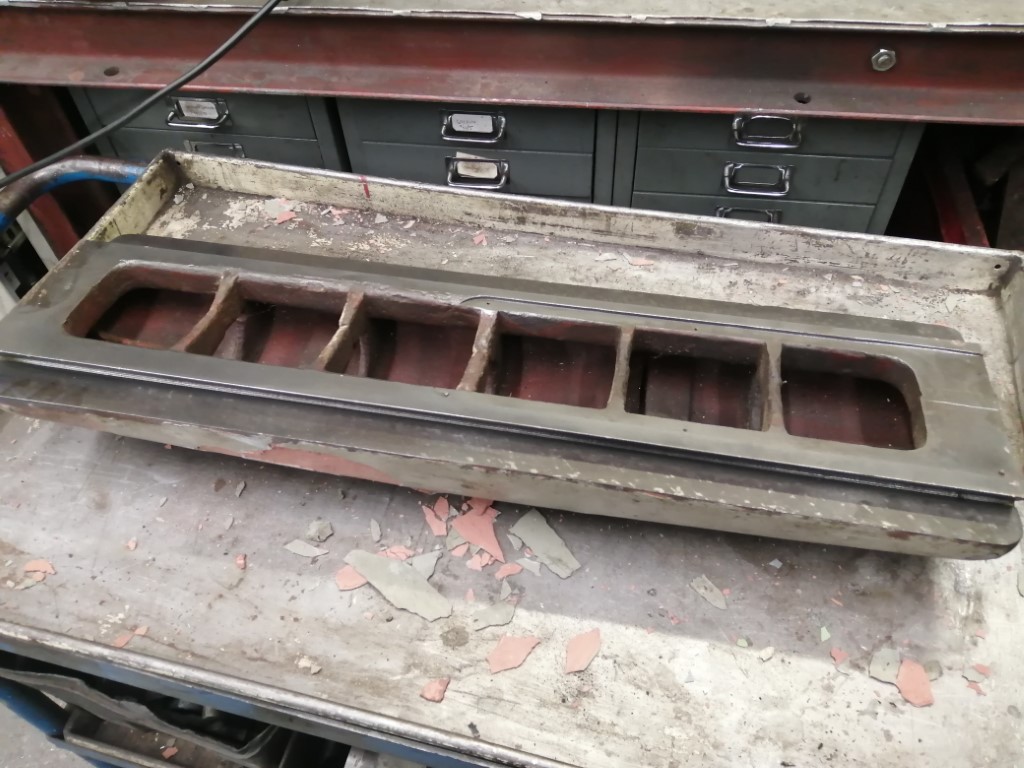

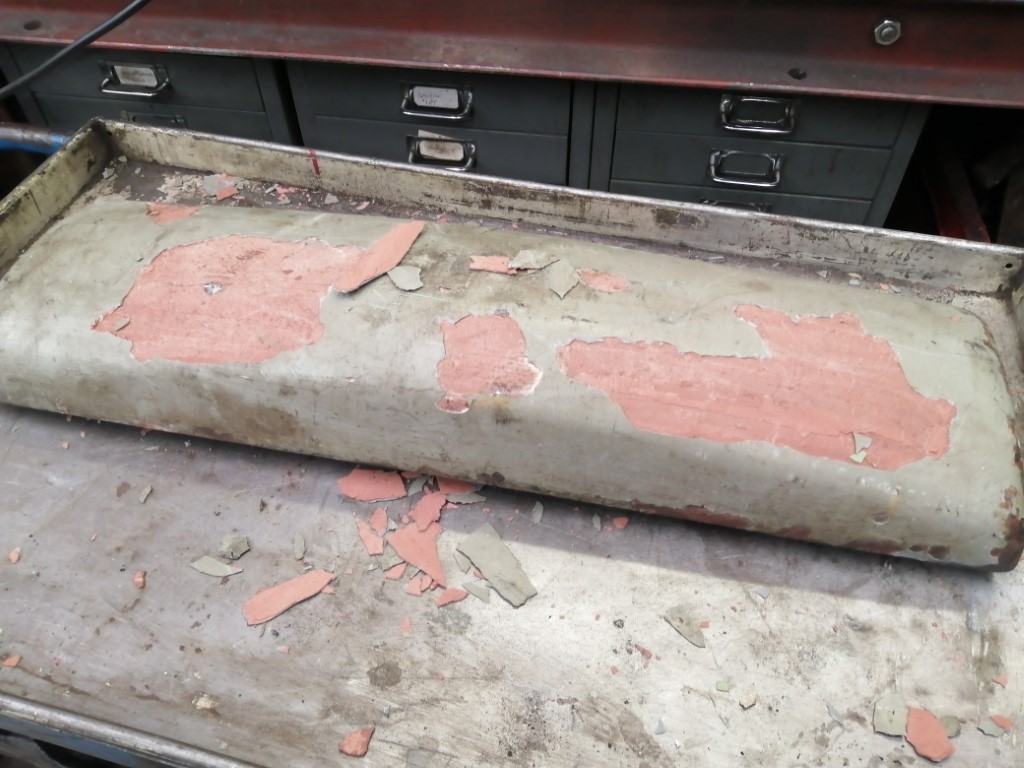

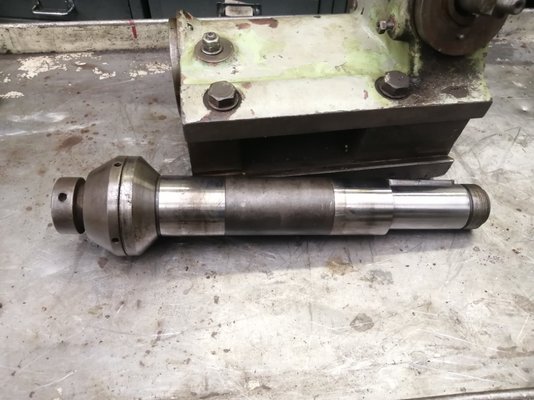

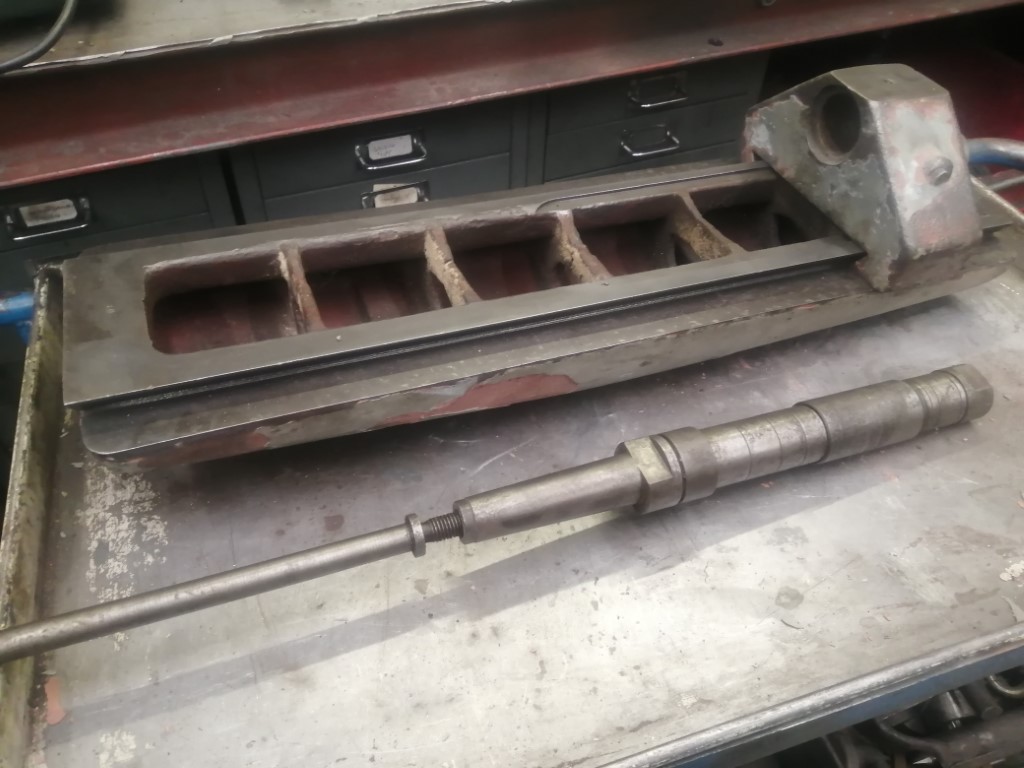

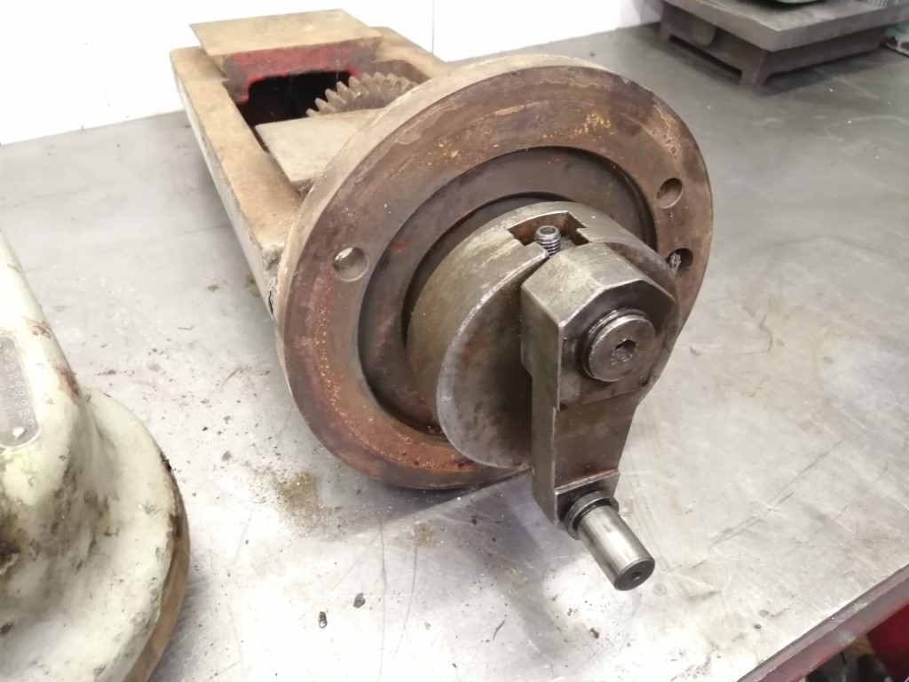

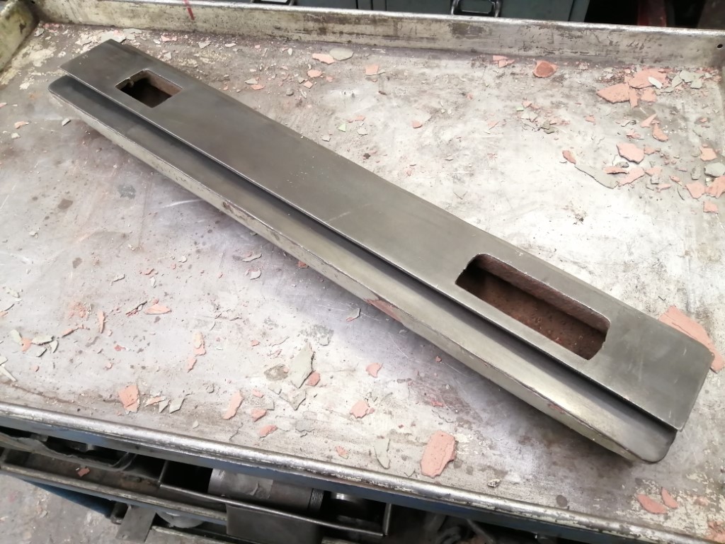

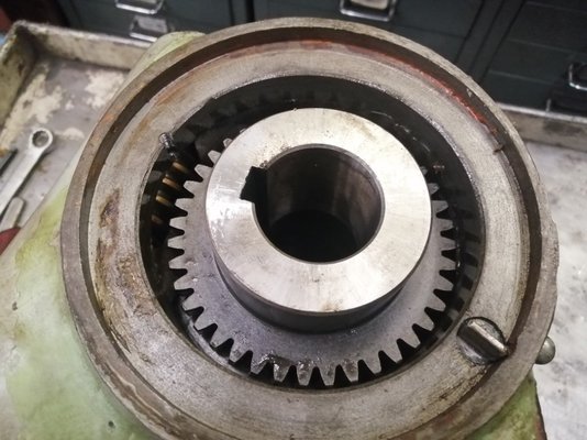

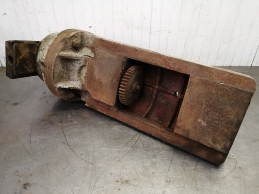

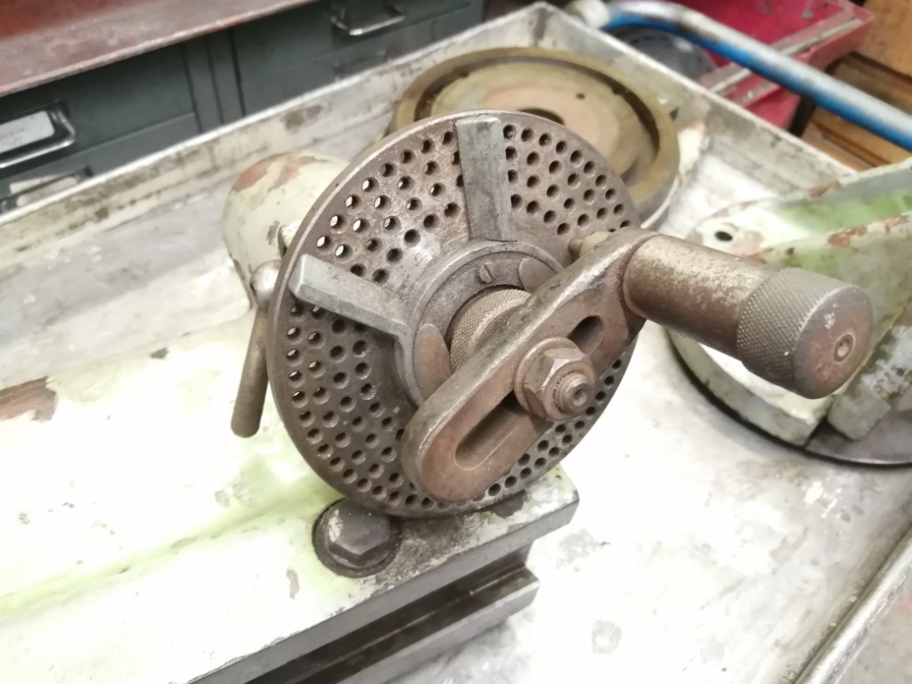

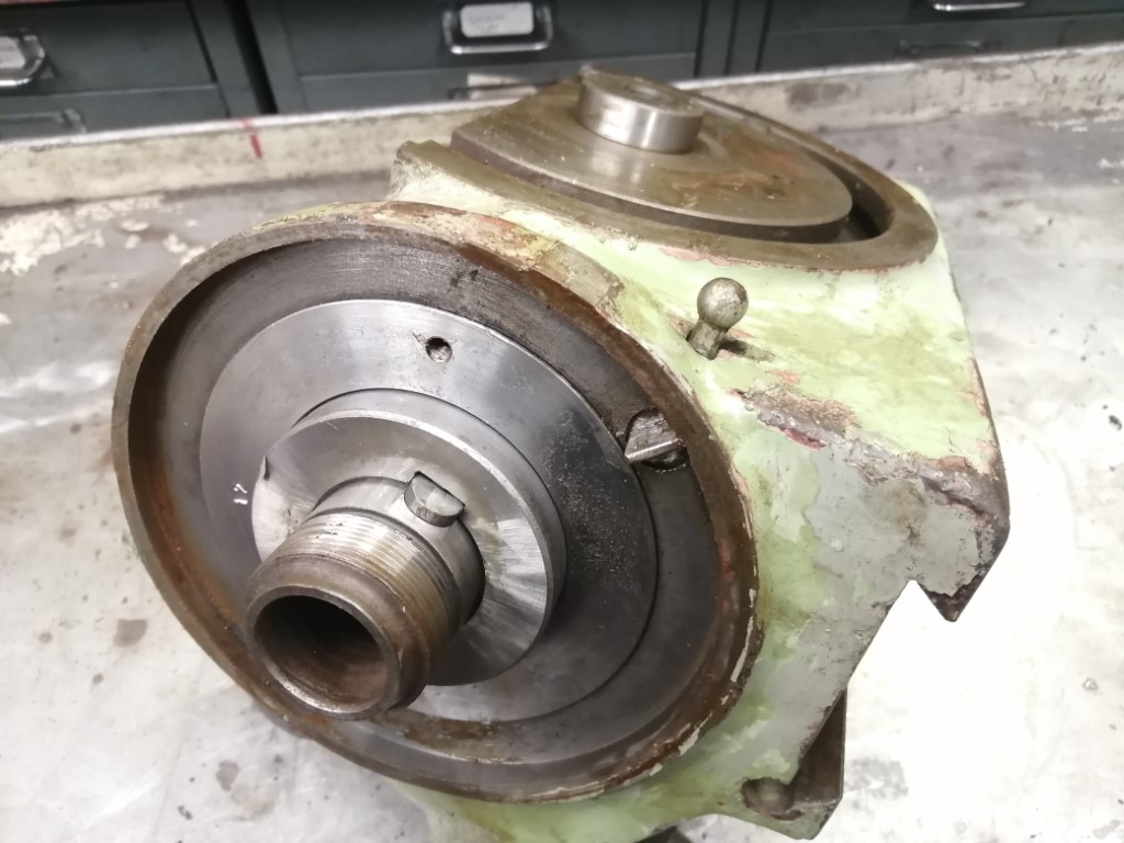

Wow all the toys. That is a great scoreI've just bought this machine for my workshop to replace my little Herbert Mill. I've always wanted a more versatile milling machine but I'm hampered by a lack of space and Could not possibly fit a machine the size of a Bridgeport in my workshop. @W.olly found this on Facebook but the logistics of collecting it would not work for him so he graciously passed it over to me after I expressed an interest.

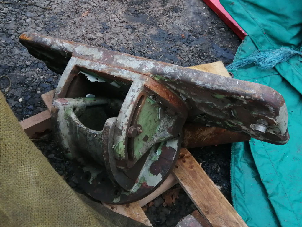

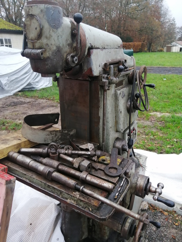

This is a TOS FN22 universal milling machine. It's a clone of the very well regarded (not to mention expensive) Deckel FP-1. Here it is uncovered from the tarpaulin they had protecting it.
The machine is quite complicated because it's designed to be highly adaptable and comes with several attachments some of which are driven directly from the horizontal spindle..

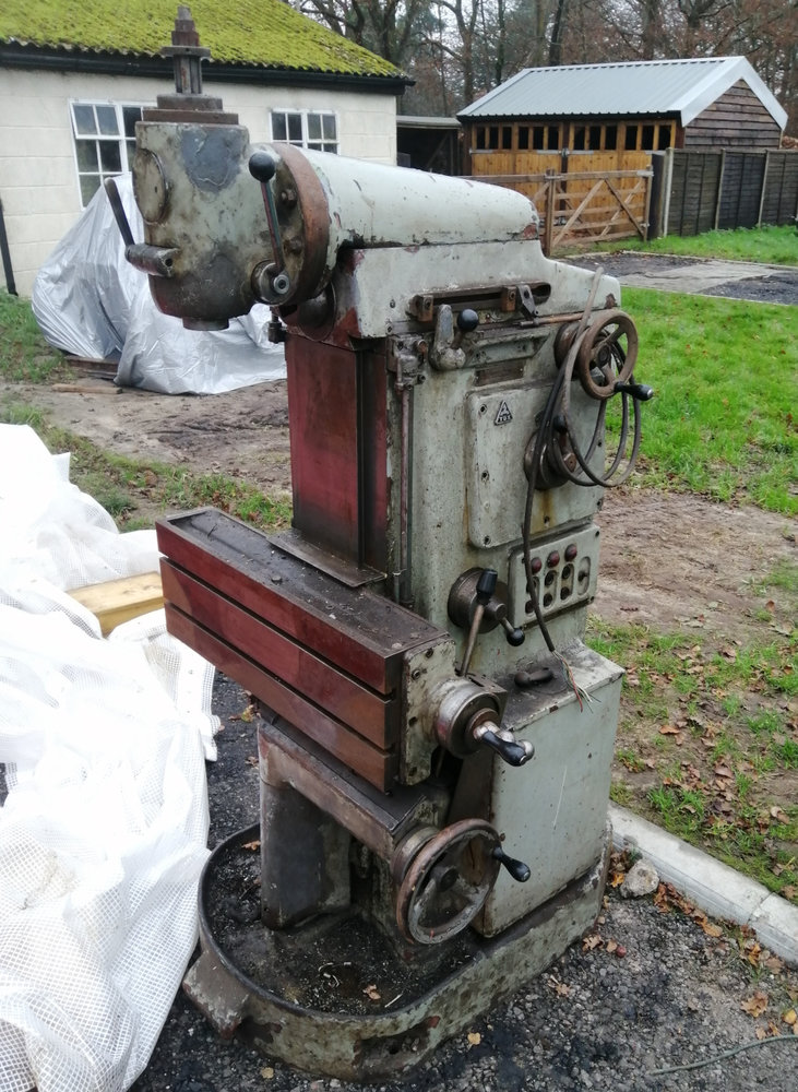

With the above table removed it looks like this.

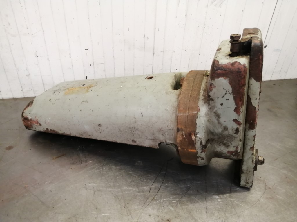

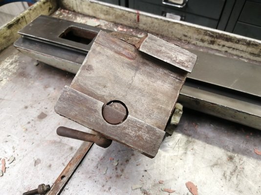

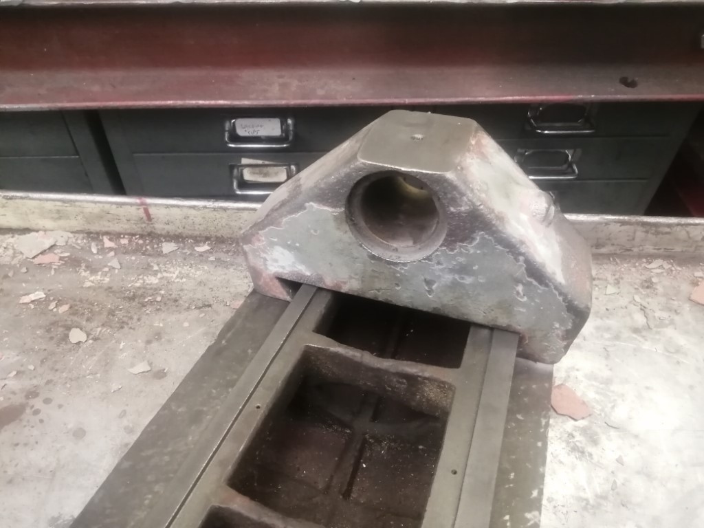

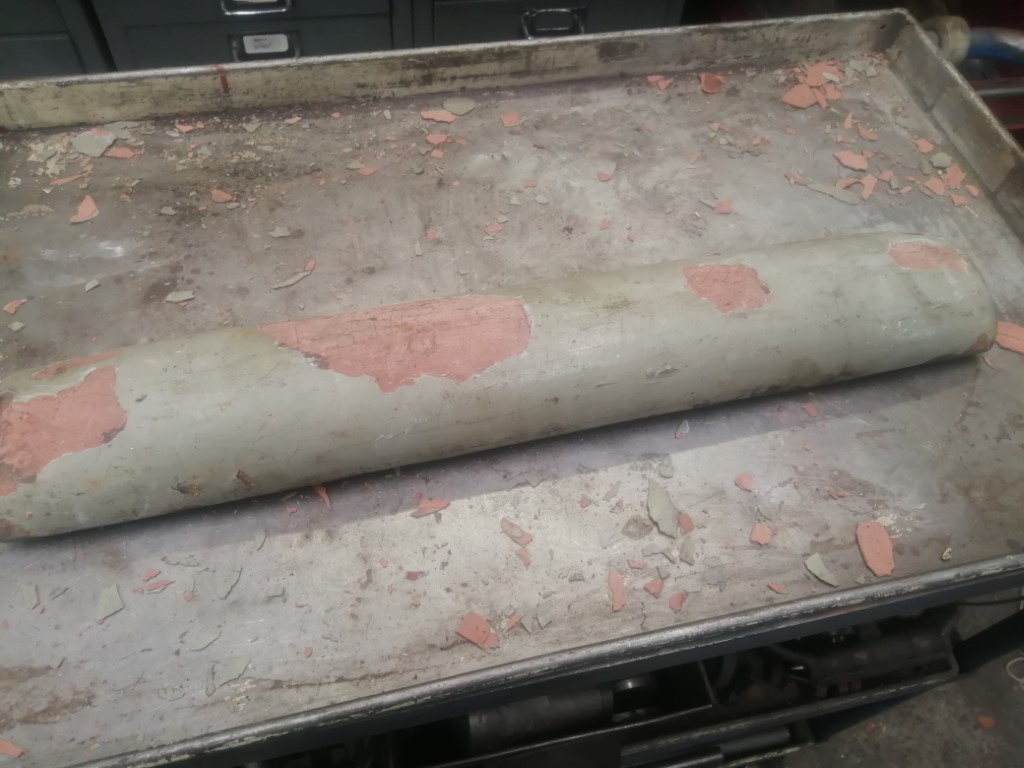

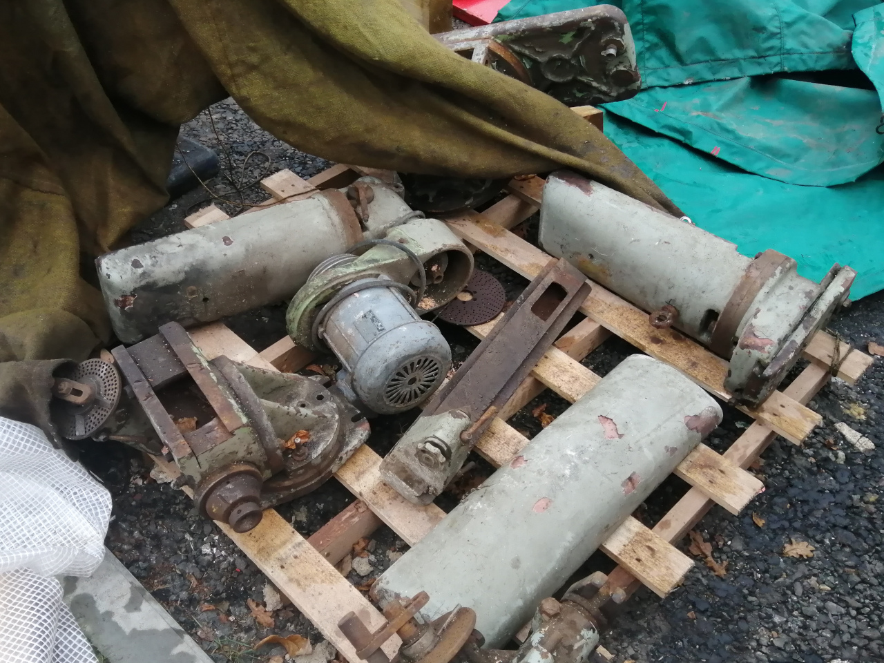

This machine came with four top-side attachments - the vertical milling head fitted above. A second vertical head with separate motor and belt drive, an over-arm for horizontal milling and a slotting head.

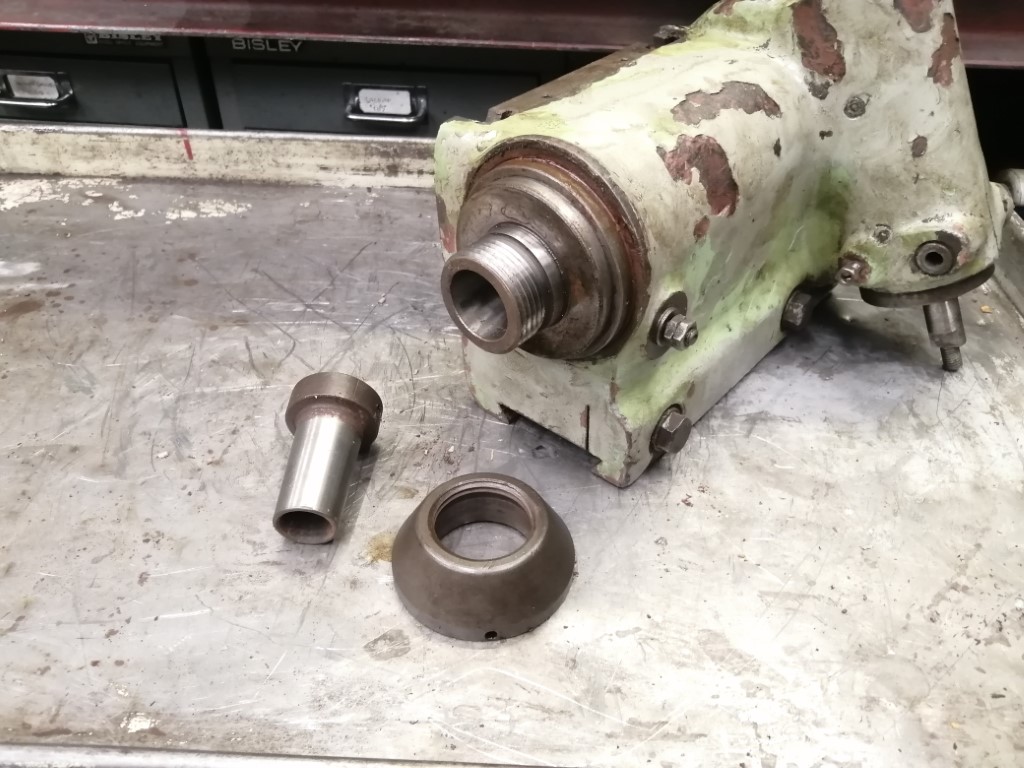

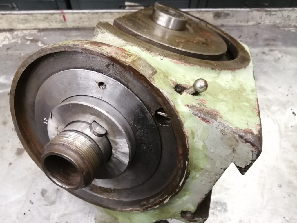

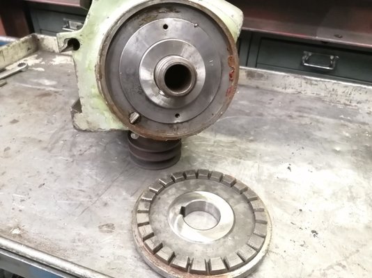

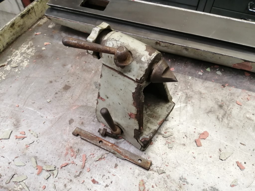

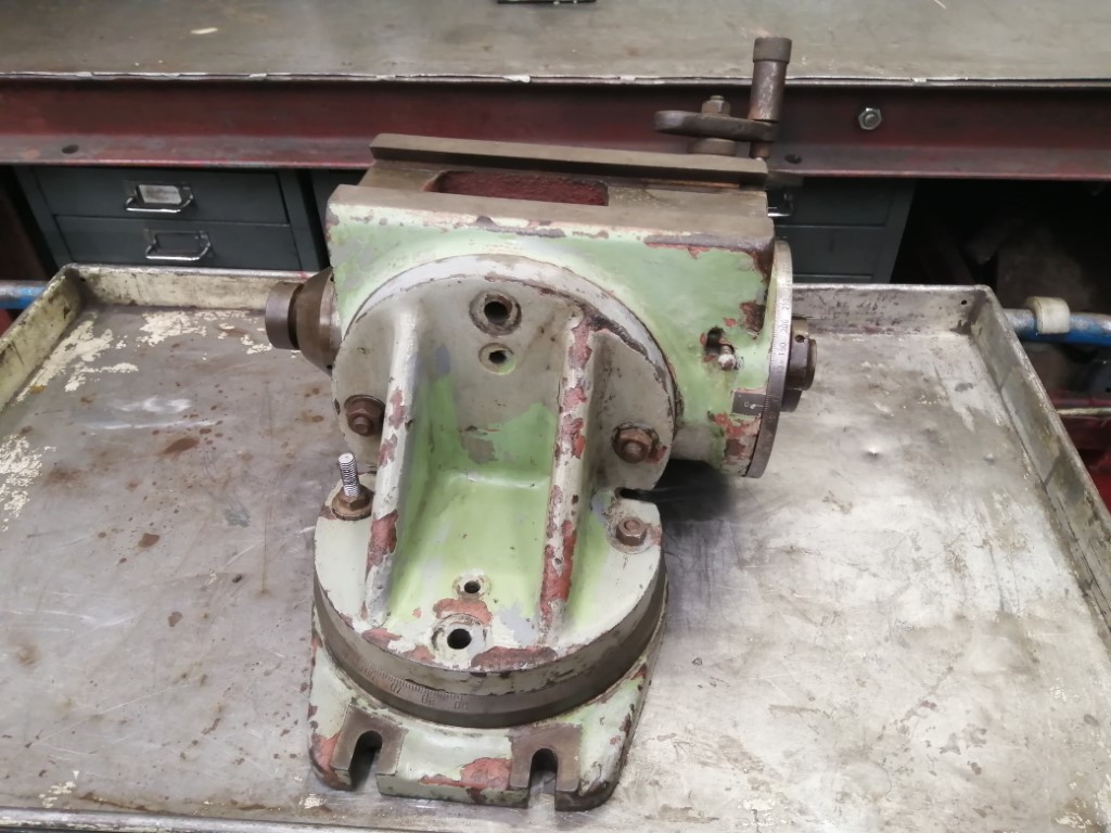

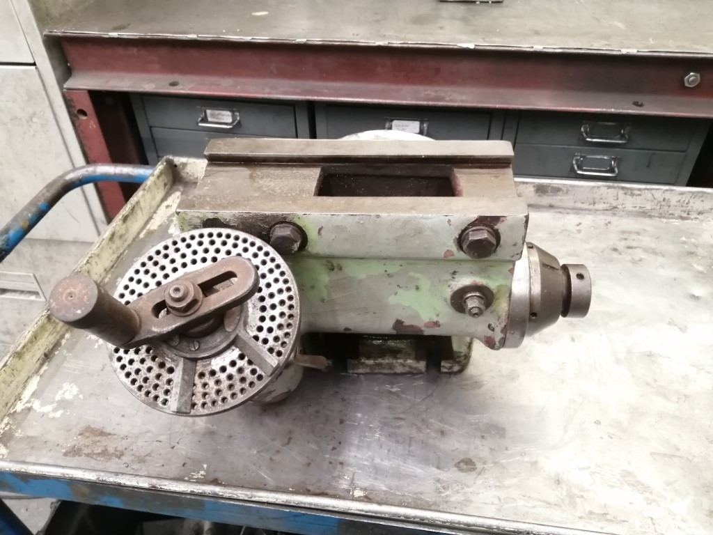

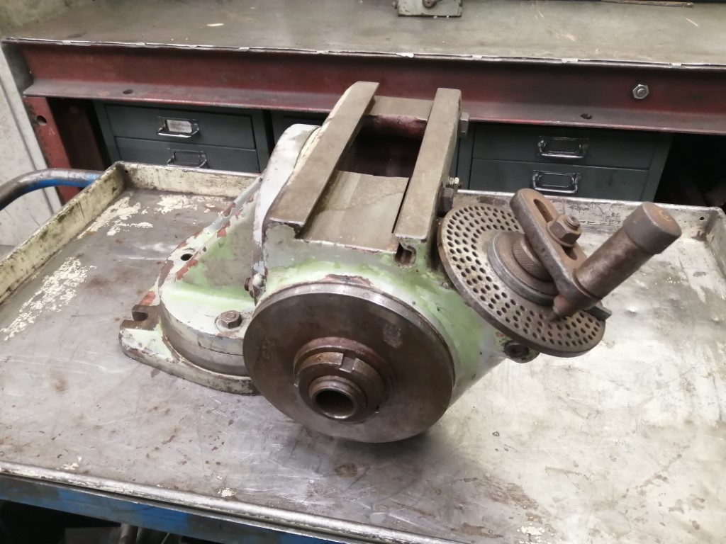

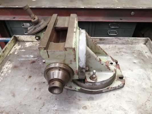

It also came with 3 attachments that bolt to the corss table:
Plain table (as shown above)
3-way tilting table

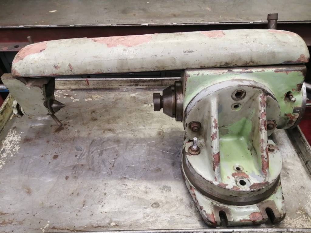

Dividing attachment with overarm and spindle support.
View attachment 320655 View attachment 320656

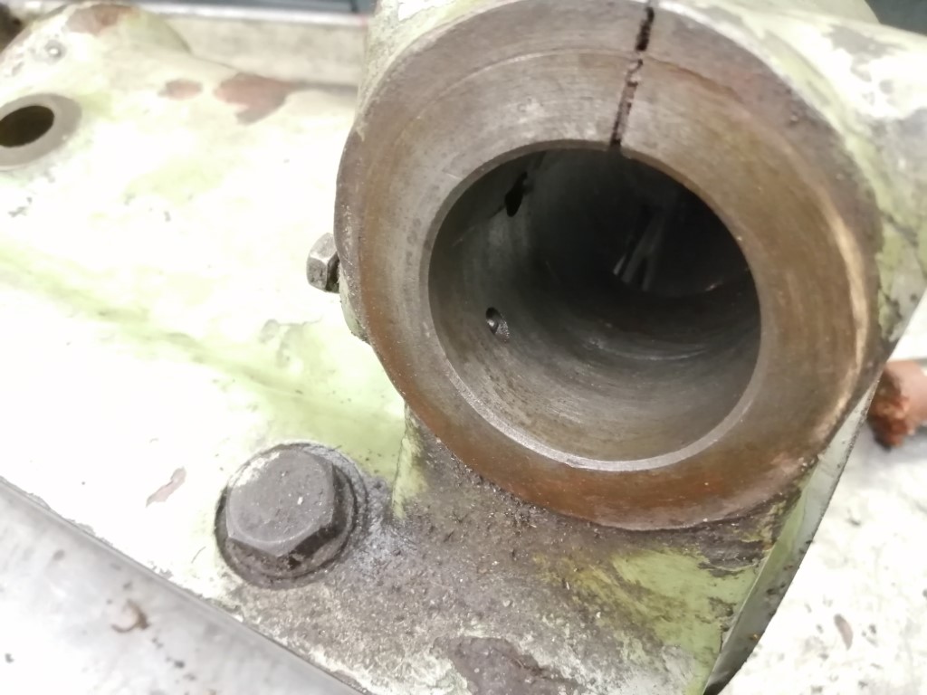

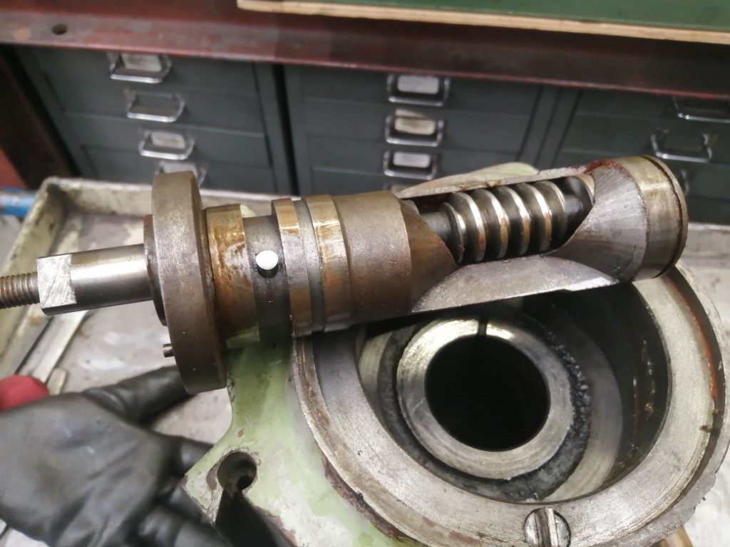

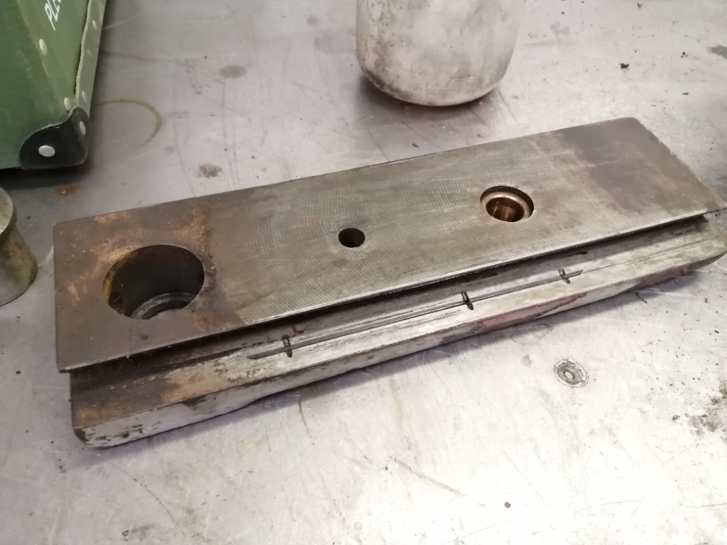

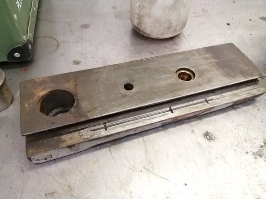

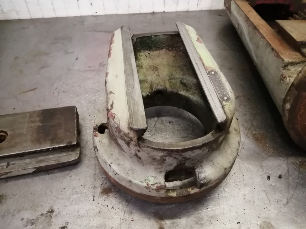

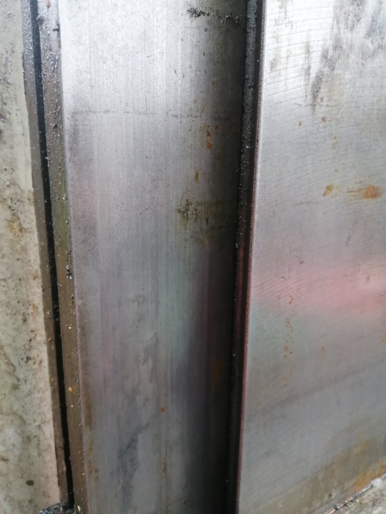

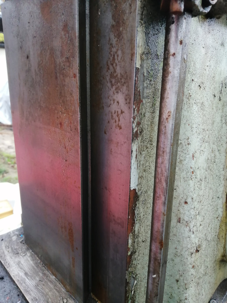

As to condition well the machine is obviously very grubby. Mechanically it appears in excellent condition. There's nothing bent or broke. The ways that I can see are in excellent condition and the screws appear to have only a few thouu of backlash.
View attachment 320657 View attachment 320658

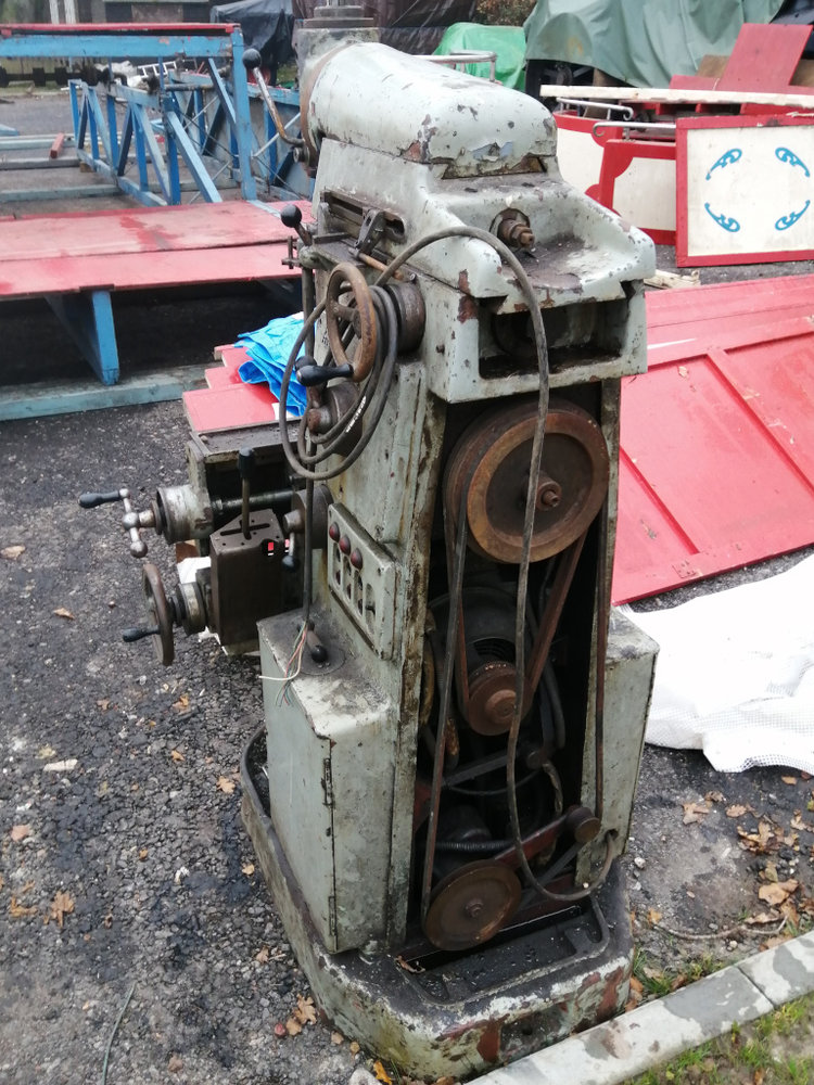

The only thing so far that's missing is the belt cover. I'm not overly upset about it beccause I can knock up a cover from MDF that will be impossible to tell from the original but will be much lighter. I also could not find any collets but the guy is going to ask the operator about both of these.

I have the original motor off my Harrison 11" mate if its any good to youI was a bit nervous because the over-arm was missing from the facebook pics for the machine and for the indexing attachment. Finding them included was a relief and finding the slotting head attachment included also was a bonus because it wasn't in any of the pics at all. Only big hurdle now is finding some collets and powering the 2-speed motor. It might have to have anew motor and vfd.

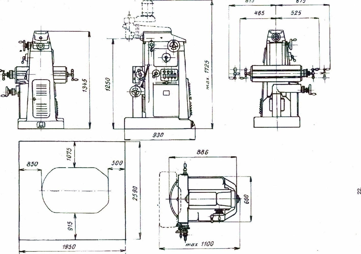

@Pete. not sure what your German is like ..You may have already located this
https://onedrive.live.com/?id=547FE296ECFD561F!189&cid=547FE296ECFD561F
With all the bits ..![]()
Looks more like Bavarian to me - totally different language!I know a little German.
Smaller than it looks.....what are the travels?
