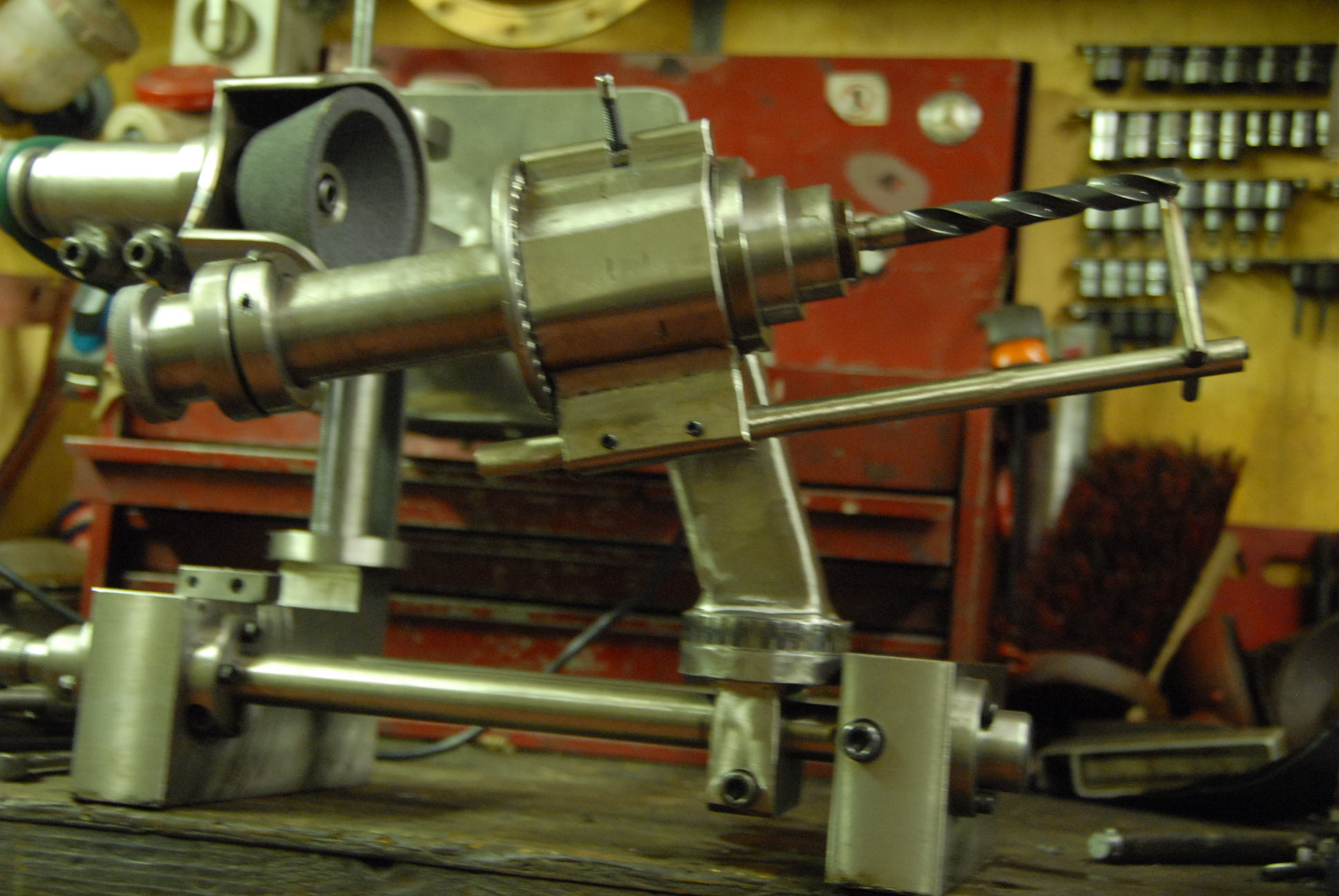

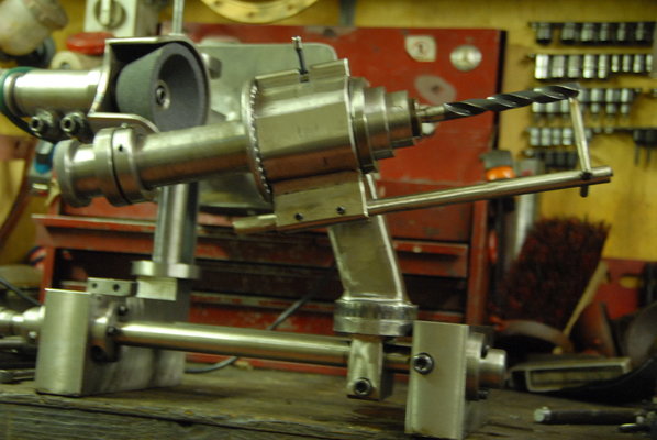

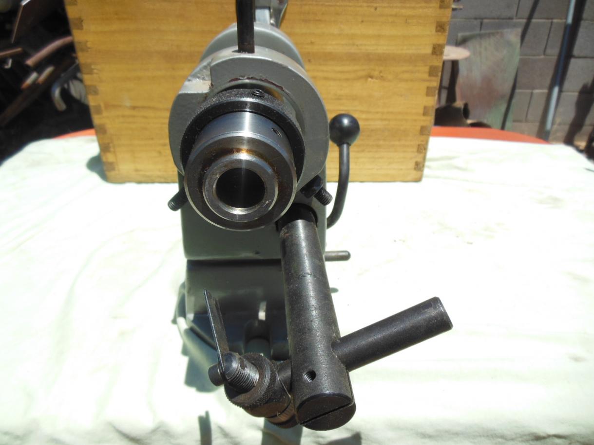

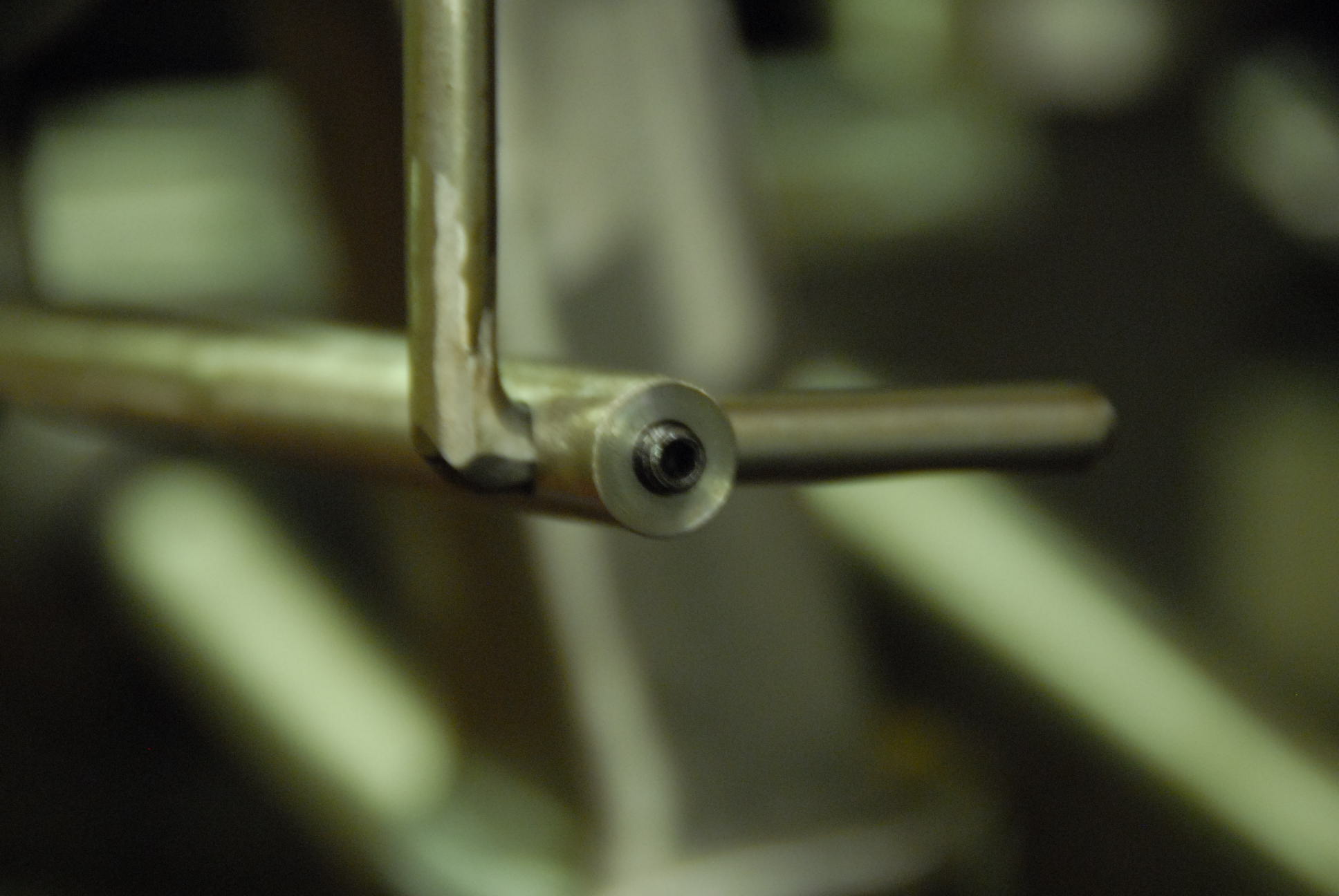

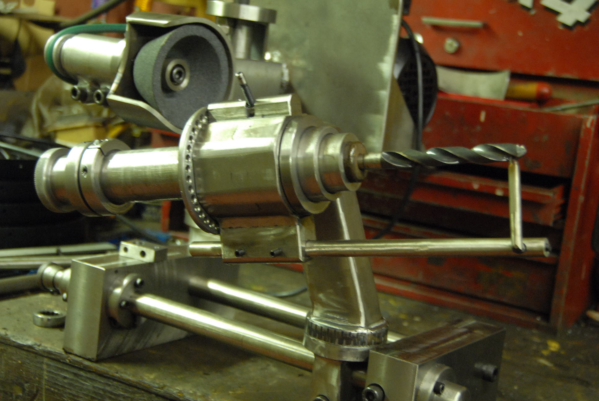

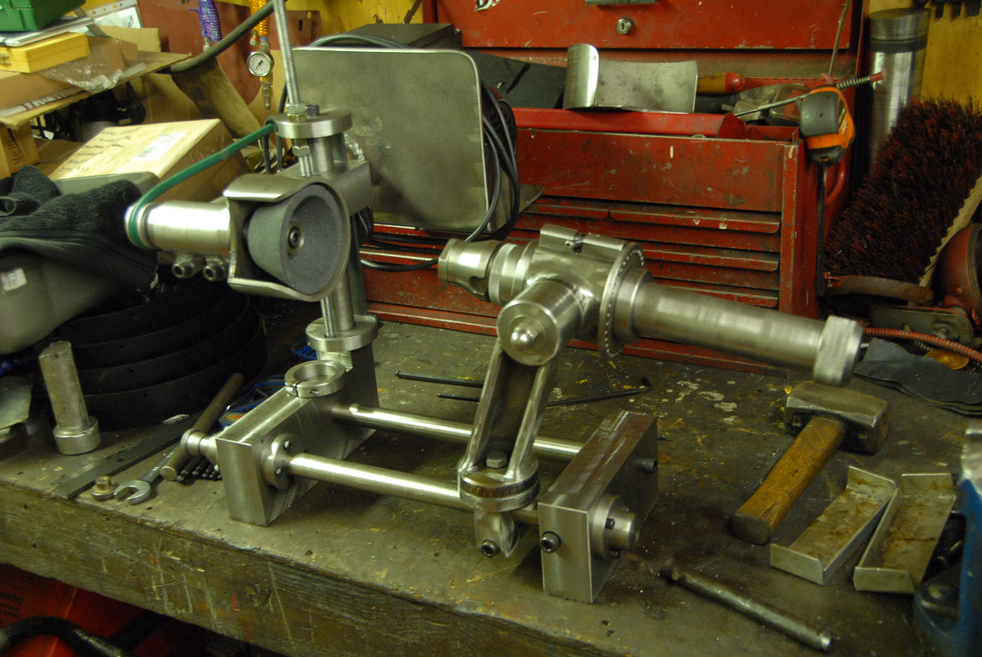

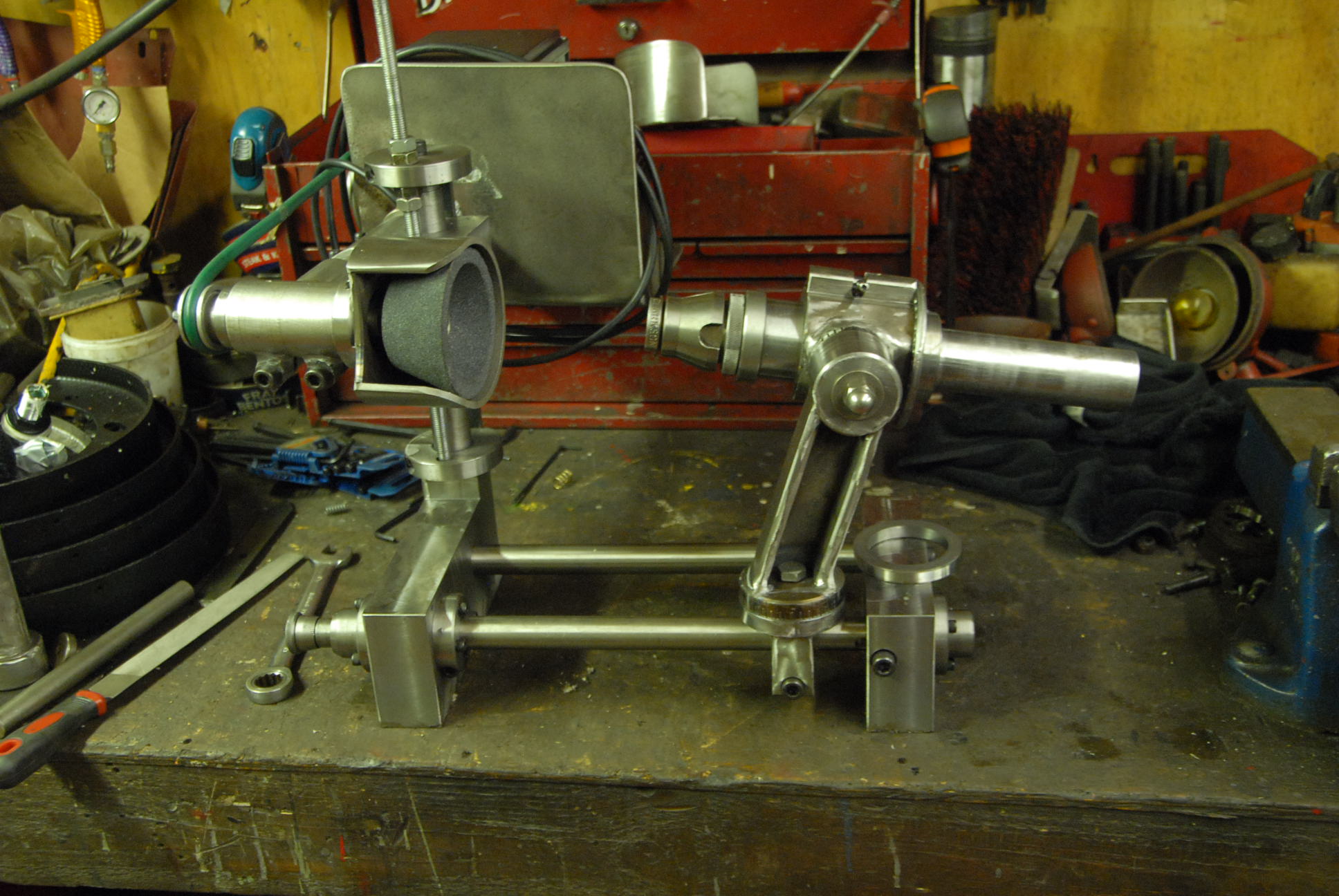

just to mention something on mine before you go to far mine has a way to do the flutes down the mill end
and if you look at the extras i can also use 2-3-4-5-6 flutes to sharpen them up by twisting
it also has a blade so it slots into the mill spiral and then you twist it to sharpen the flute edges down the end mill
just incase you decide to weld lock alot when really you shouldnt but allow it to move on the round bar

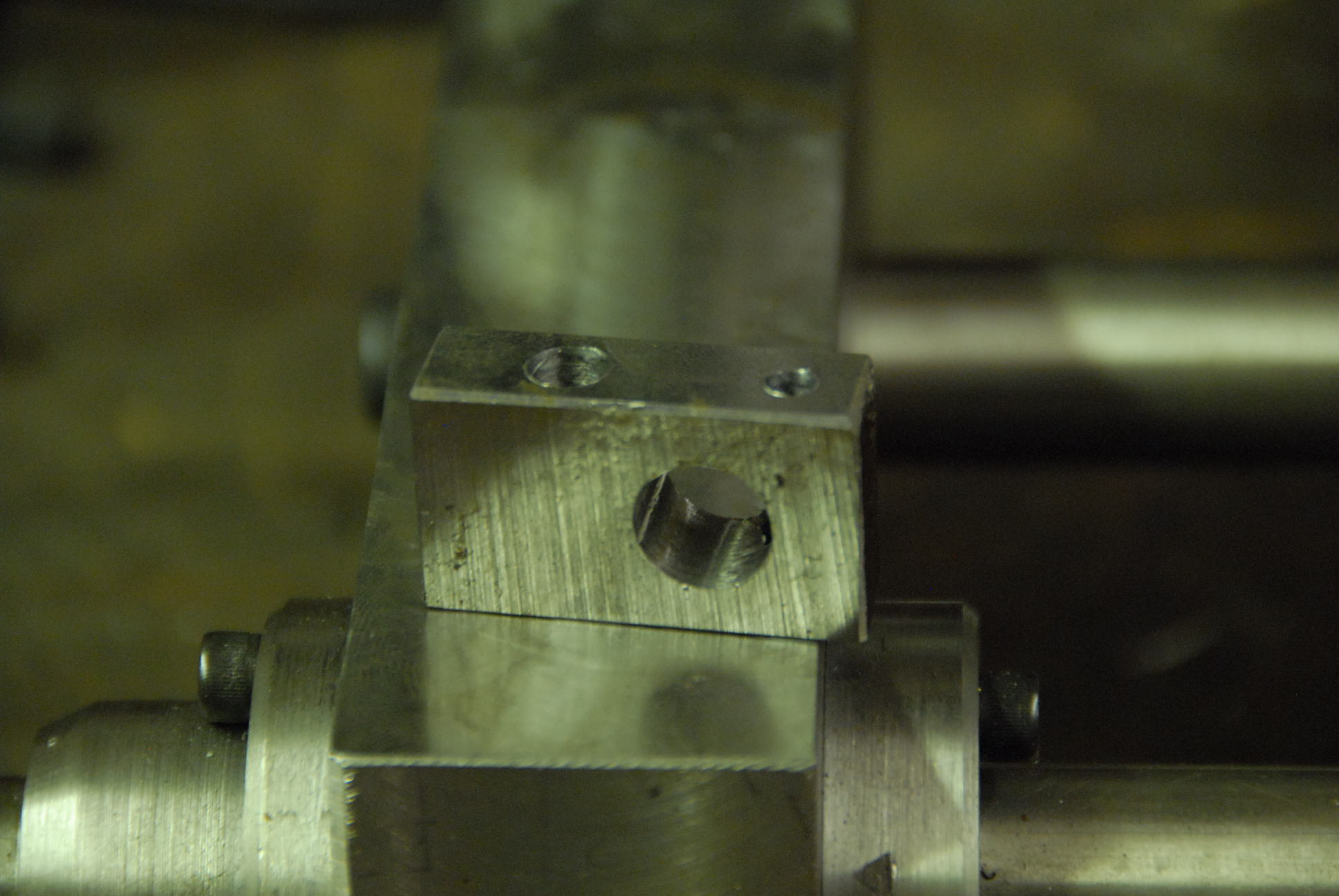

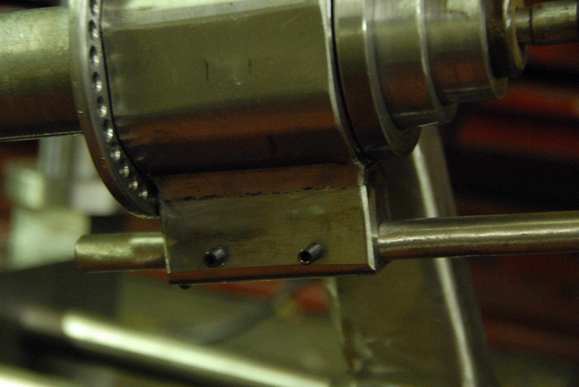

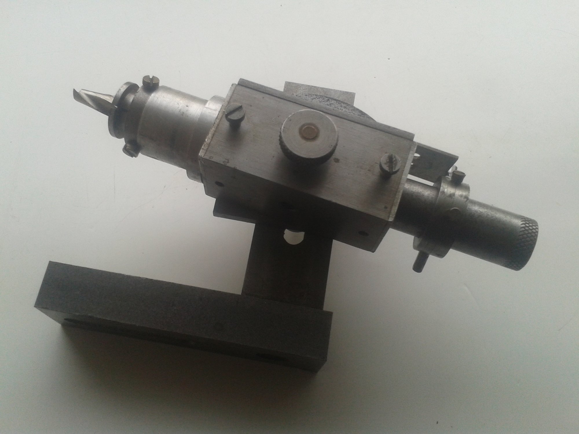

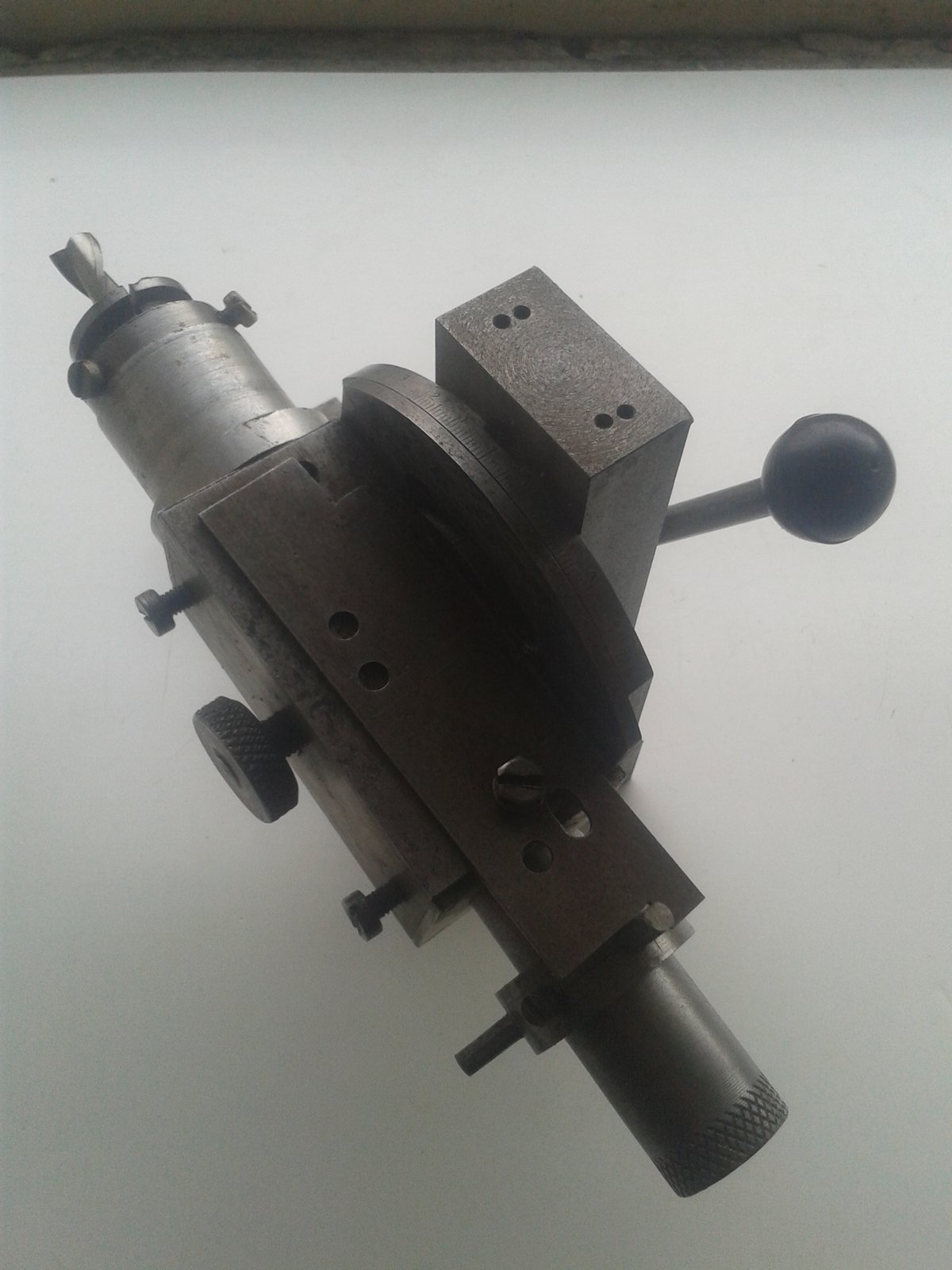

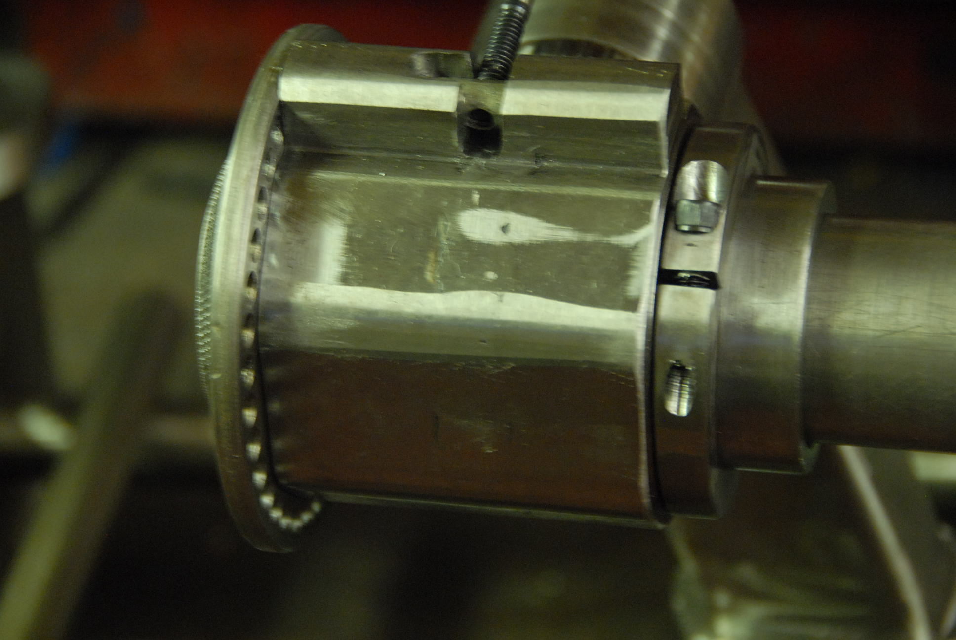

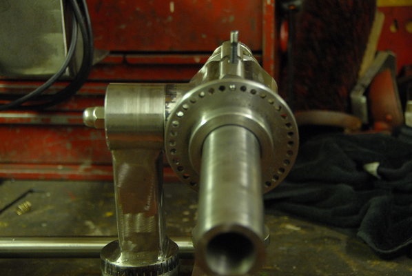

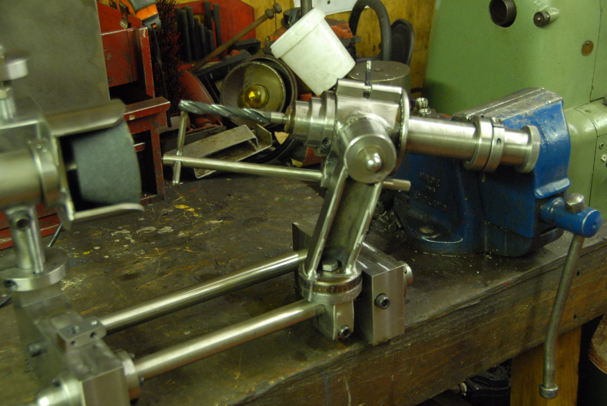

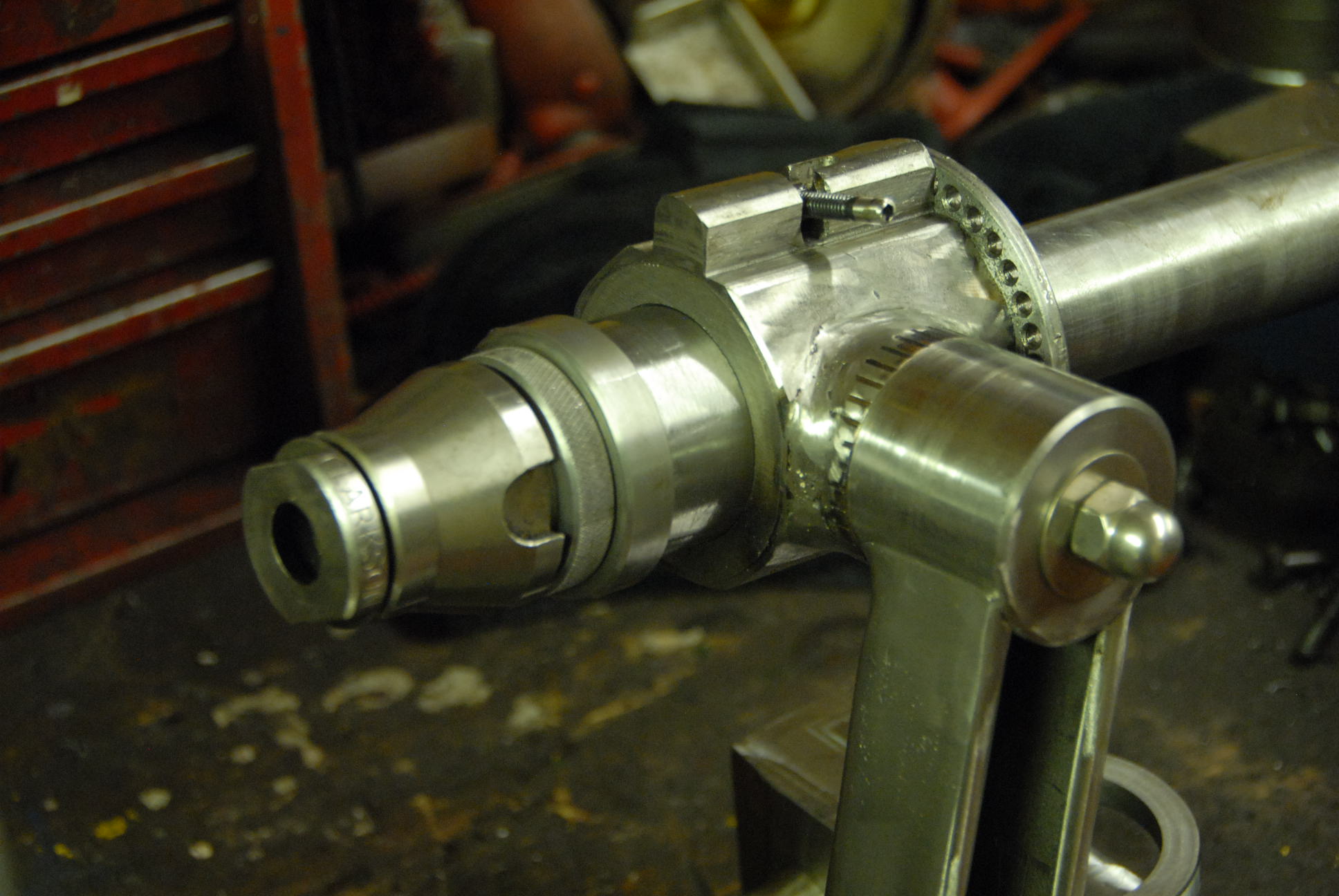

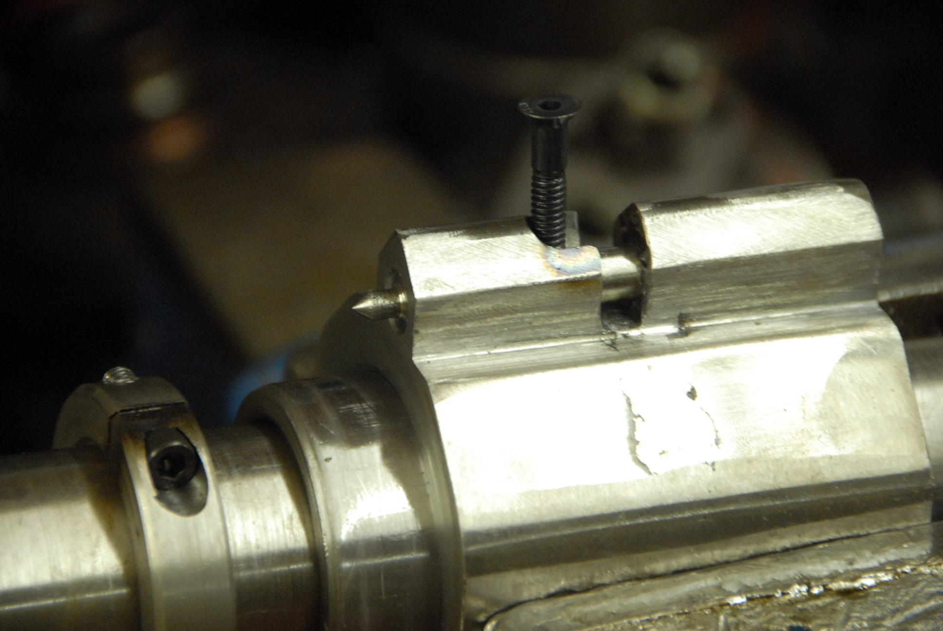

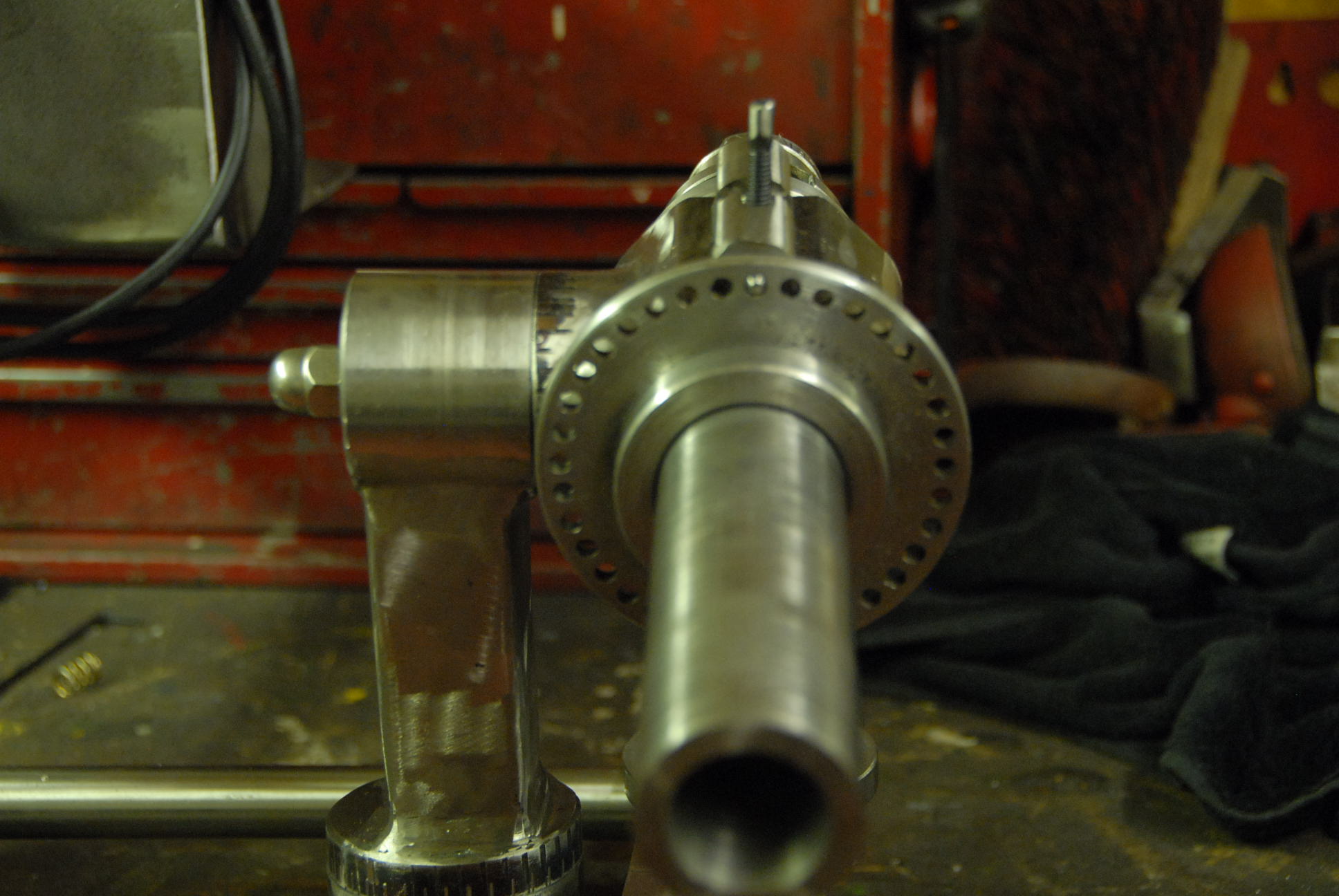

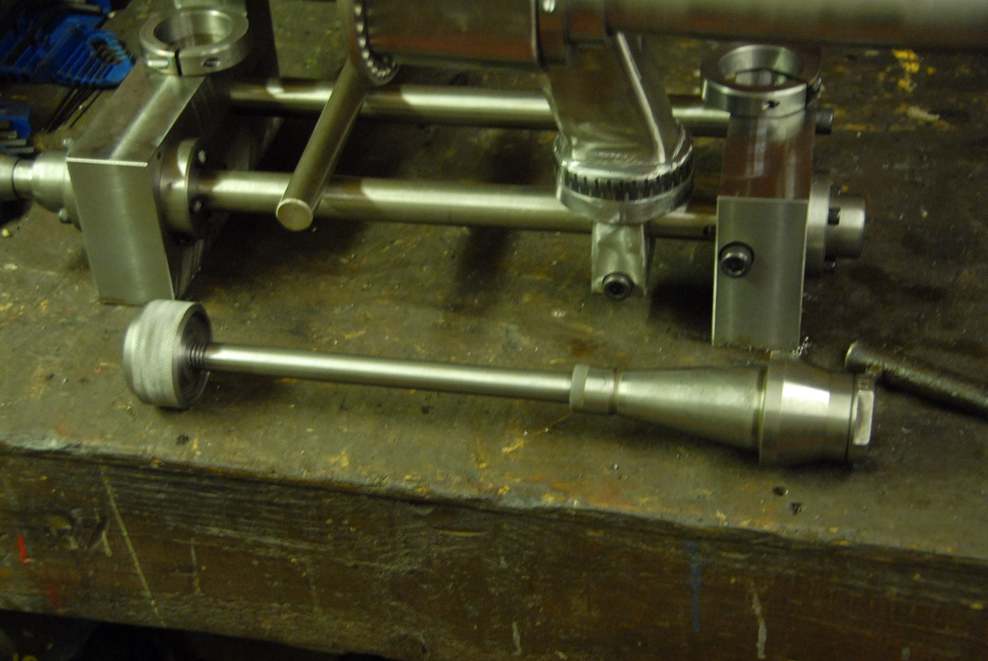

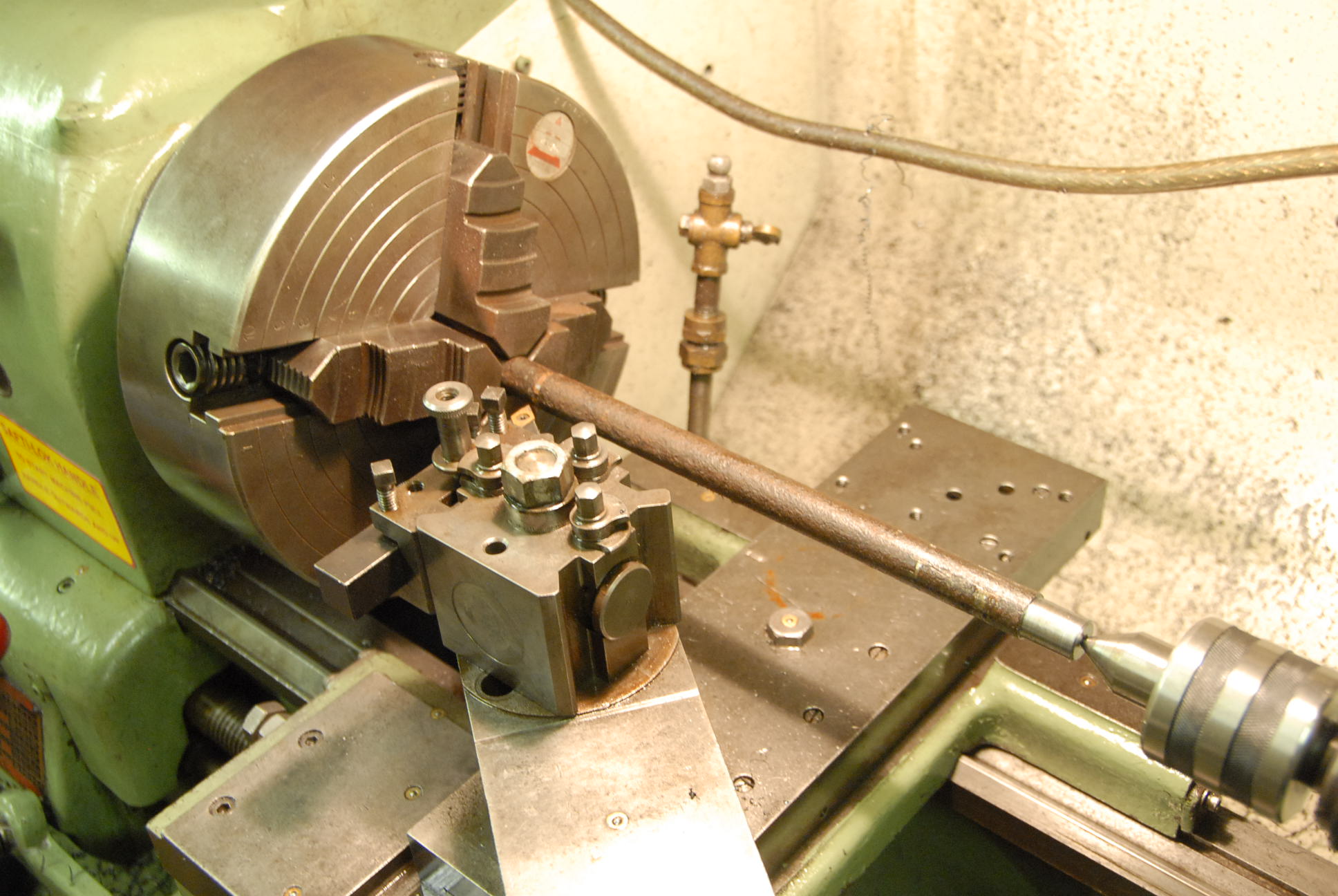

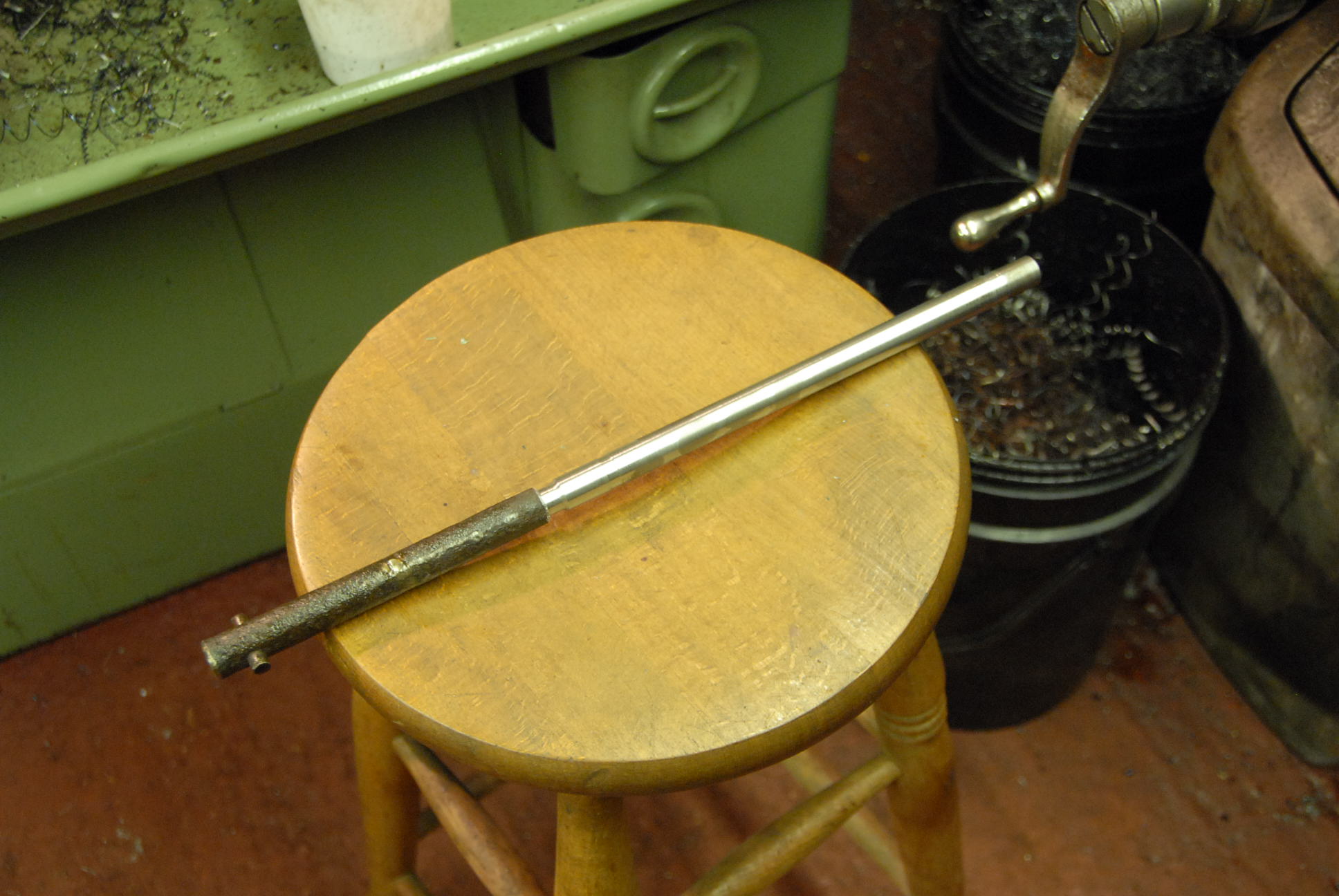

I am not weld locking anything its difficult to explain, the slot along the side of the tool holder allows the tool holder to slide forwards and back, and the clamp round the indexing tube stops the indexing tube sliding out.

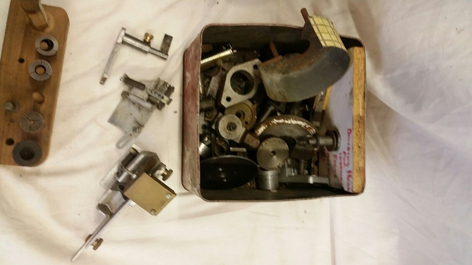

And I only opened the one containing the motor [among other bits] to make sure it worked.
@jordhandson Reading your progress and the good work your doing, I feel very guilty knowing I have a Quorn machine presently sitting in three boxes, two of which I haven't even opened......And I only opened the one containing the motor [among other bits] to make sure it worked.
So many projects means that it'll be some time before I unpack it all. I don't want bits of it scattered around and neglected while I have to attend to something else.![]()
. Tools like I need now take priority, the tool grinder is needed like yesterday otherwise I am going to have to many bits that need sharpening, and that's when my head gets
bogged down.Miss understanding there gaz,I am not weld locking anything its difficult to explain, the slot along the side of the tool holder allows the tool holder to slide forwards and back, and the clamp round the indexing tube stops the indexing tube sliding out.
mines just a round bar with a bar stuck out and dosnt have a slot in it
this allows me to use the spiral feature when doing the flutes on the milling end mill
use your bar below the tool post itself as mine connects there as its out of the way and is solid enough

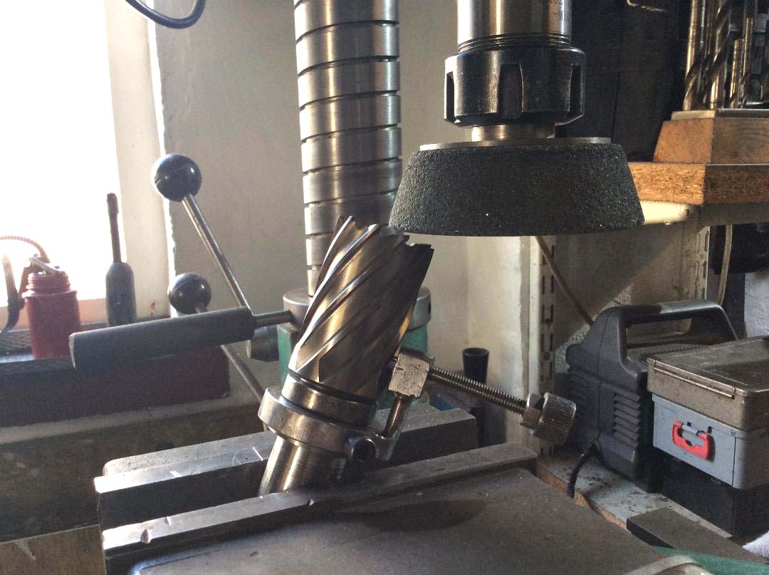

My pal uses this set-up but says it's a bit of a faff - he doesn't do much milling but says it does work
