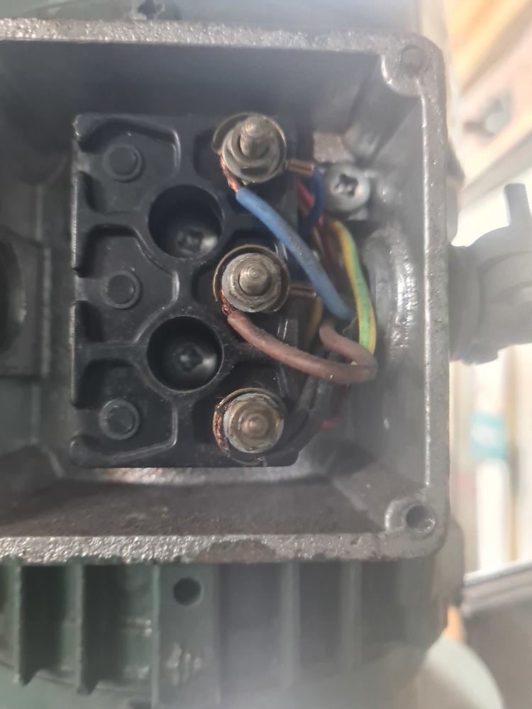

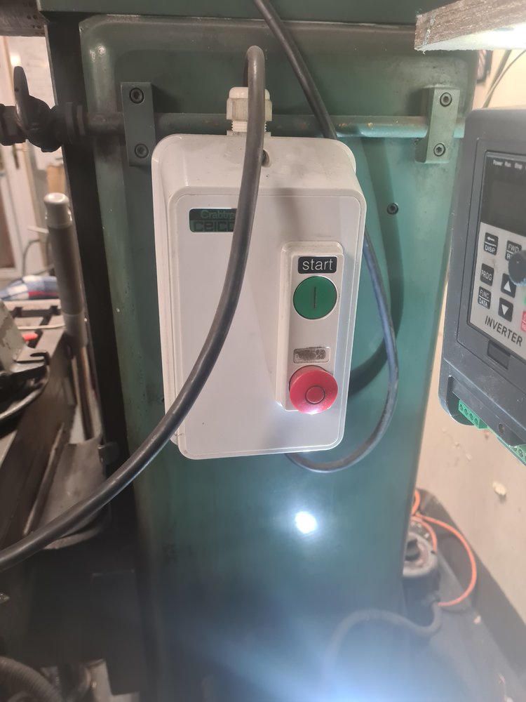

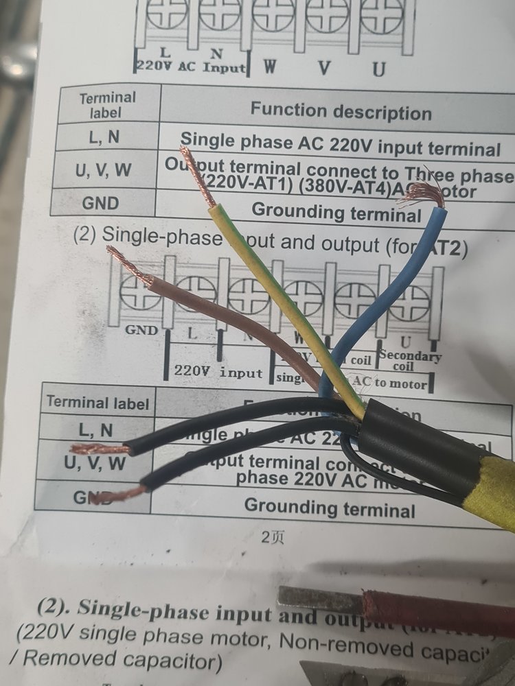

Please don't connect that up! At least not until you've drawn up and photographed your diagram, I have serous doubts about what you've done there....Just need to check before I blow myself up lol.
So 240v single phase tp output of 3 phase motor
The motor has this wiring coming out the switch. 3 in the motor.
Have my VFD to wite up. Blue goes in W1 Brown to V1 and both the Black go to U1 ?
Wire out the motor
Out the switch
And instructions
