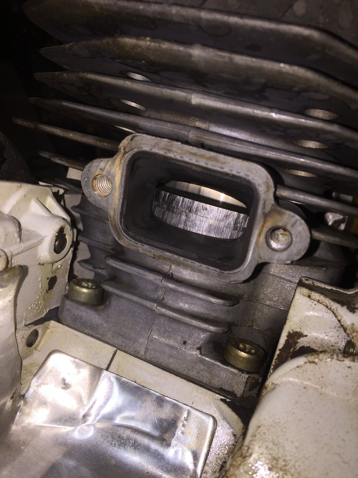

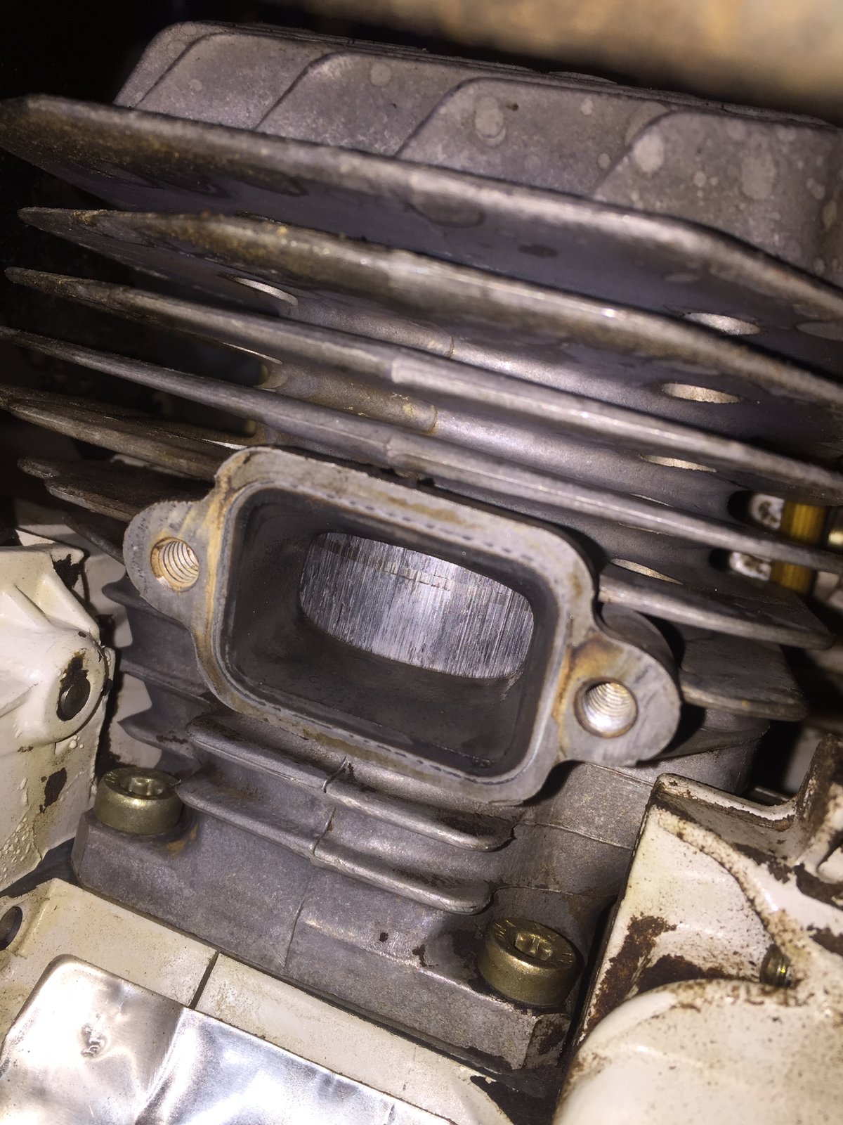

New barrel & piston is the only cure I'm afraidI dont know if this is normal or indicates excessive wear? It was working fine one day and not the next. The marks look a lot worse than they feel - barely perceptible as i run my finger nail over them.
View attachment 175349 View attachment 175350
Re-check the fuel oil mix ration for the machine .. the silencer blocks up quickly with carbon if there is too much oil or high ash oil in the fuel .
