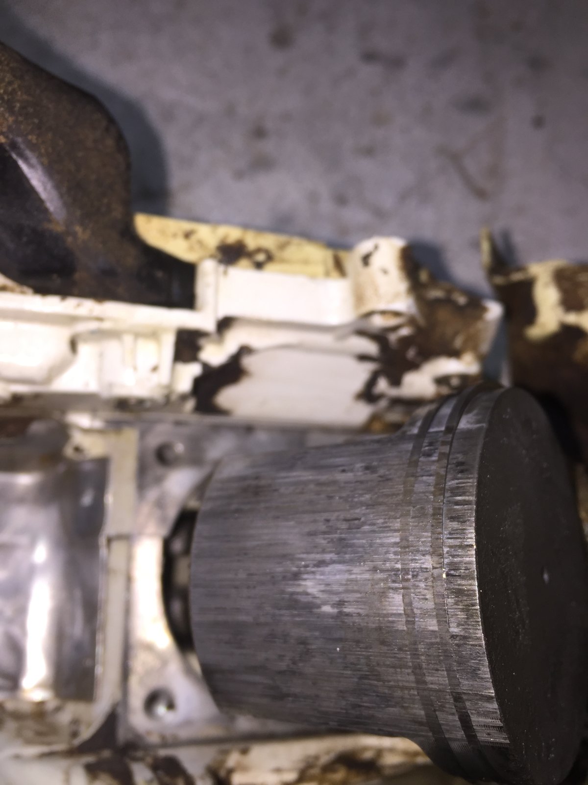

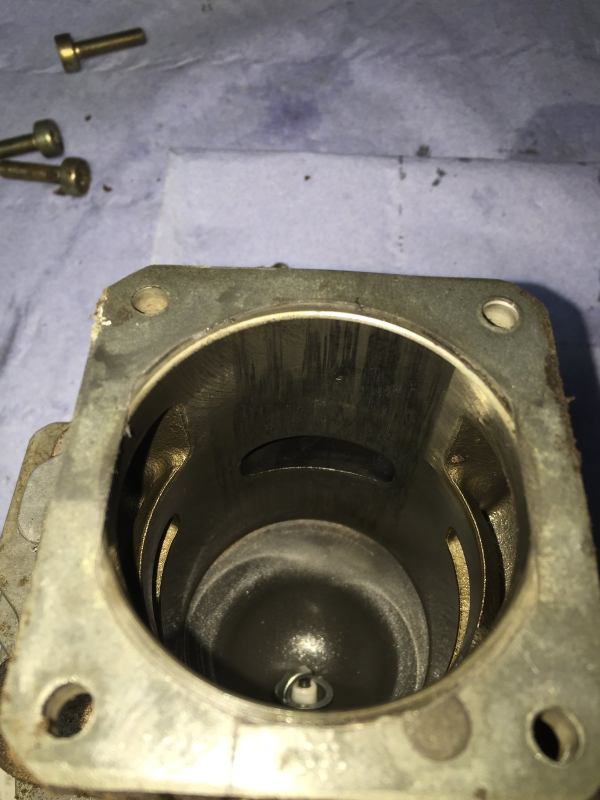

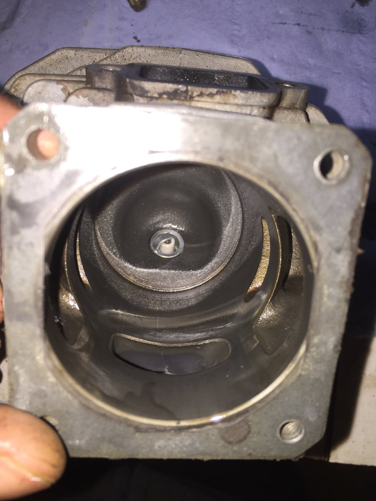

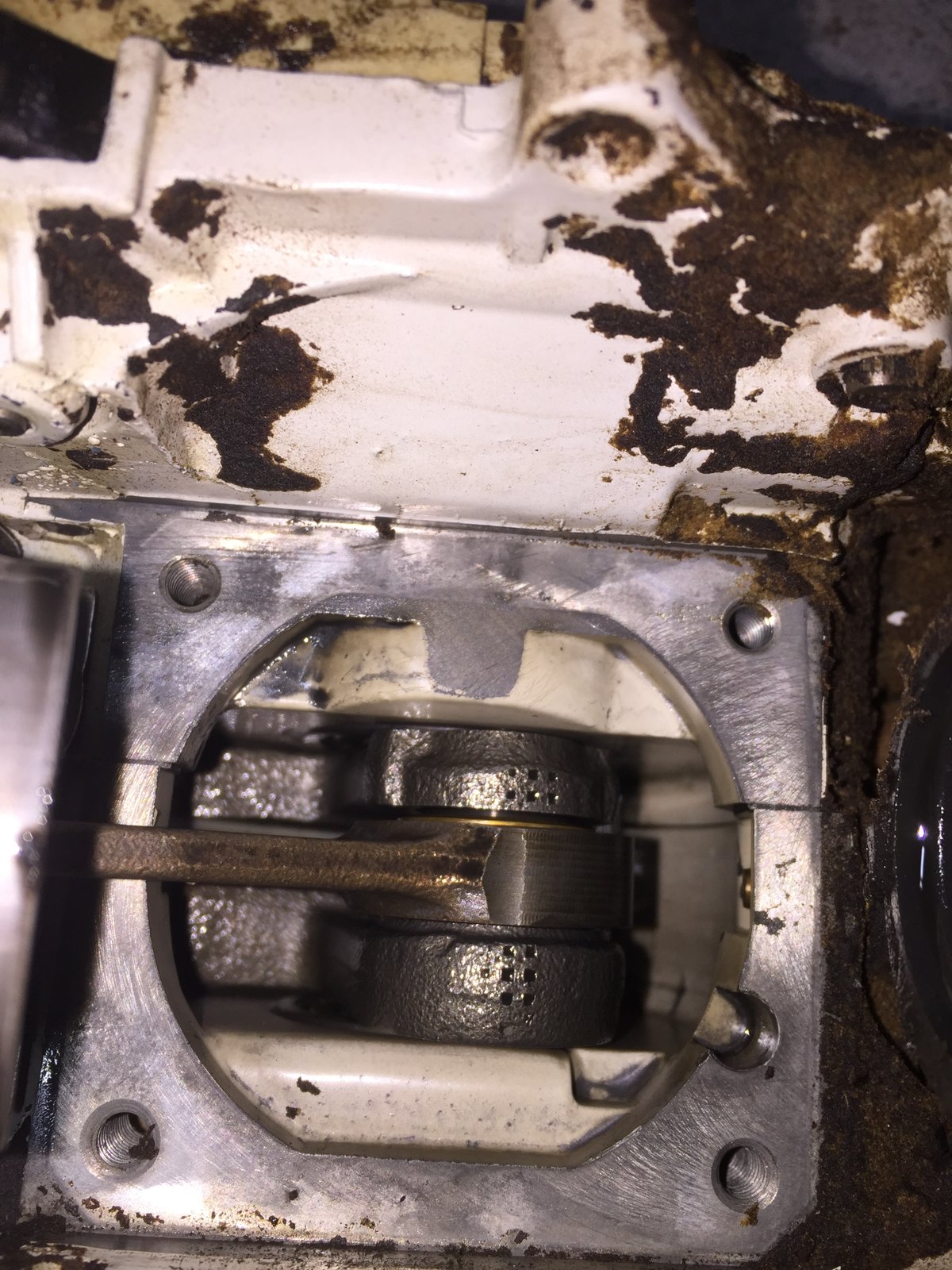

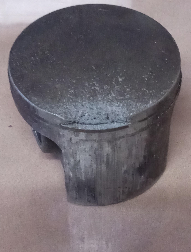

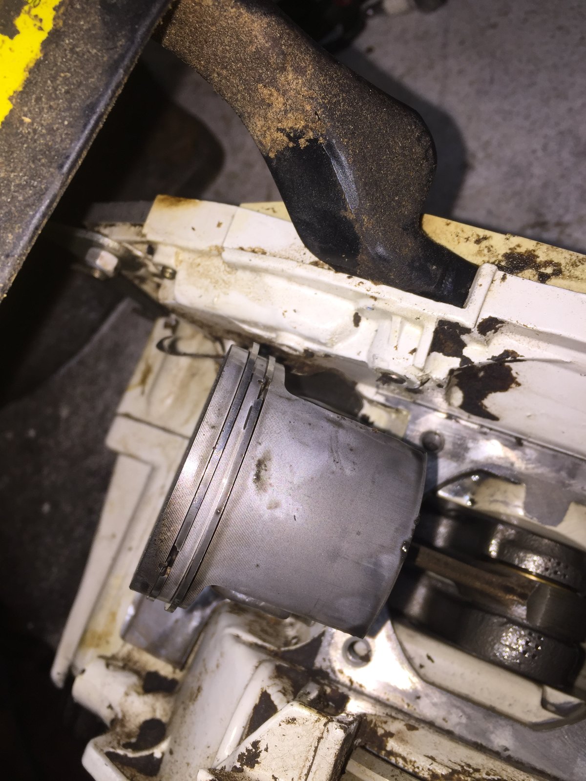

... measured them up, and there was nearly half a mm of difference from the original. The crank bearings wouldn't even go in, never mind line up.. We're off to a poor start then, however I managed to dress the journals a wee bit and got round that, all built back up easily enough after that. Had a bit of hassle getting it to run right even though nothing had changed on the carb. Back to basics set it up / tuned it and ran it... ran it in fairly aggressively, and it now runs ok, the question is how long it will last.
I wonder what the bottom end is like?

piston rings look gone on the pics above
