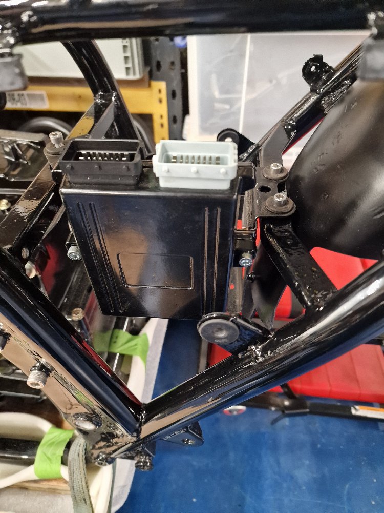

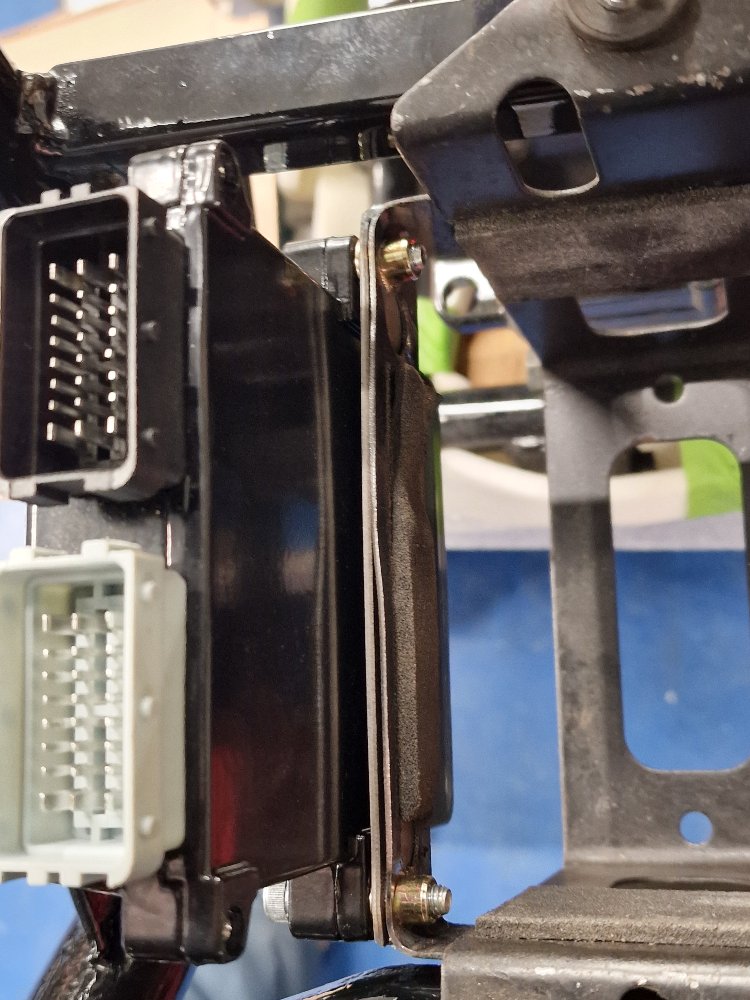

I wouldn't face the sockets upwards.Mounting stuff that was never meant to be there always takes longer than you expect. Some cutting, welding, plate and rivnuts later and the ECU has a home in the GSX.
View attachment 521728View attachment 521729
Ordinarily I wouldn't but that's the best orientation for cable runs.I wouldn't face the sockets upwards.
I'll keep my fingers crossed for you.Ordinarily I wouldn't but that's the best orientation for cable runs.
I'll be sorting out some decent boots for the plugs so it should be OK and given what the bike is it's unlikely to see any rain.![]()
I wouldn't spend too much time worrying about it. The only difference with plugs up is direct downwards water which will be next to zero in that position. Lay them flat or facing down and capillary action wicks moisture along the wires inside the loom but most issues with moisture for ECUs comes from ingress into the ecu case itself.I'll keep my fingers crossed for you.![]()

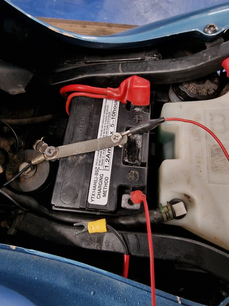

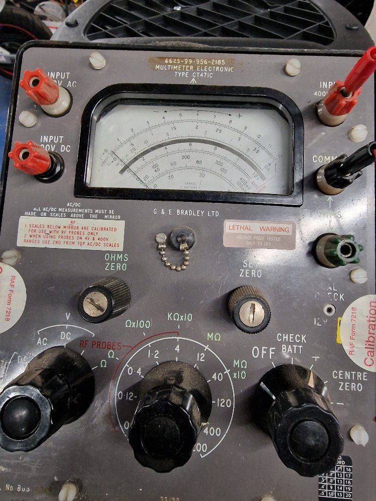

I know to one of those but cant mention him on the forums.Every now and then you need to go old school. So I'm pressing the Bradley into use looking for a parasitic drain.
