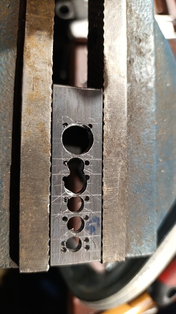

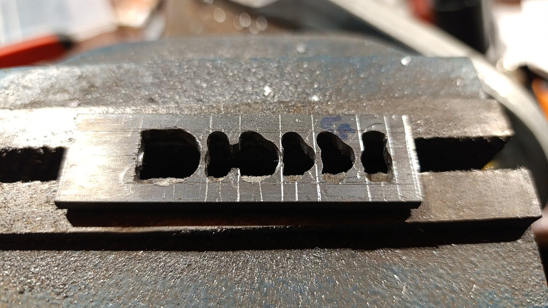

Made something usable today.
I'm kinda tempted to put a 5mm end mill in the milling machine and square the edges so I'll be able to finish it up with a file without killing my arms.

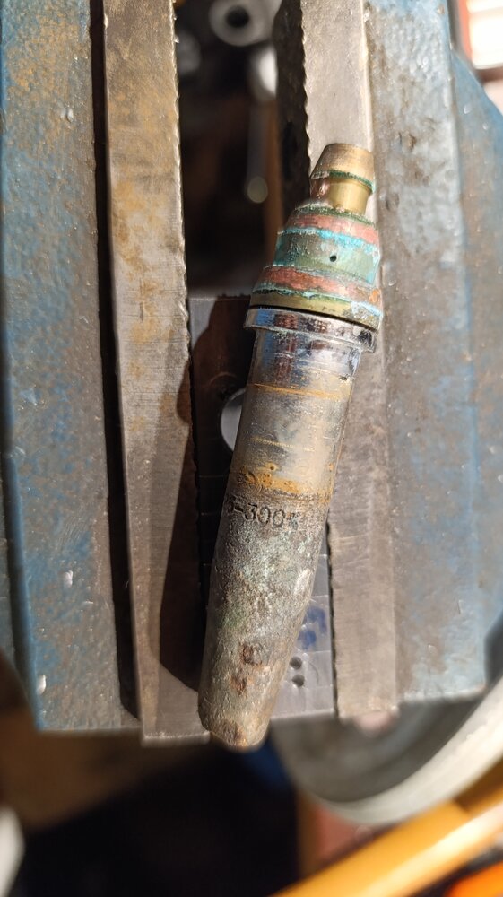

The 1200mm long 180° one it's an Harris Model 28, the tip nut was stuck but I've managed to loosen it up using a 24 and a 27mm spanners.
The hardest part has been removing the tip cause it was stuck too.
Hammered around, heated it up, put the inner part of the tip in the vice and used a chisel pinched between the jaws and the torch head, few Gentle hammer blows and eventually it gave up.
I think to know what happened...
It's a 300mm propane tip a pretty big one too they somehow managed to make it backfire a flashback essentially, the inner cone started to combust and they throw the thing in a water bucket and left there .
That's why of the oxyde on the seats.
They might have used acetylene to try it.
That might be the reason of why I've got those torches for cheap.
The torch needs a lot of accurate cleaning and maybe pressure testing the tubes.
Maybe brazing the again.
The nut threads needs a little cleaning with a file cause they used the torch to Pierce something and got a lot of backblast.
