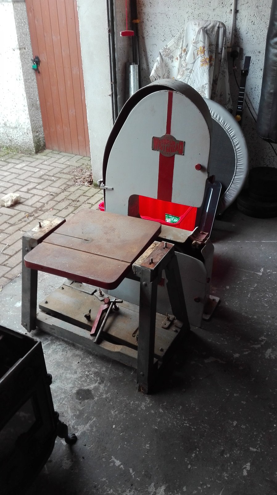

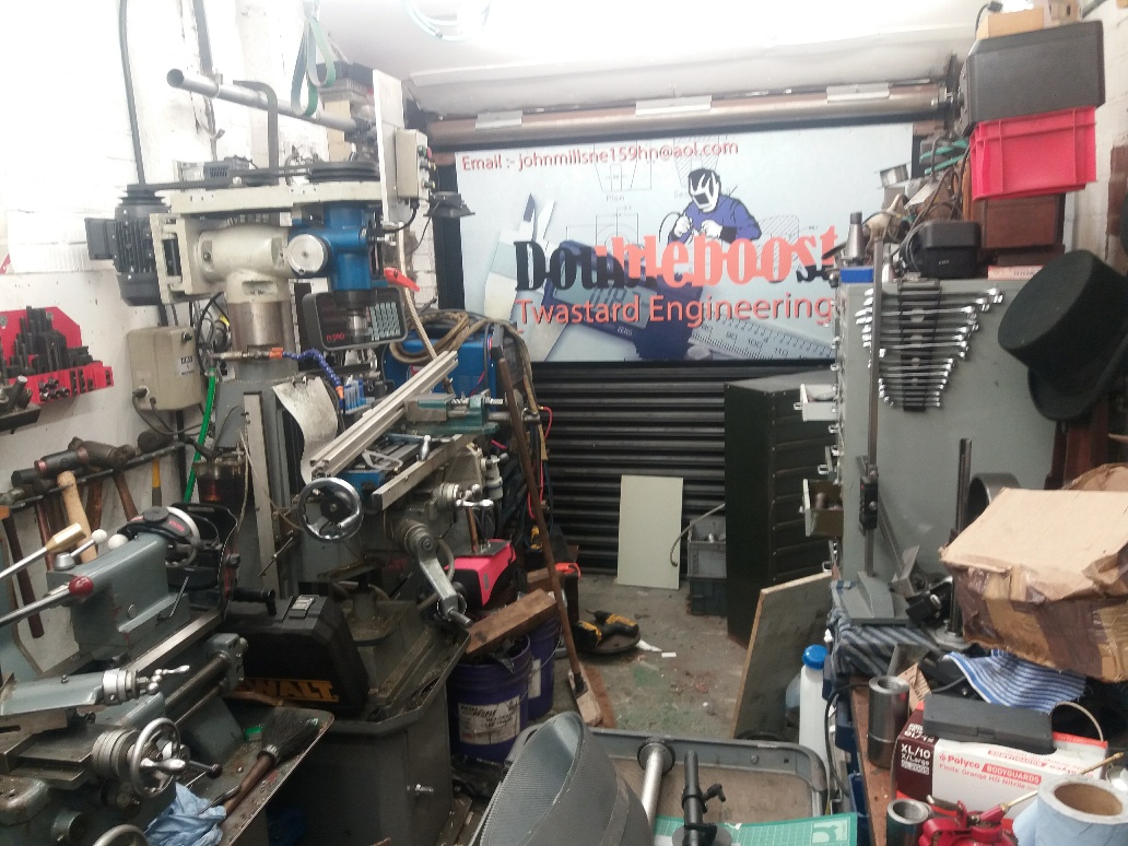

Aye, but from her post Mrs b will be working at one stage in a very small space.![]()

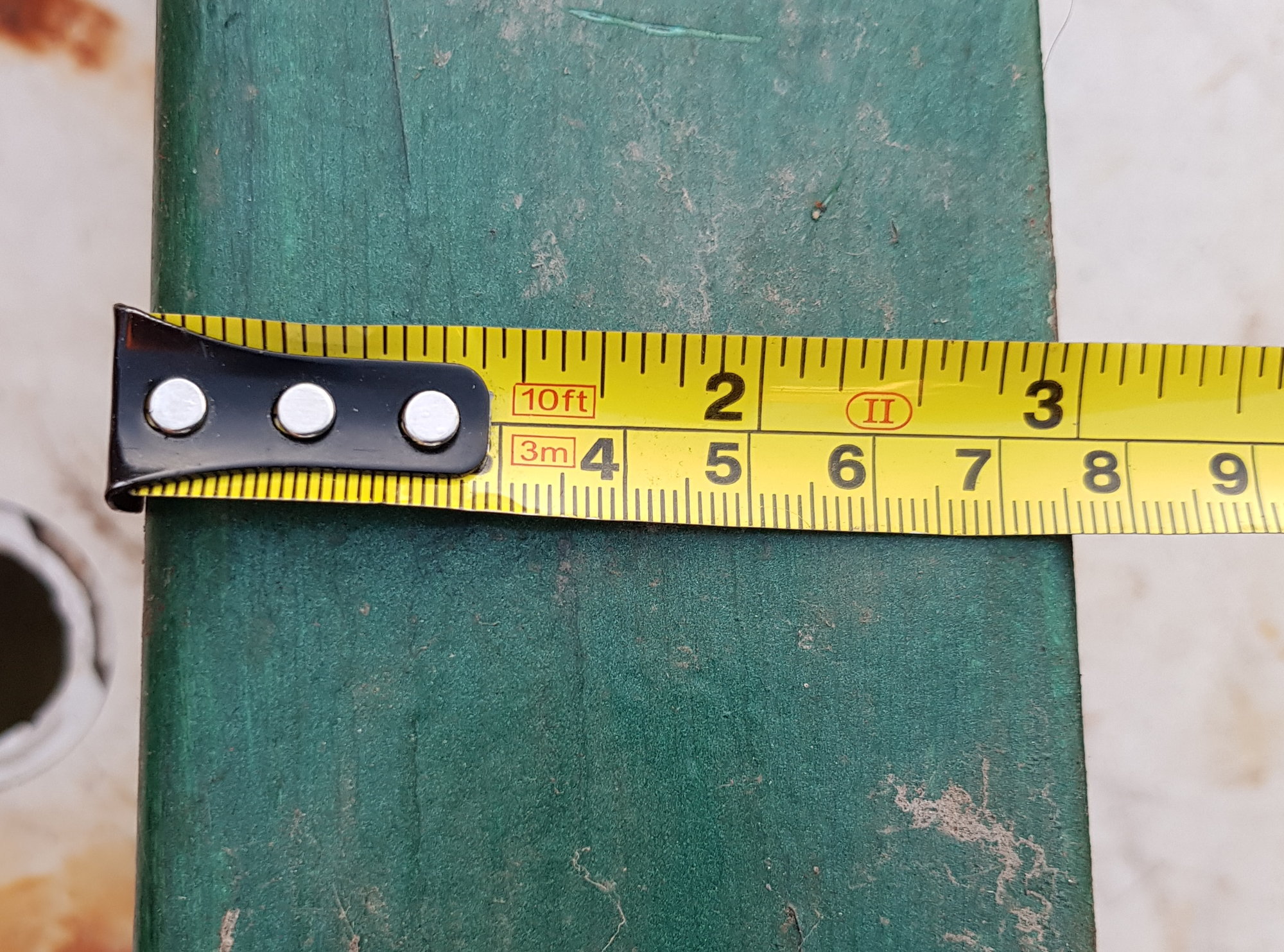

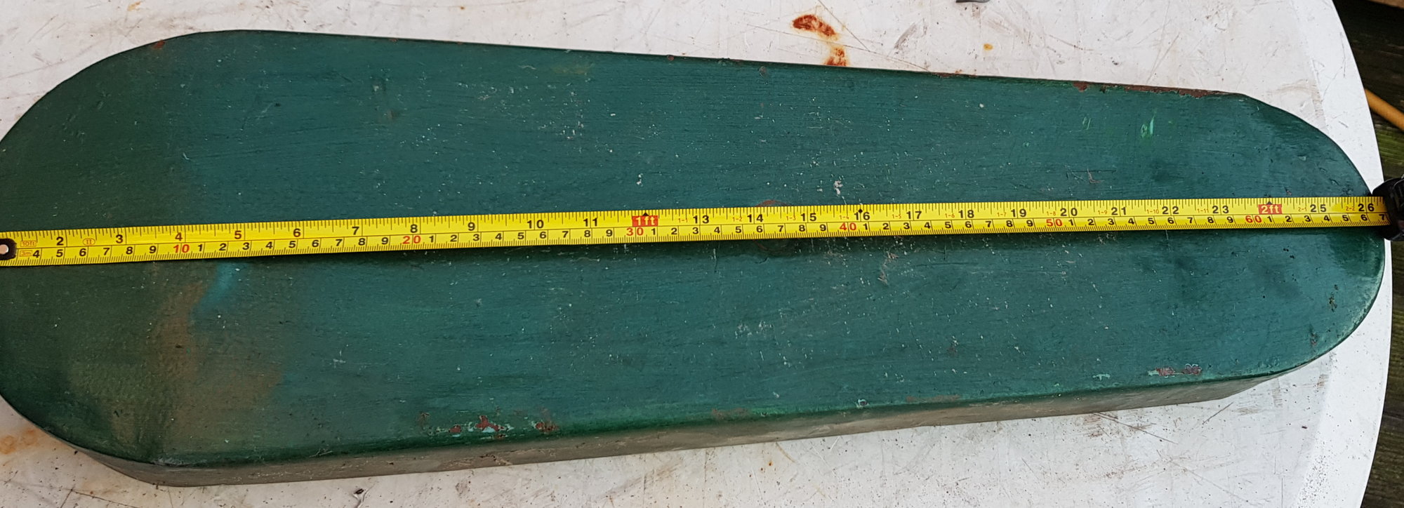

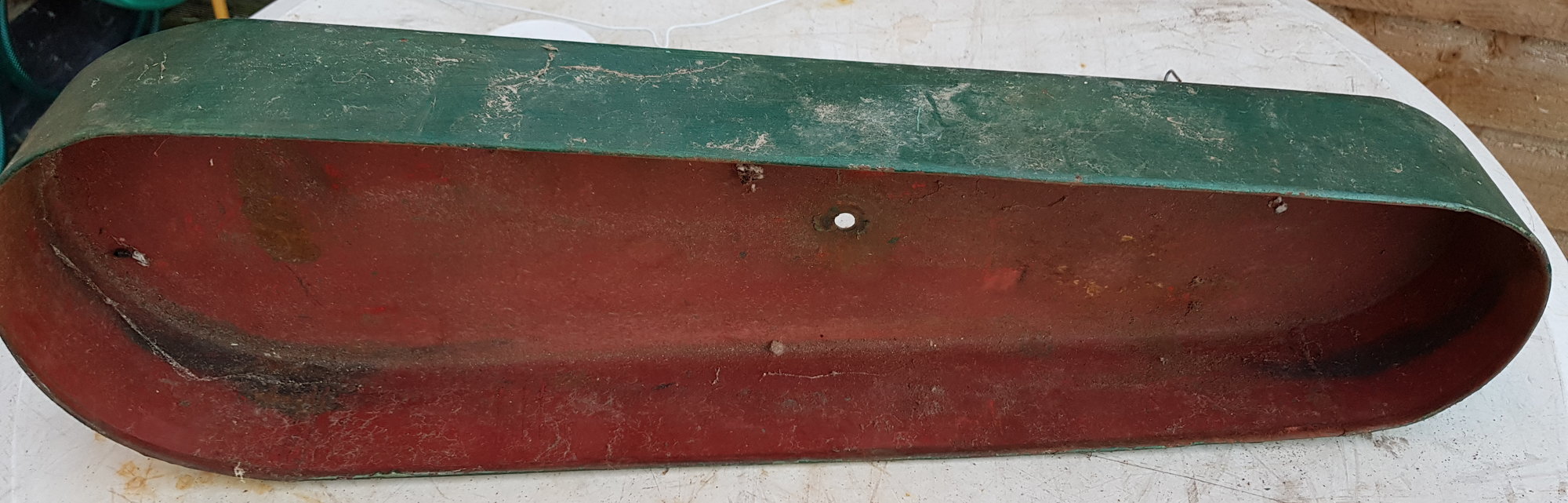

Thanks Seadog, pulley size is pretty much identical so think it is original. Started cleaning it up today, table came up quite nice. Will start a separate thread for its restoration. Thinking of getting a treadmill motor to power it, variable speed so can do metal and wood without changing pulleys.I couldn't get to the motor last night. It's under a ton of stuff, but here's some pictures of the belt cover. Let me know if you need more detailed measurements.
The pulley on the drive wheel is approximately 6 1/4" diameter. when I can get to the motor I'll measure that too, I think it may be the same.

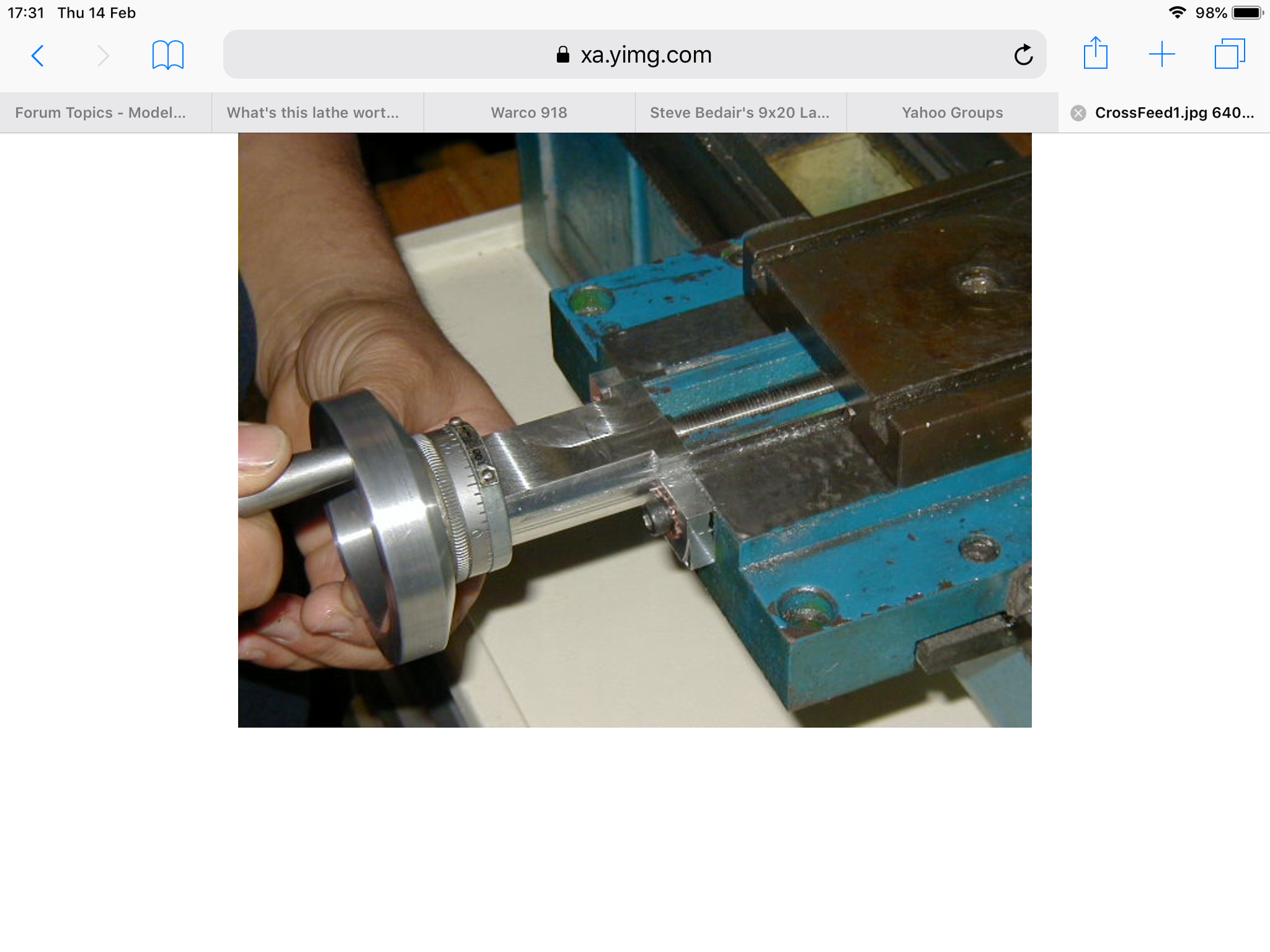

I have a picture from the interweb.

Weld up a 50mm equal angle iron dolly trolley and put it on 100 mm hard nylon locking castors . add some 150 mm U channels to take the legs of the stand & once the stand is correctly sited weld the channels in place you can then build the stand ( with shelves ?) , mount the bed on it and move it about with ease as you sort out the other bits of the lathe . Having it on a dolly has the advantage of being able to clean behind under or around it easily or find tiny bits that fall behind it when you're parting things off. It's also less problematic when repainting the workshop wall behind it matt white . As I'm 80 % disabled ...having my lathe on a dolly & stand has also allowed me to use a 2 ton chain hoist to lift the heavier bits on and off it when the dolly is put under the strongest beam in the garage . It also allows me to pull the lathe out to reset set the gibs on the carriage and slide easily as they are at the back of the lathe .

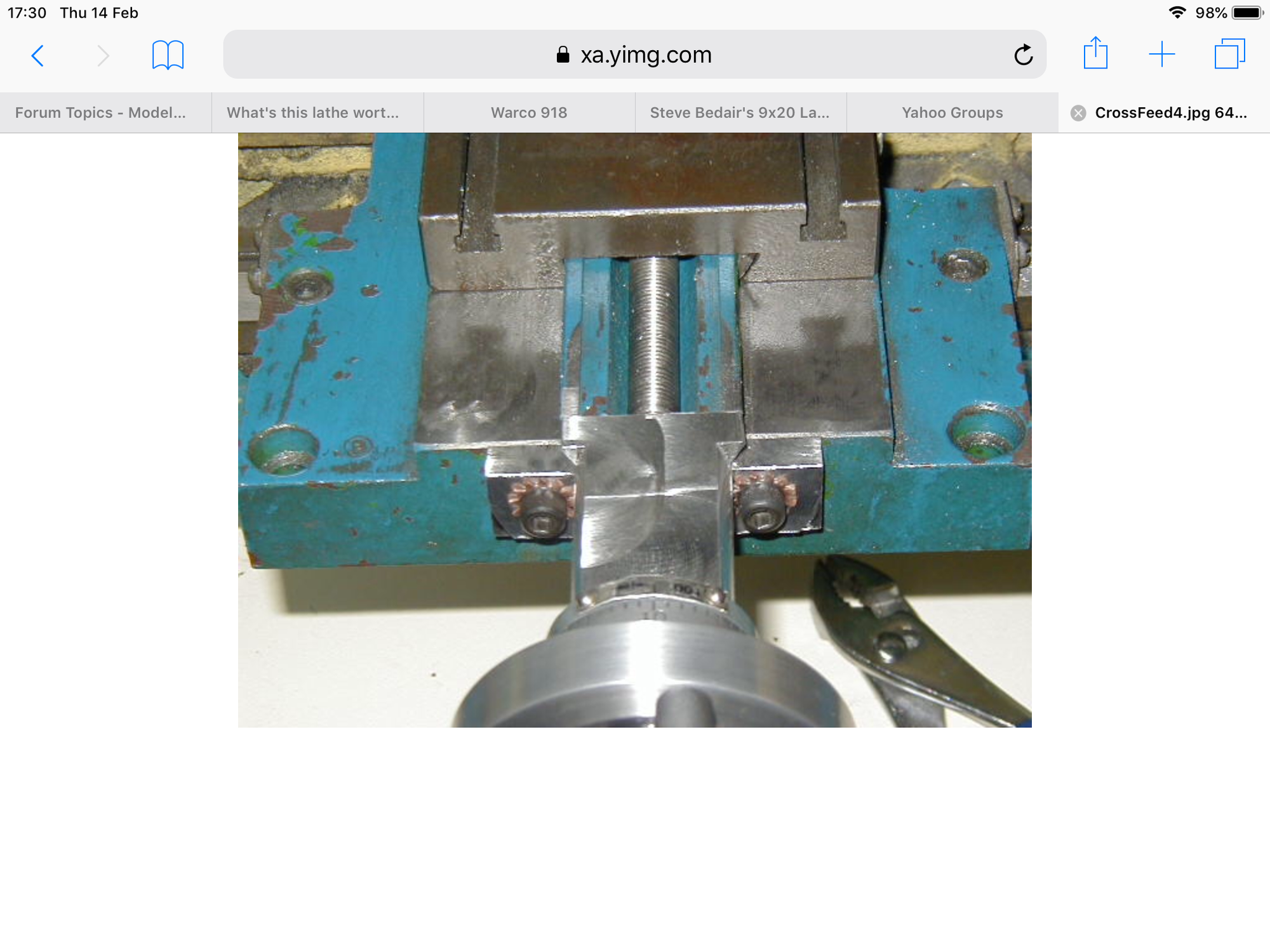

Is that a pic of the bit that’s missing?
Yes, although it might be someone’s home made replacement/upgrade in the picture, but yes, that’s the missing bracket.
Another view of the bracket (shiny T shape between handwheel and cross slide).
Because of having a bust up spine in two places & a wrecked left shoulder I've raised my cutting tip up another four inches by putting the lathe on the dolly .. now it's at a good height for me . I hope to be able to use the lathe well into old age 80yrs or so as it means I don't have to lean over or put my head downwards to work the lathe & I can bum sit on the edge of a tall stool & can get my toes under the lathe so I can stand just that bit nearer . Adding a times six back lit angle poise magnifying arm so the glass & light comes over the chuck area is also very advantageous , having an LED lit times 10 magnifying glass attached to the carriage to cover the tool tip might be even better ..That sounds an even better plan, but for the space I have, I might have to adapt it a bit, because once the table is in place, there is no room to move it about.
But...... If I make the table lower, then make dolly tray (with low profile locking wheels) to fit the lathe onto, that would allow the lathe to be moved about the table when stuff needs done, and the wheels can be locked or moved up(?) when it’s in use.

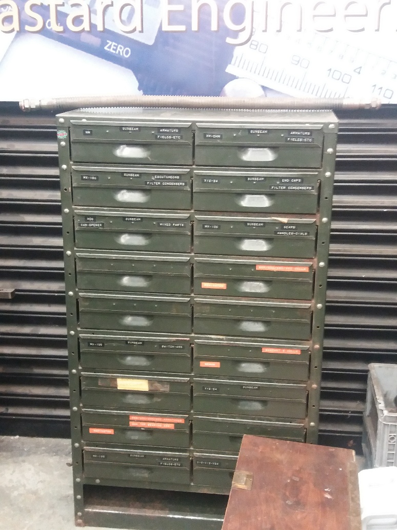

Oh how well I know that feeling. Everytime something new arrives its a complete reshuffle to make things fit.A customer called in to work before going to the tip
A double set of old metal draws
Then i started to move things around
Then it just got worse

It does have that home made look to it. No doubt to get some extra cross slide travel.
That’s almost identical to the repair that my lathe has. I got it from @Pete. a few years ago. He got it as a fixer upper and it too had very similar damage. He made a brilliant job of the repair, and I’m still chuffed to bits with it 2 or 3 years down the line!
I’ll get some pics done later and post them up. I MAY have the original damaged part so we can have a measure up and get some sizes for you.
