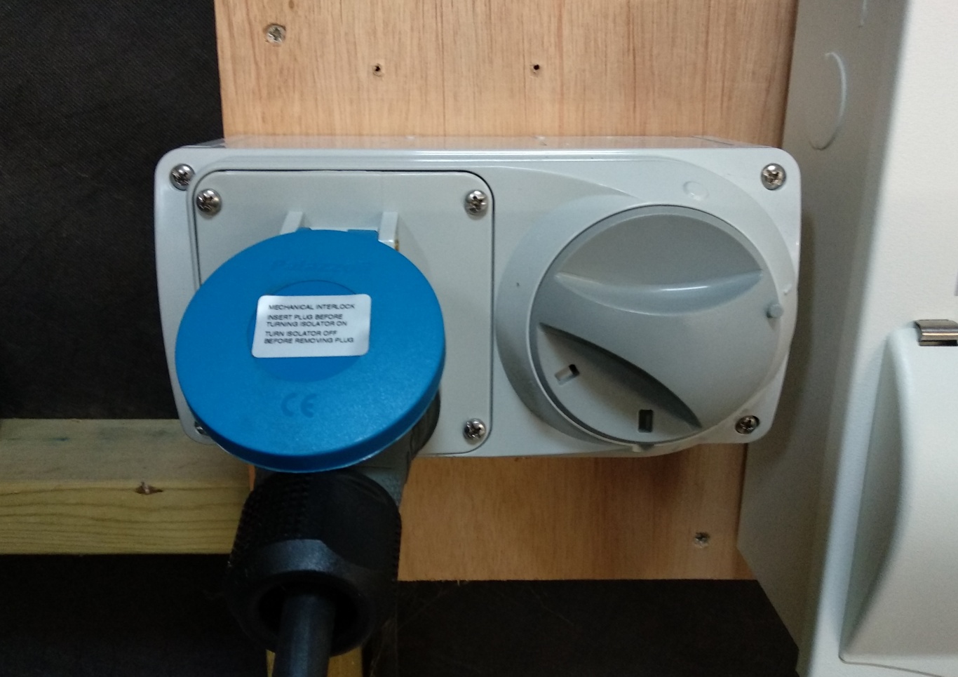

A 16A supply in the workshop so I can use the welder to, hopefully, its full potential. Project Management, as I affectionately refer to her, insisted that we get a qualified electrician in; I could have done it myself but better to be safe. He'd fitted a plug to the Parweld too, not that I anticipated that at all, and I'd bought one at Screwfix on the way home... lucky I had as he'd fitted a bigger 32A plug! I'll let him know and check it isn't on the invoice...
Oh, if anyone can make use of the old Wylex NHRS204/63 consumer unit let me know and you can have it for postage and a pint - has a Wylex 63A/30mA WRS63/2 RCD installed.
Do you need to use a specific plug for the socket to lock it in??
Yup - the 16A one. The 32A he'd fitted is physically larger, much larger diameter! He was a bit embarrassed when I emailed to let him know that he can swing by and pick up the 32A he'd fitted!
I've got a similar one in 32a any plug works you can't switch them on without a plug in and you can't remove the plug whilst its switched onWhat I mean is will it lock any 16A plug in or do they need to be the same make as the socket?
