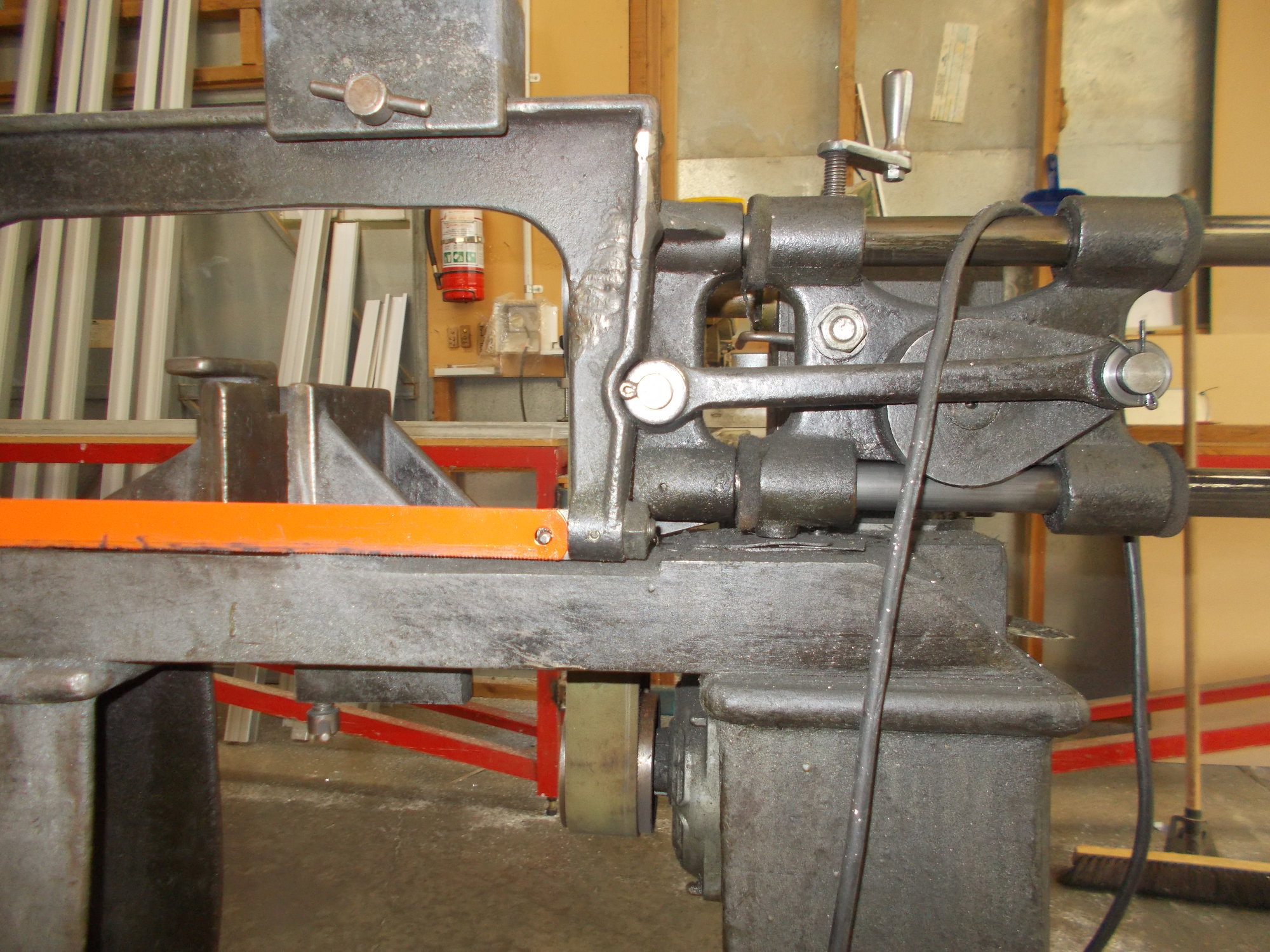

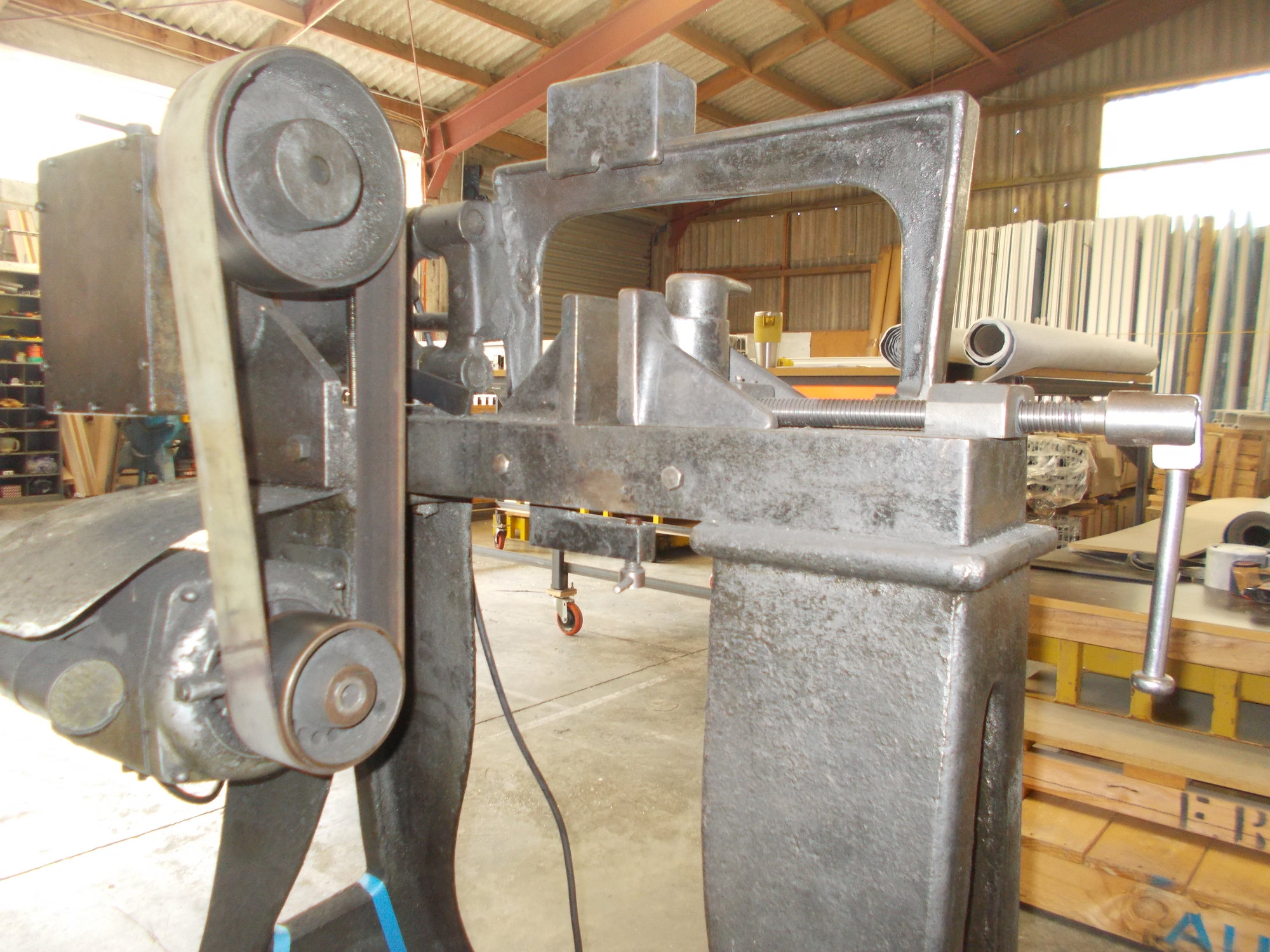

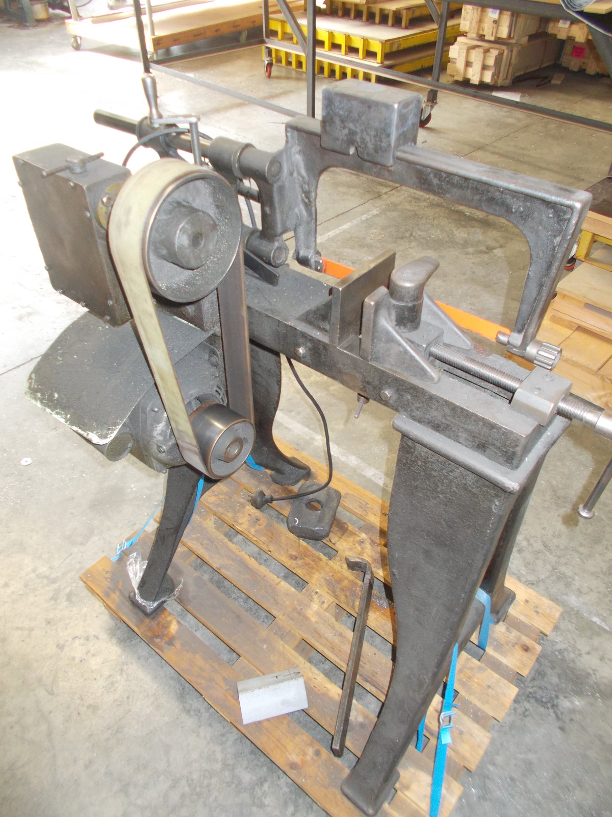

Picked up off Trade Me from a guy in Auckland. Going to take legs off and make a trolley for it. Cuts great just needs a bit of tweaking to get it to cut square, think a lot is getting feed rate right, also there is a grub screw missing from blade adjuster so blade might not be sitting square.
Here's mine on its trolley. If I use like that is does shimmy a little, but I've made a paddock stand type of thing to go under the back pair of castors. Works a treat.Better off just making a dolly or such for it to sit on, if you plan on moving it around. As mentioned though, wheels aren't a good thing with something like that unless you can retract them else lock them solid. Bolting the feet to a couple of lengths of wood, to make something like a sled, would be a more stable option whilst allowing it to be shifted fairly easily.
