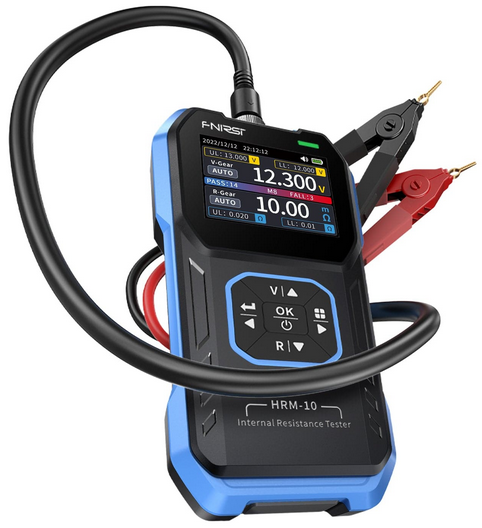

Thats sort of standard, resistance is tested by outputting a precise voltage and checking the current delivered tho batteries might be done by instead drawing a load.An FNIRSI HRM-10 battery voltage and internal resistance tester:
View attachment 513169View attachment 513173View attachment 513174

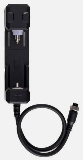

Very impressed, so far. The HRM-10 doesn't need battery voltage to be present between the leads to measure resistance, and it will measure just about anything; welding leads, car jump leads, Li-ion or alkaline cells, or the resistance of a length of silver steel, for example. Also ended up getting the "round connector testing probe" cylindrical cell tester, and the double probe test leads, to go with it.
seems they can die quite rapidly.
It's basically the classical four terminal low resistance measurement technique. This meter seems to work by injecting current at ~1kHz, using one terminal on each side of the Kelvin clips, and measuring the voltage waveform that occurs in response, using the second terminal on each side. The resulting resistance readings are surprisingly stable, and resolution is down to 10 microOhms. It was able to pick up a slightly loose clamping screw fault in a welding lead.Thats sort of standard, resistance is tested by outputting a precise voltage and checking the current delivered tho batteries might be done by instead drawing a load.
