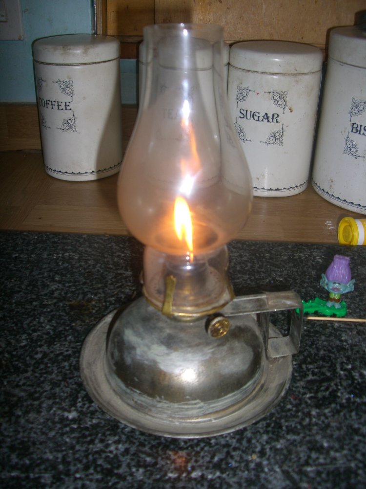

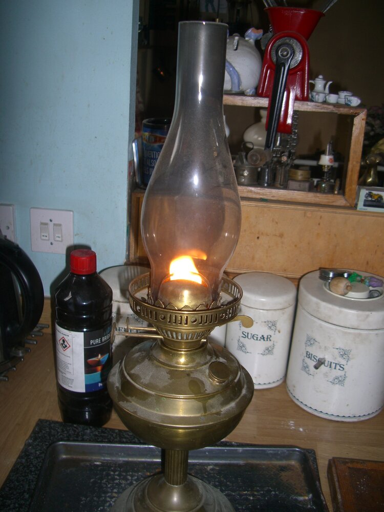

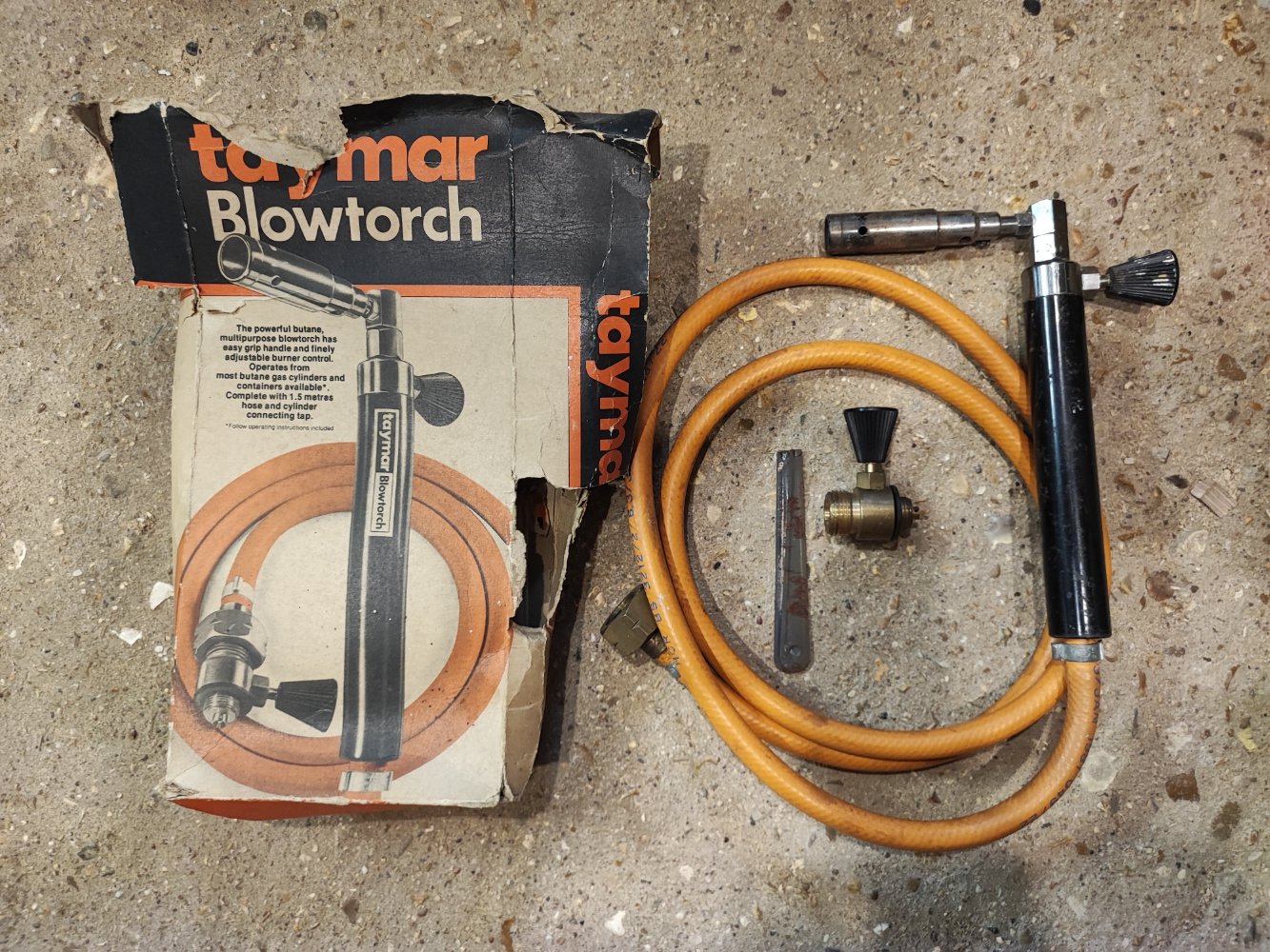

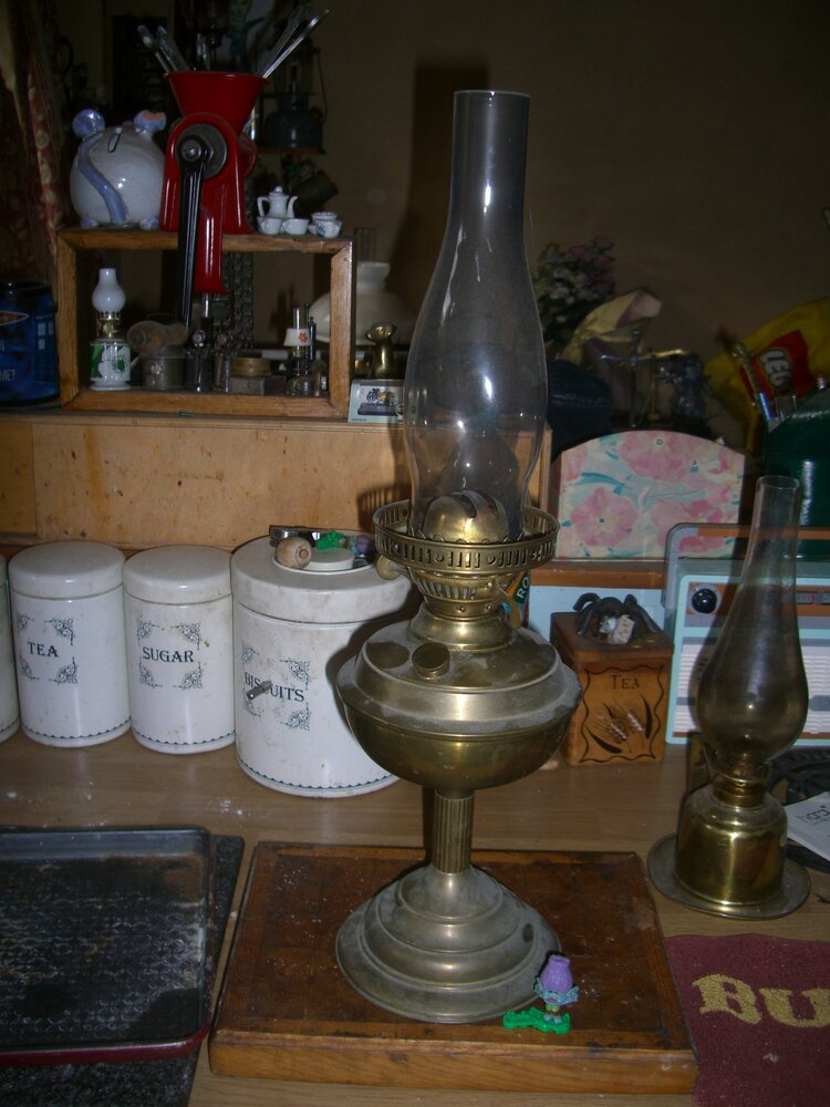

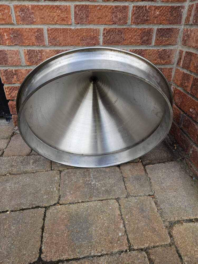

Got this yesterday, from a local charity shop.
Inspection showed that some one had spent a bit of money on it.
New wicks.
New glass
But what killed it?
They used the wrong fuel. so the wicks had gone hard, the wick gears were seized.
Cutting most of the old wicks off, soaking in meths had the gears free.
Fresh fuel.
