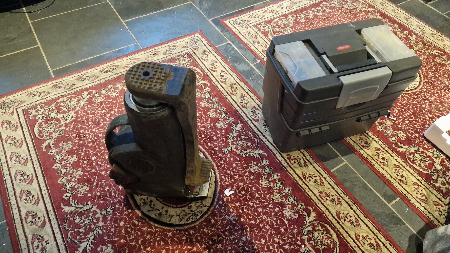

I live in Birmingham thanks to TangyesMy nice dainty little Tangye 25 ton jack
They go for silly money with the claw. I spotted one seller with the jack and one wirh the claw so got a bargain.
No idea it would be so huge though.
As I have lost so much weight my old ratchet toe jack won't lift my Holbrook H20 lathes without a very long handle.
This should be a breeze!

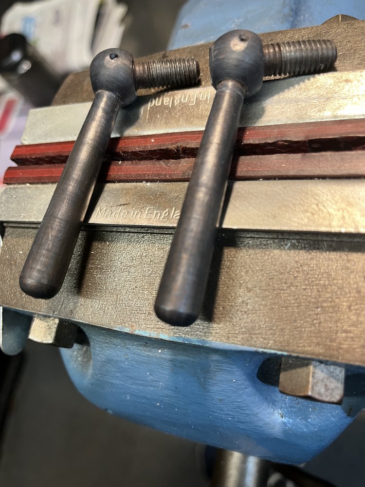

Gun blue paste (posted on here) which I'm looking forward to using on some mill parts and oddly...some guns![]()

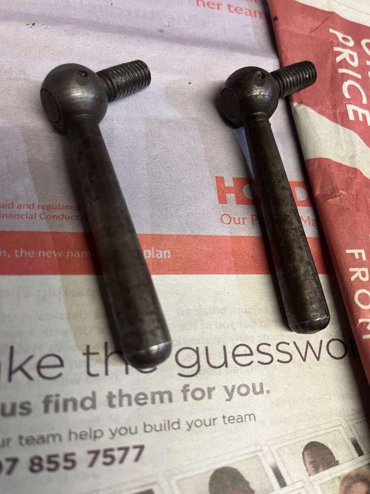

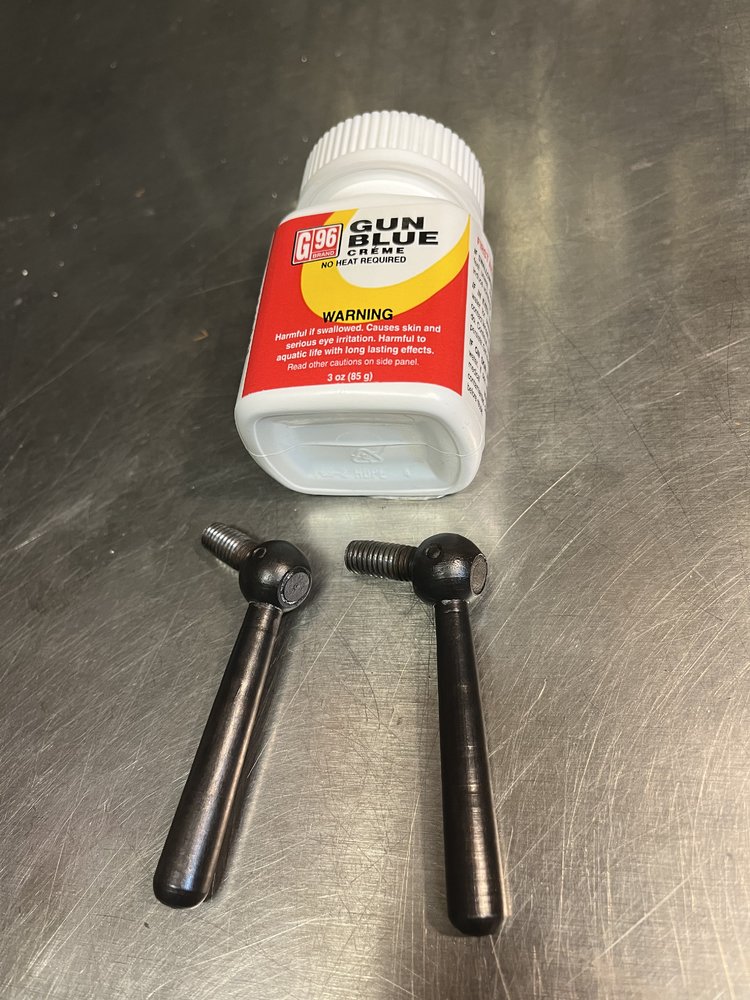

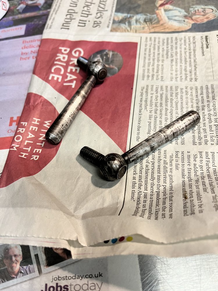

Looking goodGave this gun blue paste a quick go that @Pete. posted on.
Some test bits off my mini mill. They were originaly blue black, bit pitted and surface rust.
Prep could have been better...light emery, degrease etc
Followed instructions to letter, very quick process circa 30 secs, leaves a very dry finish once water nutralised and wiped off. The stuff clearly bites a finish.
Wax/oil finish - impressed.
And yet, this is a weak decorative coating that requires a constant bath of oil. Try rusty bluing.Gave this gun blue paste a quick go that @Pete. posted on.
